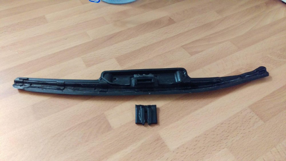

Not even 4 weeks old and already i have a issue with my door protector the wife exited the car as normal closed the door to a thud noise opened door to find black door protector snapped off in two pieces. Looked like protector didnt retract in time anyone else had this issue.

The exact same thing happened to me, 2 weeks after delivery from brand new! The dealer said that it must have been through misuse and want to charge me £250+ to repair it. I am not happy and I am currently arguing with them about it.
Given their only benefit is to protect other peoples cars, not your own, then if mine fall off they'll stay off.
£250+? Your dealers having a laugh.
Ultimately, that will be my choice too if I cant get anywhere with them replacing it under warranty but it does leave a sour taste in the mouth. I think the reason for the cost is because the part has snapped beyond the clip on bit. Before they saw it, the dealer said that they just clip on and I think they would have fixed it had that been the case. It was only when they saw where it had snapped that they pushed back. I can see the part of the mechanism that is still in the car and that does not move when the door is closed which makes me think that the mechanism behind the protector is broken which definitely should be covered by warranty in my view?

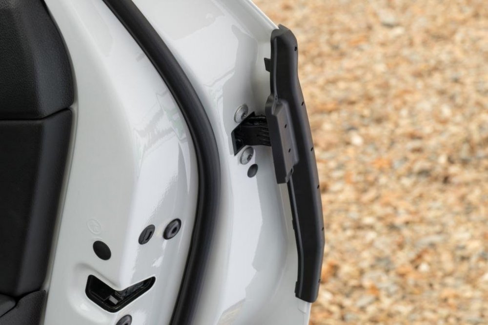

I saw a kid nearly lose a finger once on one of these. Tried to close the door by pushing on the protector and it retracted. Took a while to re-attach... (the finger).
I've noticed the same. An adult or older child will close the door by grabbing the vertical black gloss trim adjacent to the glazed area, or the exterior door handle.
The door protector is about level with the head of my 5 year old, so he holds the door right where the door protector is located.
If his fingers slip then they knock into the protector which has on occasion caused it to retract and twang back out as his fingers slip past. He hasn't yet trapped his fingers in it though.
I once shut the drivers door whilst bending over to pick something up I'd dropped on the floor, so my hand was lower than it usually would be, and I was able to nip a finger between the retracting door protector and the edge of the door. This was my mistake though, but does prove it is possible to accidentally trap your fingers in them.

I wonder if they get wet prior to retracting, and it freezes overnight, they can stick - and break?
It rained quite hard last night, and then froze overnight, the doors on our Kodiaq had frozen shut. The door protectors worked OK though.

I'd not thought of that potential consequence, if the edge protector breaks in such a way that it fails to retract properly, and is then caught in the shut-line as the door is closed, potentially damaging the bodywork, as it has on the Ford Focus thread above.
