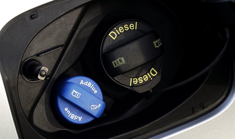

The AdBlue filler is behind the same flap as the fuel filler and most AdBlue containers include a nozzle to allow you to more easily pour the AdBlue into the tank without spillage.

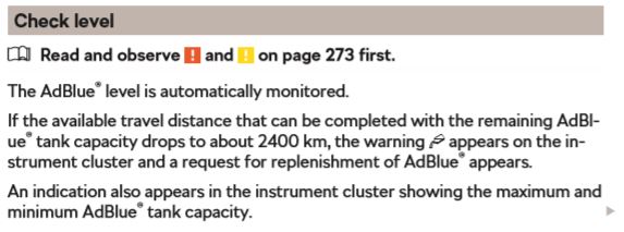

Much like the fuel tank there must be a system for monitoring the levels of AdBlue in the tank, perhaps this sensor is faulty?
I have seen complaints where the system has registered low AdBlue and then owners have topped them up, only to overfill because of a malfunction in the actual amount shown in the tank in the first place, or topped up and still shown low even after the 30sec wait so they think they haven’t put enough in and they overfill. I wondered if this is still a problem.
You’ll never overfill if you wait till it’s empty. The whole bottle goes in no problem then range reads a very big number.
