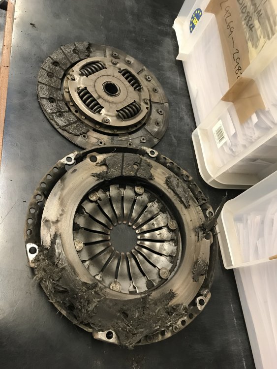

My friends Ex demo fabia with 5000 miles has suffered clutch failure initially the clutch pedal was floppy and couldn’t change gear when leaving the filling station. AA drove the car to the dealers about 6 miles away. Any suggestions as to cause, the garage say it’s due to regularly slipping the clutch when driving but the damage doesn’t seem consistent with that.

@JJ2 - Well, 5_000 miles is way too soon for clutch damage other than due to systematic abuse. What was the mileage when your friend bought the car? Like rum4mo I'd agree that the most likely cause is the car being abused as a demonstrator.
Thanks most of the miles done as a demonstrator but clutch lining doesn’t seem to show that sort of ware more ripped to shreds with thick chunks missing
Same thing happened to me when I've accidentally dropped from 5th to 1st before roundabout. Clutch exploded and bits stuck to pressure plate...

@JJ2 - Well IMO that's either overheating or a manufacturing defect. I'd actually incline to the manufacturing defect because there's no sign of blueing on the flywheel.
Thanks that’s my feeling too
Well that is not a very pretty picture!

So, 13 years on the workshop floor of main dealers would say to me that was a manufacturing defect.
1. When a clutch over heats, usually the friction material turns to “fibre dust”.
2. You can clearly see the friction material (from experience) is not excessively worn, like you would get with excessive clutch slip.
3. The friction material has only broken off on one side of the friction plate.
4. The pressure plate and friction plate has no signs of excessive overheating.
I would say the friction material has separated from the pressure plate due to the friction material being defective or the riveting of the friction material to the pressure plate was insufficient.
I have seen what happens when a wrong gear is selected, usually the spring fingers (not visible in pictures provided by OP), fail causing catastrophic pressure plate failure contributing to damage to gearbox casings etc.
The dealer/Skoda needs to provide solid evidence to now prove that it was Driver error (which it doesn’t look like it was to me).
The picture does not show the flywheel, just the pressure plate and the centre plate, but I do agree that there is no evidence of overheating.
Certainly the centre plate has let go as a result of a high force/demand incident.
The dealer / skoda are going to sight changing down without increasing engine revs to compensate/match the new situation.
I have seen this many times over many years - the centre plate is suddenly subjected to a high force in reverse to its usual directional function. The condition of the clutch plate supports the theory that the car has gone from a high gear to a low gear suddenly - and without increased revs to compensate for this change.
The motion and weight of the car through the drive train has imposed the whole sudden force trying to speed up the engine. I think they will argue the case accordingly.
What we dont know is if the car was 'abused' during its demonstrator days by a bad driving technique by all who used it. (This would be near impossible to prove)
If you keep up with VW group nuances, I believe(?)  that there was reported evidence that a certain brand of clutch plate were prone to failure, but I cannot remember where I saw that report.
