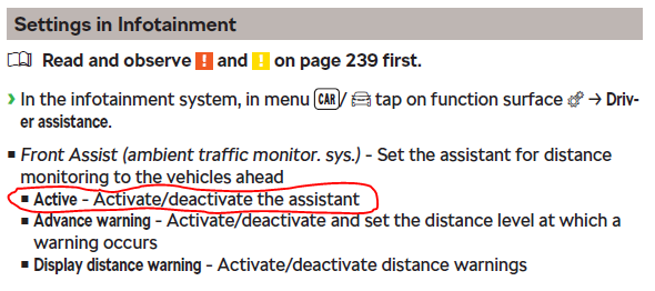

You could turn off the front sensor in my Octavia in the car stup menu under driver assist

Has this feature been made to be selectable on the Karoq since 2019, I am just about to take delivery of a Scout and wasn’t aware it was permanent
Front Assist is standard on all (UK spec) Karoq's.
You can't turn it off.
I seem to recall seeing an option to disable 'front assist' in the menu?
Lane Assist perhaps?
Front Assist can be desensitised, but not turned off completely.
EDIT: Nope, I'm wrong...
Edited by silver1011
