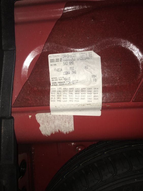

The link says that there has been no relevant recall for my vin number and this is the sticker in my spare tyre well
A sticker removed though. Just where a Service Campaign Sticker might be put by a technician.
Looks like the Build sticker was moved.
Best ask Skoda UK if it was done.  Or do you have a Service Book, it should be in there.
http://skoda.co.uk/about-us/recall-actions
No nothing in service book and is fully stamped from Skoda garages too
