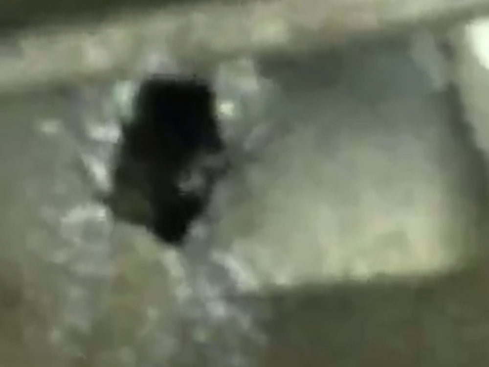

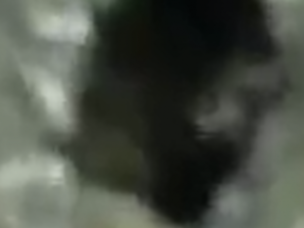

I was driving on the M1 motorway near Derby towing my caravan at about 50 MPH a week ago when suddenly there was a loud “whirring grinding” noise, which then stopped. I thought it was a puncture and the alloy wheel grinding on the road. We stopped as soon as we could, but could see nothing wrong. As the trucks were thundering past, and it was not safe to stay there, we drove on. After a minute there was a louder grinding noise, followed by a jerk of the car (as if the back wheels had stopped) and a thud, and then quiet again. We exited the motorway ASAP and found oil pouring out from the rear differential area. We had the car transported to nearest Skoda dealer in Derby, and they found the differential has a large hole in it, with an estimated repair cost of £4500. The car is just under 4 years old, so out of warrantee. Hopefully the video showing the failed differential will work.
https://video.citnow.com/vtw8Zjz6W24
So my questions are : (1) Has this happened to anyone else? (2) The garage says it cannot tell if the differential was damaged by an internal or external problem (i.e., that I hit something – which I did not). Should it be easy to tell the difference? (3) Do you think I would be entitled to a goodwill contribution from Skoda UK for such a problem for a car of this age?

Certainly worth asking Skoda for a contribution if failure was internal and difficult to think of anything that would do that damage externally. Talk to the dealer.
Regarding the hole, without seeing it, I assume you mean the casing.  Do you mean like a piece has been punched in or out.  Only likely to be from within if there is part of the workings missing, such as a cog that shattered and flung itself through the case.   Only a proper metallurgical exam of the parts will determine what happened

The damage/hole appears to be folding inwards?   Surely if something ruptured internally that the metal around the hold would be pointing outwards?

Amazing how marksmen manage to shoot out the rear diff with such accuracy.  Or it always seems be about the same position that item on the road and hitting the diff manages to puncture.
If the commentary is correct and you've not had the haldex system serviced as per the schedule at a skoda main agent then I doubt Skoda will contribute anything to the hefty bill.
Good luck
Agreed, that looks like something has been thrown up from the road and punctured the casing. Possibly something as small as a wheel nut.

The independent Engineer will see if the casing is broken from inside out or one of these wheel nuts that made direct hits on the diff after a service.
