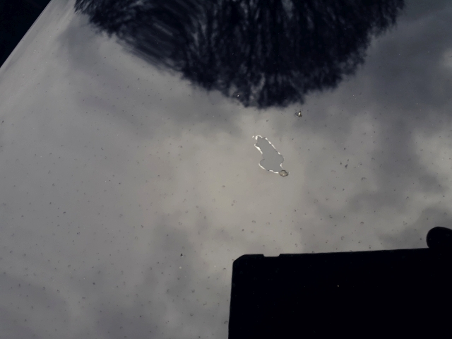

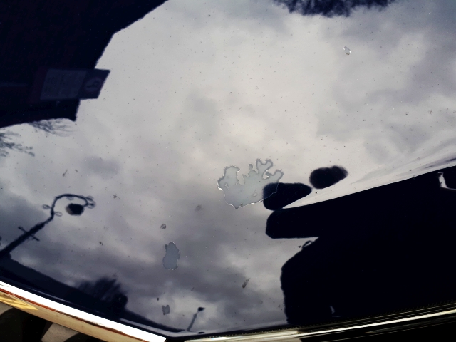

paint clear coat peeling or flaking off ?
Dealer  says these are stone chips ,  but  they  seem to be appearing even with a stone chip  cover on the bonnet
the clear coat seems to be peeling / flaking off ?
has any one seen this before ?    2.5 year old car.
regards and thanks

they are insisting  its stone chips  but i'm  no way convinced it is ..
Sorry on a phone and losing connection.   I was a spray painter and seen that plenty over the years.  But as bad as that was ford's back in the 1970' s
aye ,  but what is it ?
bad  clear coat ?    to thin ?
As bad lacquered top coat as VW managed lots about 2004 2005.   Full respray required.or they can replace the car.
On a PC now.
Get Skoda Ireland to arrange the full inspection, testing.
I expect first they will say 'Fall out', then Not Factory Finish / Repaired / Resprayed,  but the testing will show the Factory / Quality Control fault.
Fully agree with AwaoffSki. That's bad clearcoat or bad prep at the factory of moisture in the robot guns that sprayed it. It's definitely NOT stone chips! It may also be the clearcoat has been applied too thin leaving it vulnerable to peeling off with the slightest touch. They can test for that too but they will need a factory rep to do that most likely as if the bodyshop does the test Skoda won't believe them.

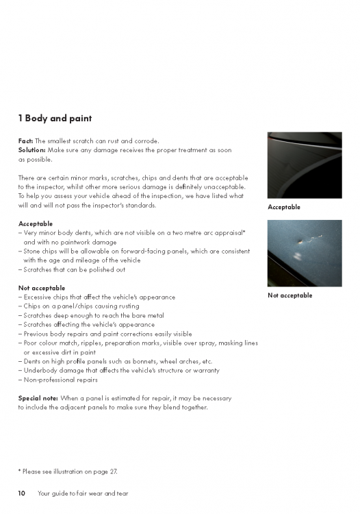

http://skoda.ie/owners/body-and-paint
Hotline number foot of the page.

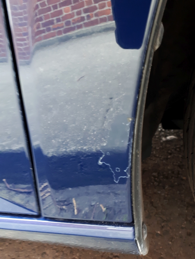

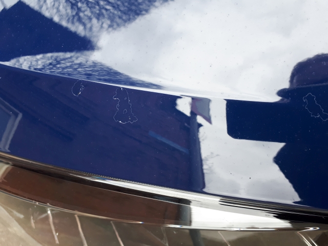

the car has these patches on the bonnet ,  side of front wheel arch,  rear near petrol cap  / rear door area
ive had it since new -  its on a pcp  2.5 years old .
it is parked in  in front drive on a medium busy street beside the wifes audi  and the neighbours ford,  both have no issues like mine
and its parked in work in basement car park .
so no dodgy environment around it.

thanks for the advice -  have done this today -   been so busy the last year  i just assumed they knew what they were talking about re stone chips and carried on   ,  but i put a bonnet cover on it while driving and it still got worse  .   its obviously not stone chips -  its dodgy paint .
12 hours ago, Dithane said:
get some stones the same diameter / size and chuck them against showroom cars and point out that it is IMPOSSIBLE to create stone chips that size, unless you went through a meteor shower
thanks,    but they said it would have been a tiny chip that grew due to weathering ,    I thought that made sense at the time , but  i had  a 14 year old audi that had no issues ,  and  wifes audi has no issues ,  driving the exact same roads.        i note there was a similar issue with toyota yaris  ,  so it looks like a paint problem  .

what can happen is the chemicals have not mixed right when industrial spraying / laquering. 1 of the components if 2 part mix will run out so wont mix, or wrong drying time or some other factory Quality Control issue & it wont be on every panel on every car, Just on some  for a short while when the fault has occured, until someone realises there mistake, another shift etc...but the parts have left the factory... etc... no need for recall, or plant to shut down.
Dealers hide away from 1  in 1000 anomaly issues and bad luck to get one. Ie no one else has this issue, never heard of that one before, blah blah..
