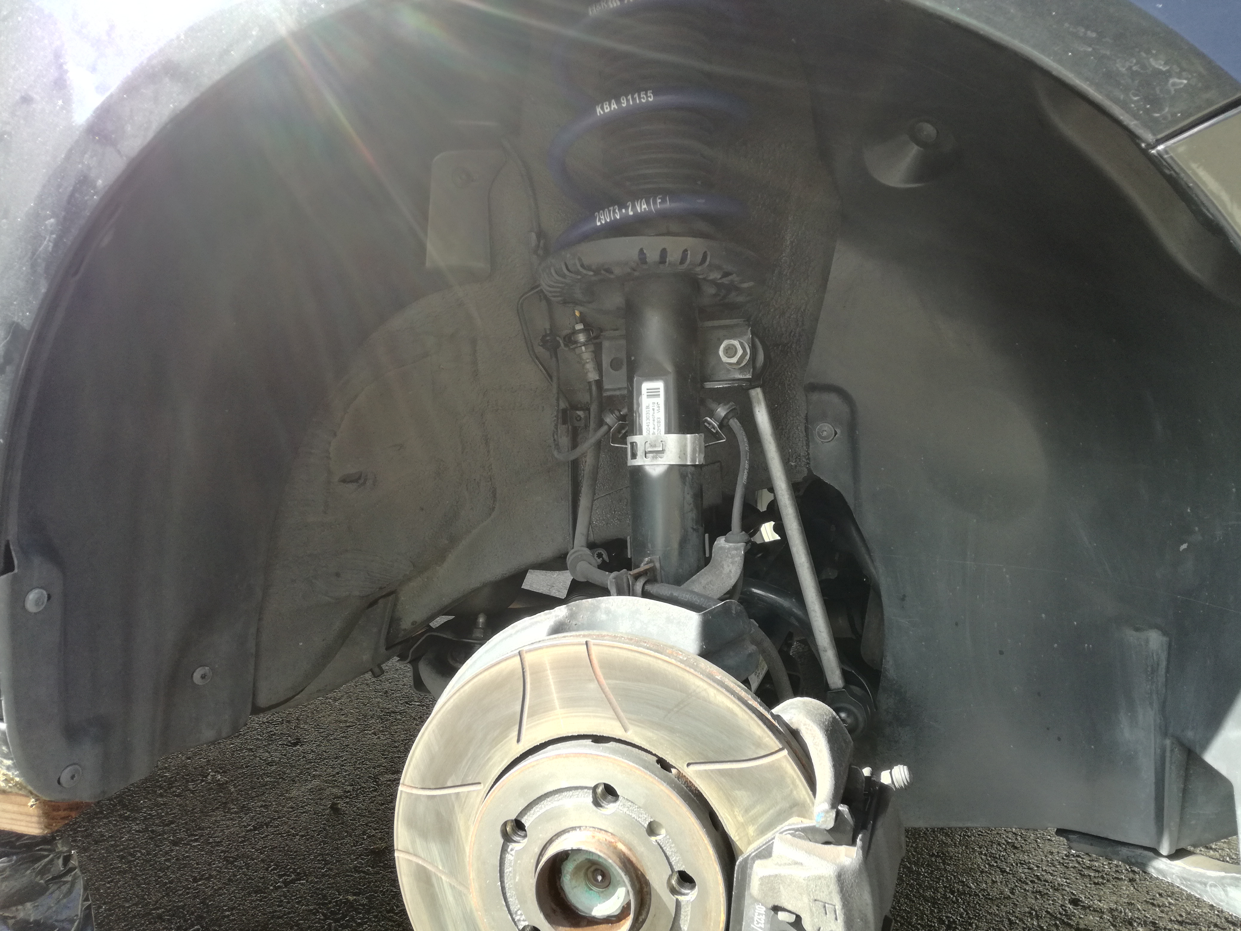

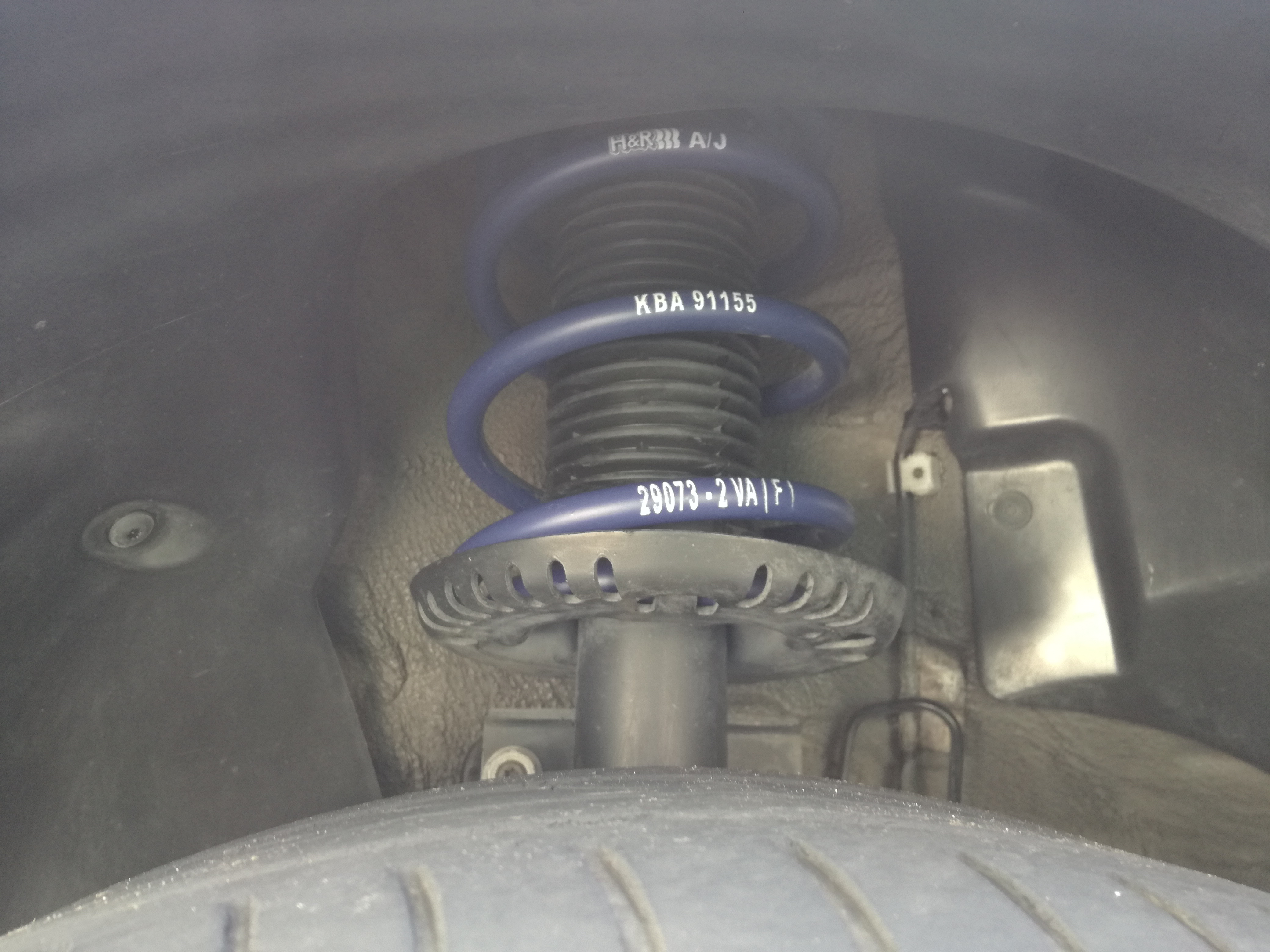

I just had the H&R springs delivered. So I have jacked up the front end. Just dont want to do more work than I have too. Does the big torque bolt come out from the base... sway bar link off? Will the CV joint lower down ... and fall into a million pieces when I do this?
Just a basic how too.

Do i have to remove the 3 nuts at the bottom control arm? Do i need to remove both nuts on the sway bar linkage... top and bottom one?
TIA
Edited by Trintron
I found that link earlier. Talks in riddles. Haha. Wish they would use english. Lol
My real issue is getting the sway bar linkage off / out. Is the whole linkage coming off? Or is the only the top one  coming out/off. If so.. how does it come off? Its under tension!!
  Strut bolt is out... tie rod end is off.

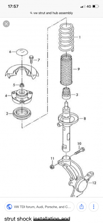

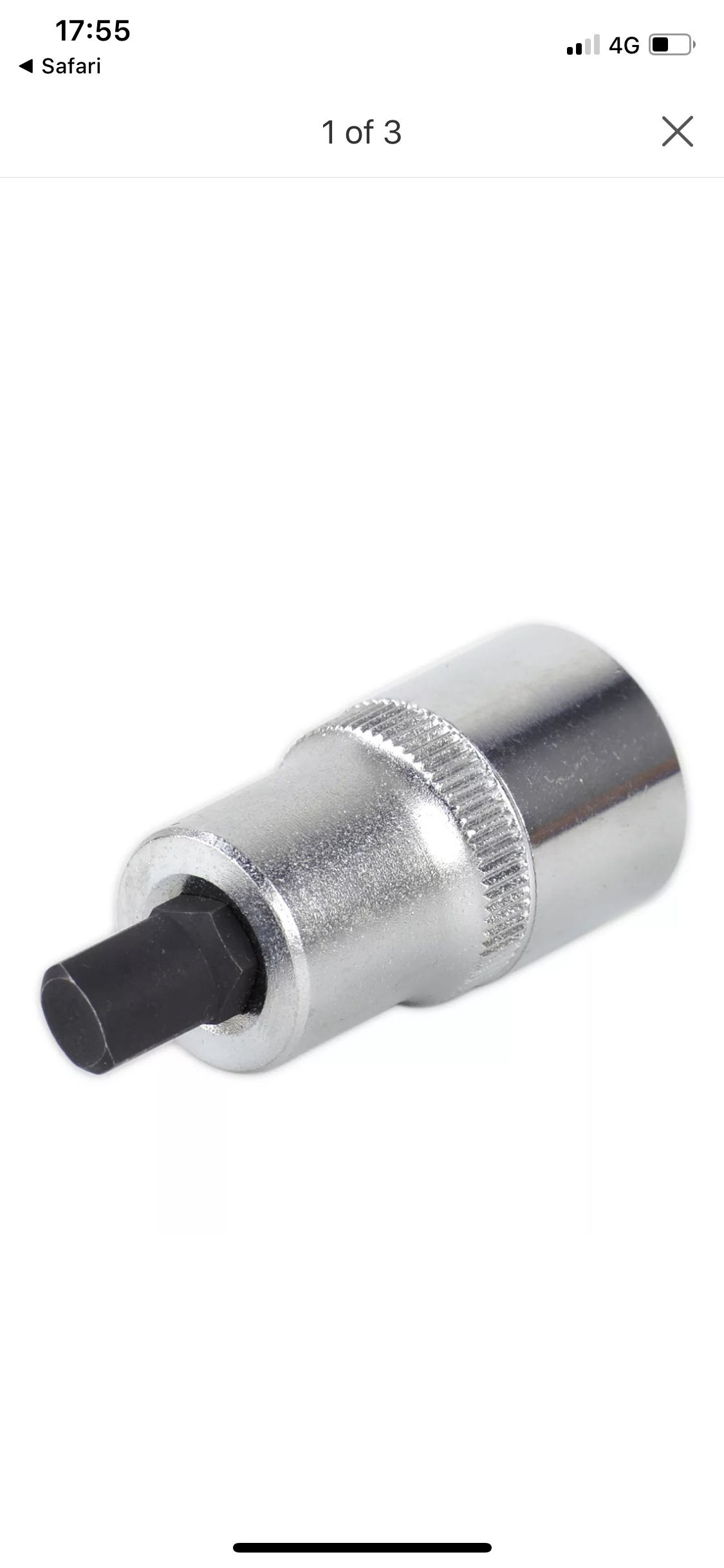

All you have to do is undo the drop links, then the spline drive bolt and nut that holds the strut in the hub assembly. Separate the hub assembly with the separator tool and jack up the strut from the bottom and the whole strut will come out. No need to remove arb or drive shafts.
Does that make sense
Similar to this
Undo 10-11 then put the separator in the split in the hub where but goes through then jack the strut out of the hub assembly

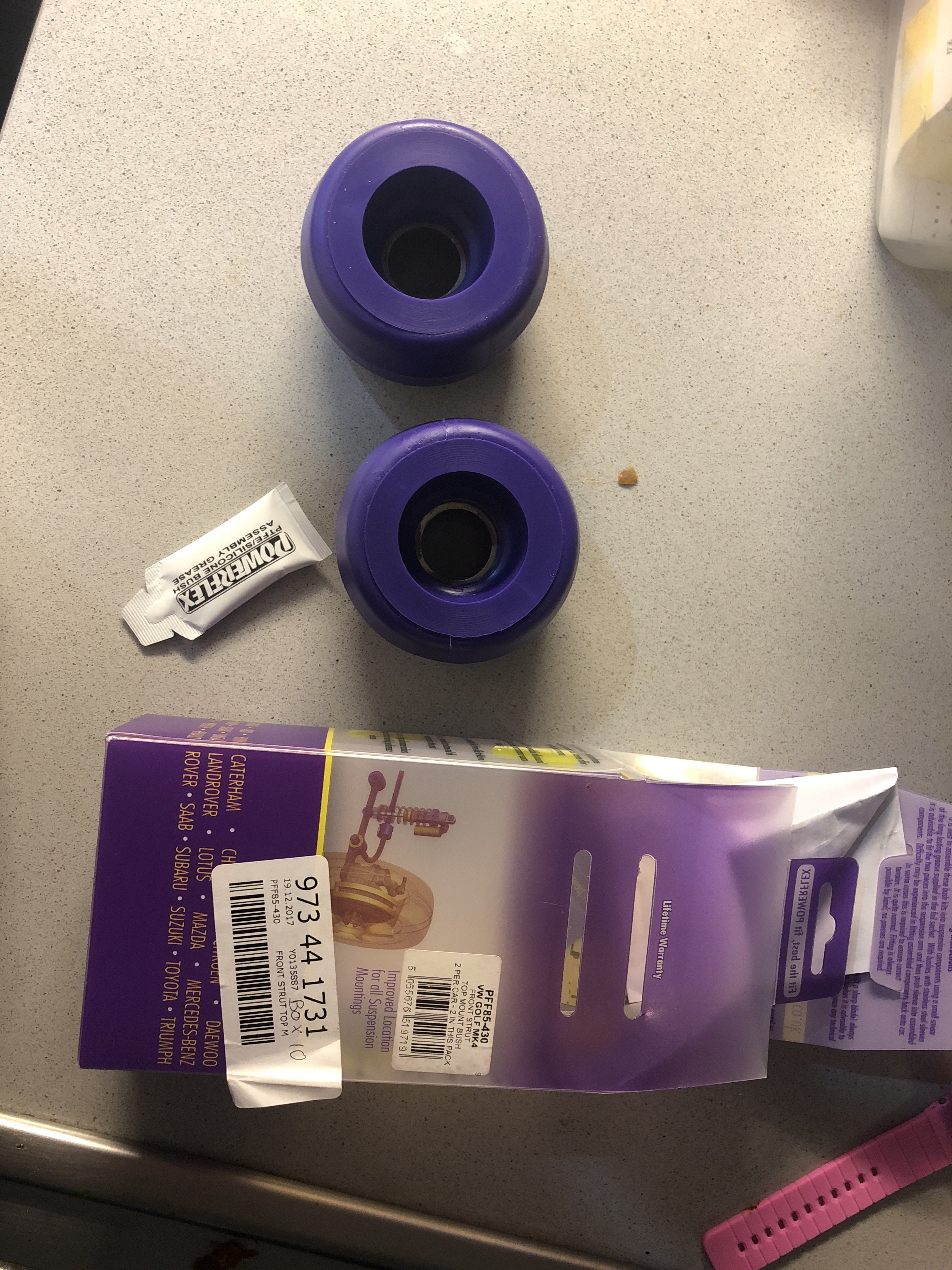

then when it’s off you need spring compressors etc to get the top bearing assembly off.. I also have these brand new poly Bush top mounts for sale. Might as well fit them when you do springs ;-)
