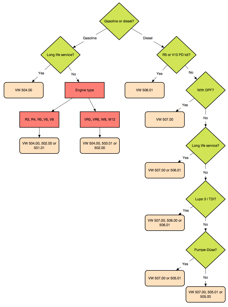

This is a good one that a member posted in a thread on VW508 / 509 oil.
(The nice new VW servicing expense to lower emissions and have better fuel consumption results.)
that is interesting...so many grades
i looked my fabia 1.4Tdi PD on opie oils and got this one...5W/30 synthetic
Skoda Fabia Hatchback 1.4 TDI - Fitment/Product Details:
A high performance fully synthetic petrol and diesel engine oil suitable for petrol and diesel engines.
APPLICATION: Suitable for use in petrol and diesel engines meeting the latest European emissions standards, with or without diesel particulate filters. For use in 504 507 applications in vehicles in and out of warranty.
mine doesnt have dpf..so i am told..
i will check at the garage what oil they will use...probably same as last year
thanks for the chart
cheers
geof

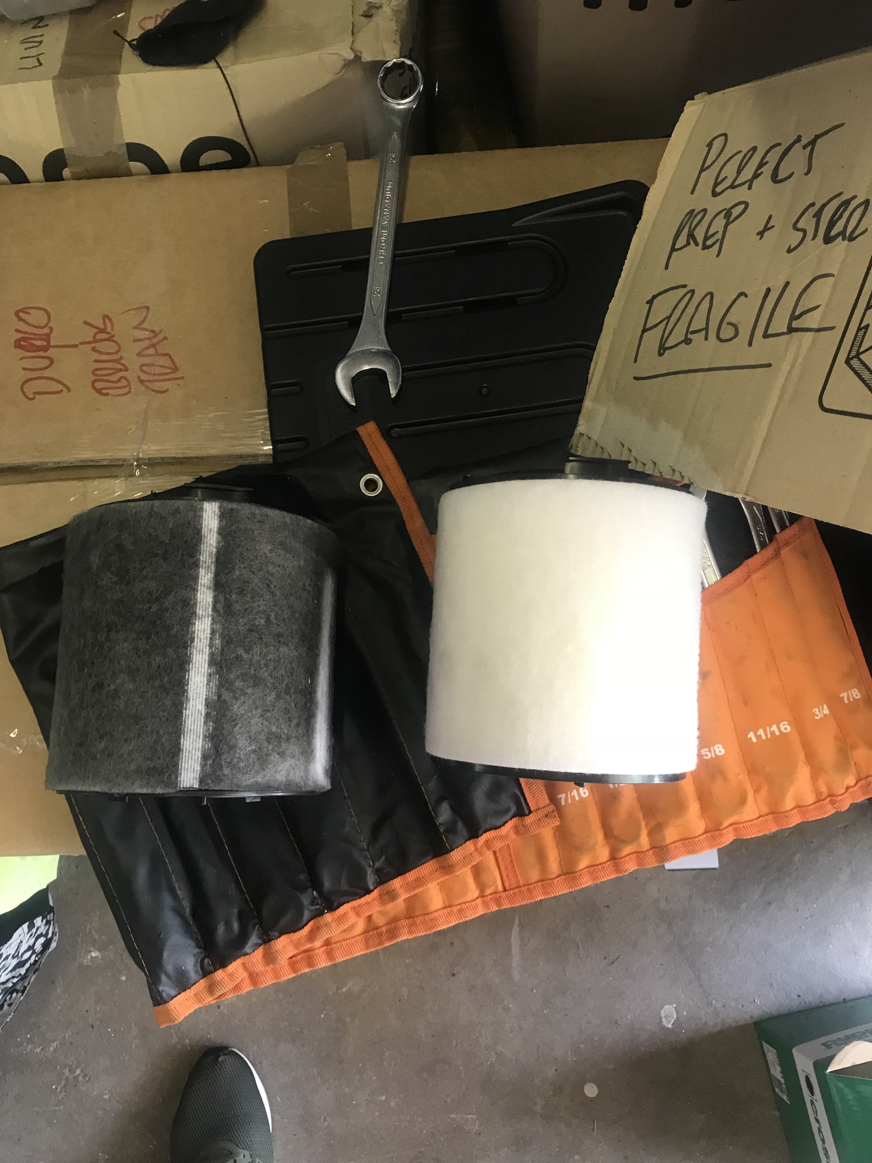

Just done a service at 50k.
parts; £88
4 litres of Castrol edge 5w30
air filter
oil filter
sump plug
4x NGK spark plugs.
90 minutes work and job done.
According to the service book, 6k sine last service (minor), have a look at the air filter!!
