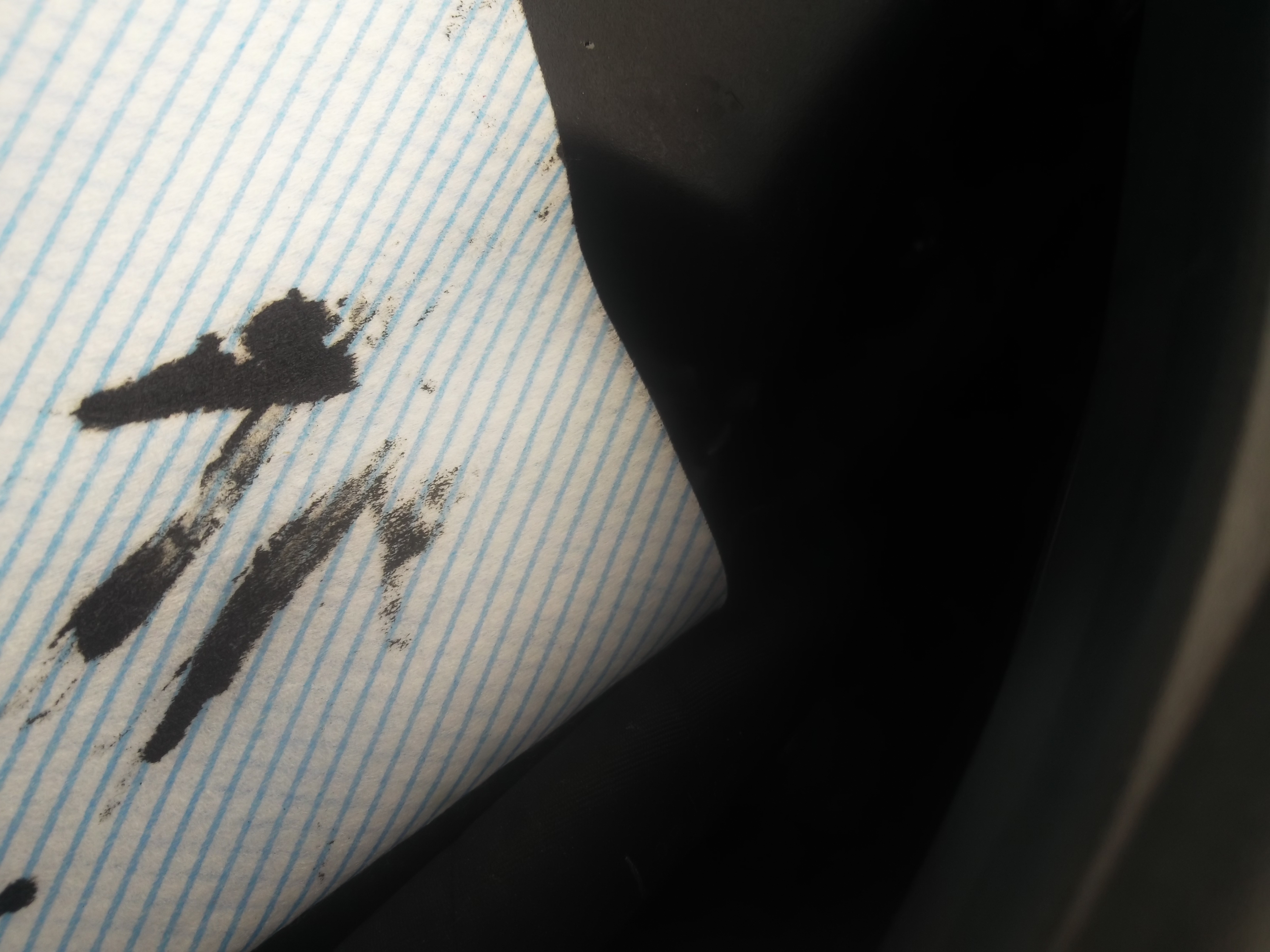

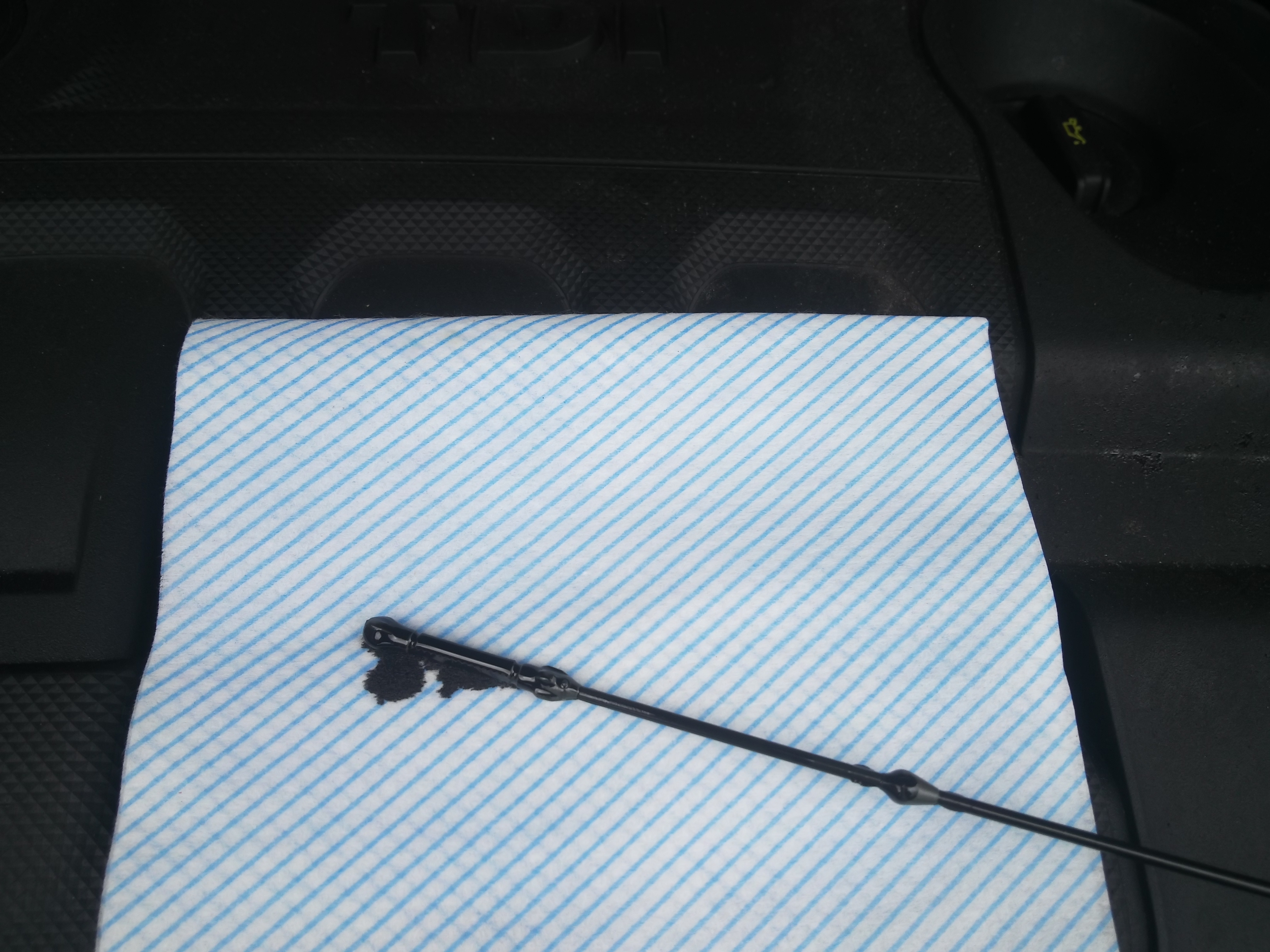

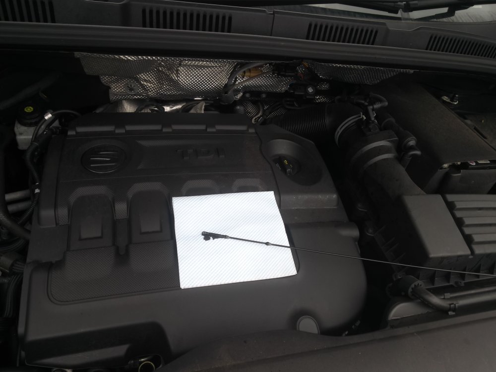

If it is a car you are keeping, I would be changing the oil lot more frequently than 18-20k miles  (look at the dipstick, if the oil no longer looks ok (new oil is golden and viscous.  But if your oil is black, looks thick and lumpy or like treacle, then needs changing regardless of what the computer guesses)
2.0TDI Euro 6 oil does not look golden even after 1,000 miles of an oil and filter change IME.
This is what you might see after 18,000 miles & 18 months and having had 4 litres of oil topping up over that time.
