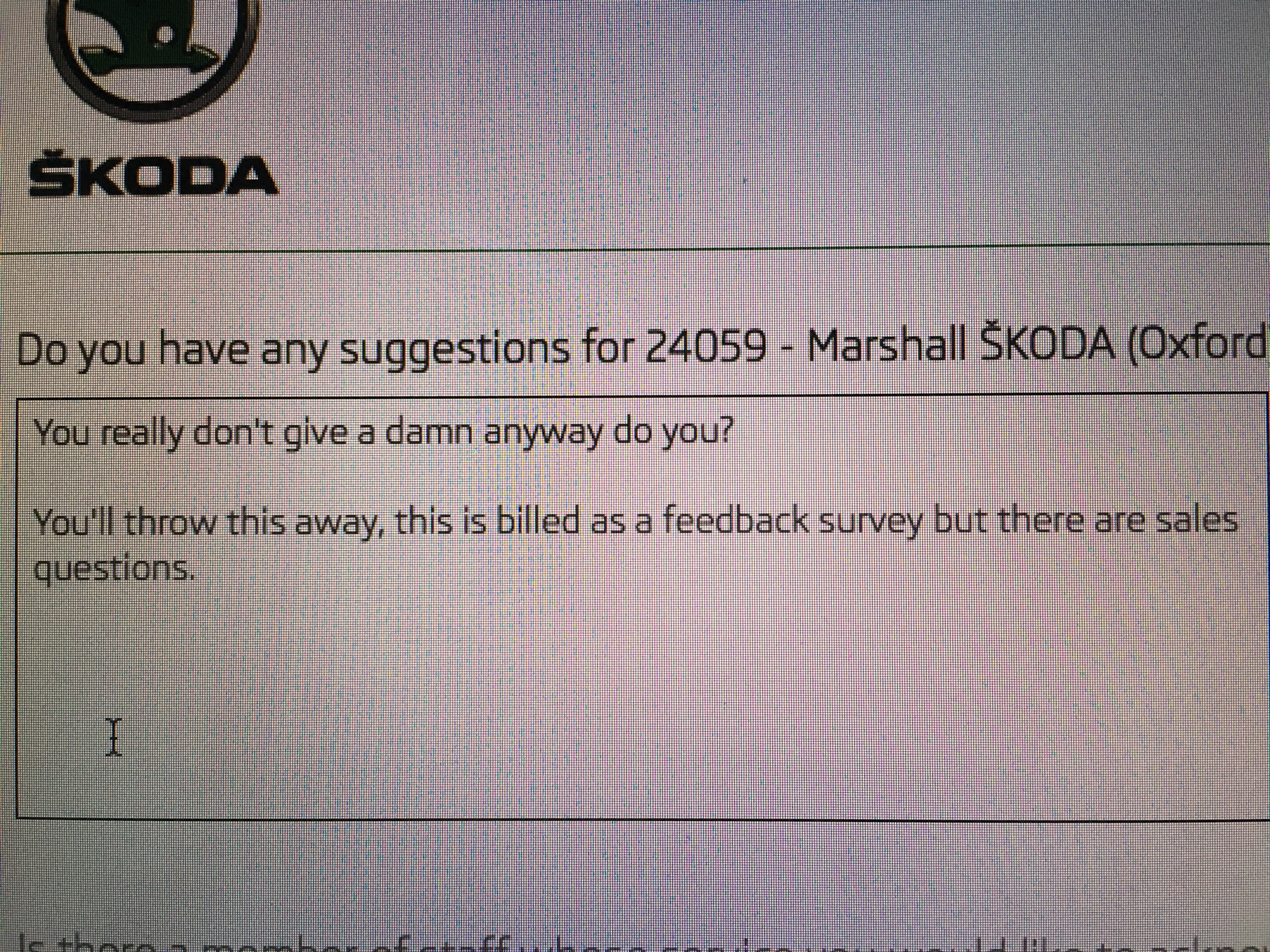

An Oxford dealer Offski.  They sent a feedback experience from my latest visit.  My response was not polite as it began with marketing questions.  Gender, Age and occupation.  Also. when was i looking to buy a new car? I will calm down and respond with more information soon.  I don't know what is meant by service action or campaign.
