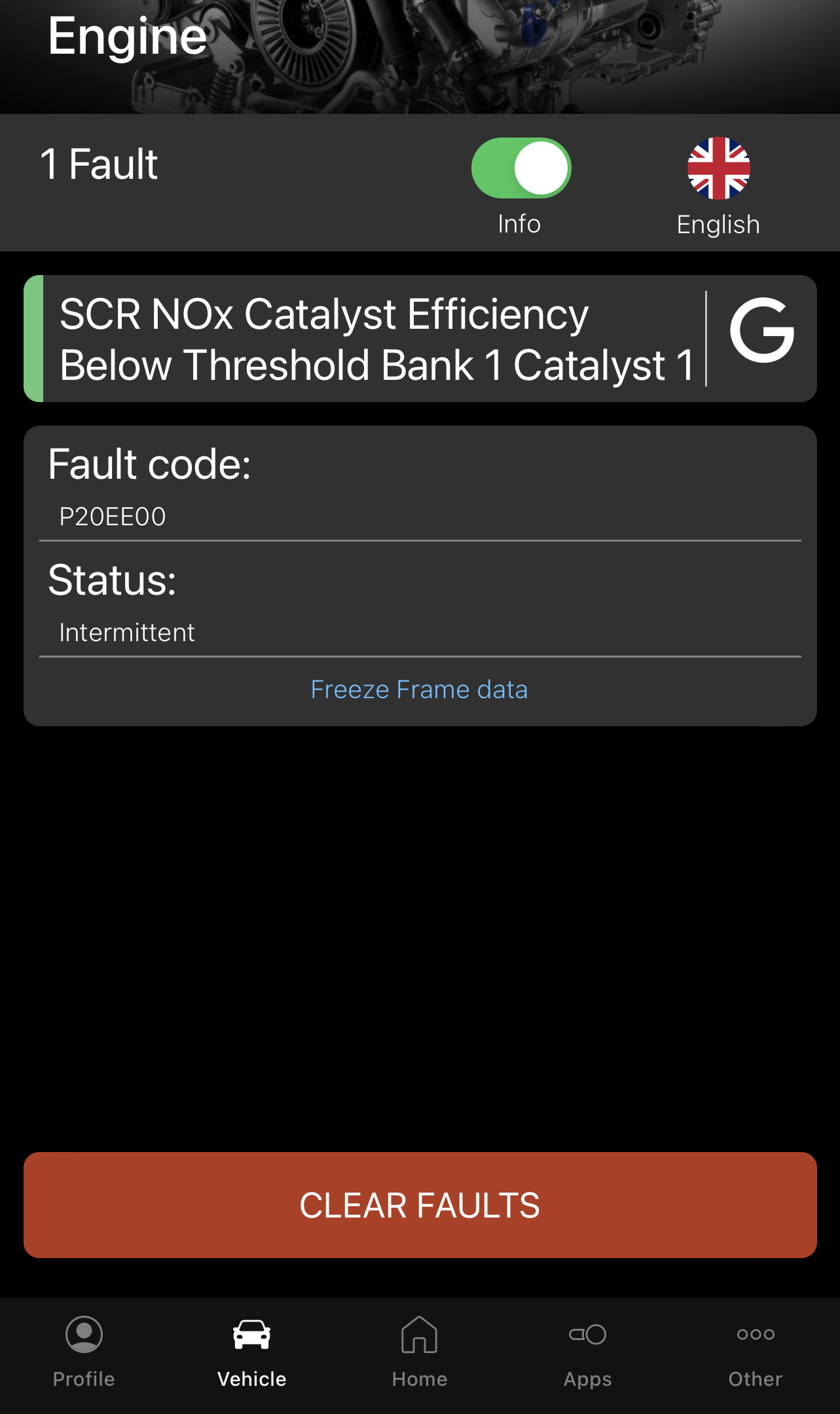

I have mine booked into the dealership tomorrow as I had the engine management light come on the other day, scanned using ODB-eleven and had the NOx fault code
Would be good to go in armed with some info before they fob me off
Cheers

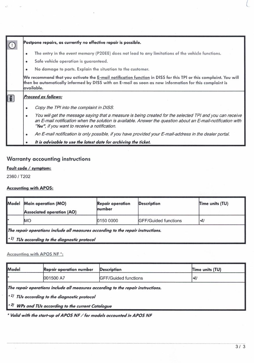

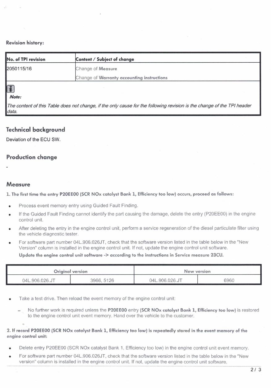

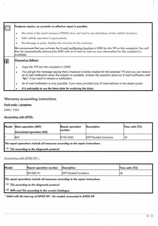

'He (the service manager) has also given the part of the report which states SKODA are aware of the software issue causing the EML light to appear and have released the following comments –
  • The entry in the event memory (P20EE) does not lead to any limitations of the vehicle functions.
  • Safe vehicle operation is guaranteed.
  • No damage to parts (Explain this situation to the customer).
These are the official instructions we have been given from the factory.
I understand it must be frustrating buying a new vehicle and having a warning light appearing on the dashboard, but please rest assured that as soon as the software update becomes available, we will contact you straight away so this can be booked in. I also thought it might be reassuring to know that with the statement above being from the factory, they have guaranteed that you will not suffer any mechanical issues with the vehicle due to the light being illuminated.
I do apologies for the inconvenience this has caused but with any luck the fix will be out soon and you can start to enjoy your new car!

Couldn't find anything that would help me get closer to solving the problem. Car is Superb 2018, 2.0, 140 kw, L&K.
Once in a month I get also P20EE00 - scr nox catalyst efficiency below threshold bank 1 catalyst 1
Any experience here how to move on ?

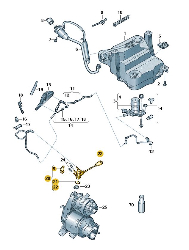

Does someone have good plan/drawing, where this NOx injector is located ?

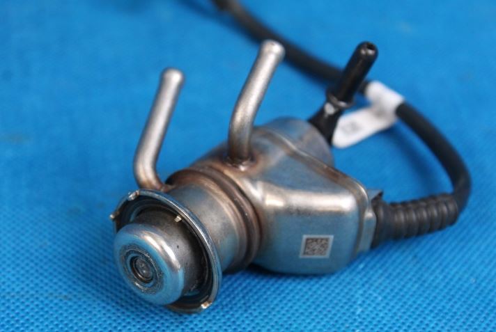

Am I right when I say that the injector that needs checking/cleaning is the one in the video below ?
Yes that’s an adblue injector but yours may be located down the back of the engine visible from the top. You also may not be able to fully remove from the car as it will have coolant lines connected to it also
I guess were talking this item: 04L131113P - Weird is that I cant find any topic or video about Škoda Superb AdBlue urea injector problem or Škoda at all...Would be nice to read or watch video :) Does anybody have it to share ?

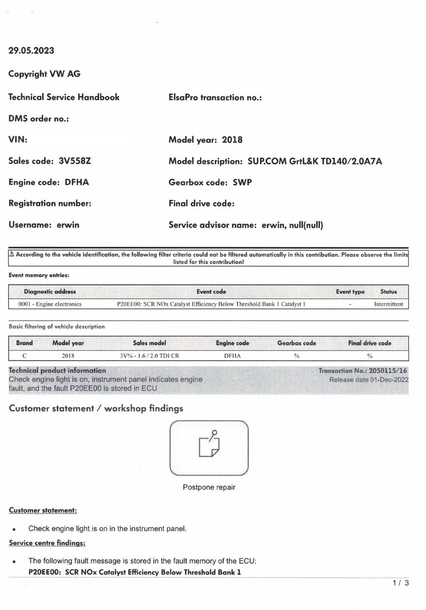

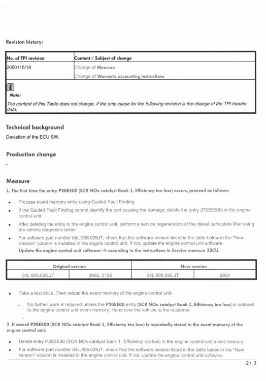

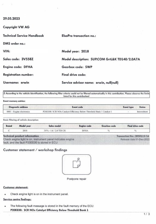

So, today my car went to online diagnostics, because of this P20EE00 - scr nox catalyst efficiency below threshold bank 1 catalyst 1 error.
The result was that engine software must be update ? But they can't do it (diagnostic was done by local workshop, not the dealer)
I got diagnostics raport also. I attached it.
Also I sent it to dealer to understand, what we can do to solve this problem. Is here anyone, who have been the same issue ?
