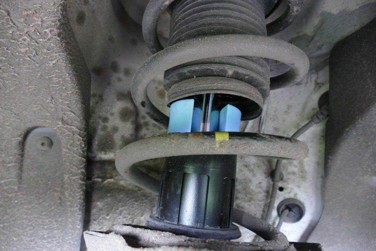

So I got my Sportline 280 back in December and have done about 1600miles now. We have always felt the suspension was harsh when going over speed bumps etc., going over a speed bump always gave a real bang and felt like you had hit something and bottomed out the suspension. But not noticeable on general driving.
Turns out we weren't going mad - the dealer hadn't done the PDI properly and had left the transport blocks in. One on each side one mine - some googling suggest some models have up to 3 each side.

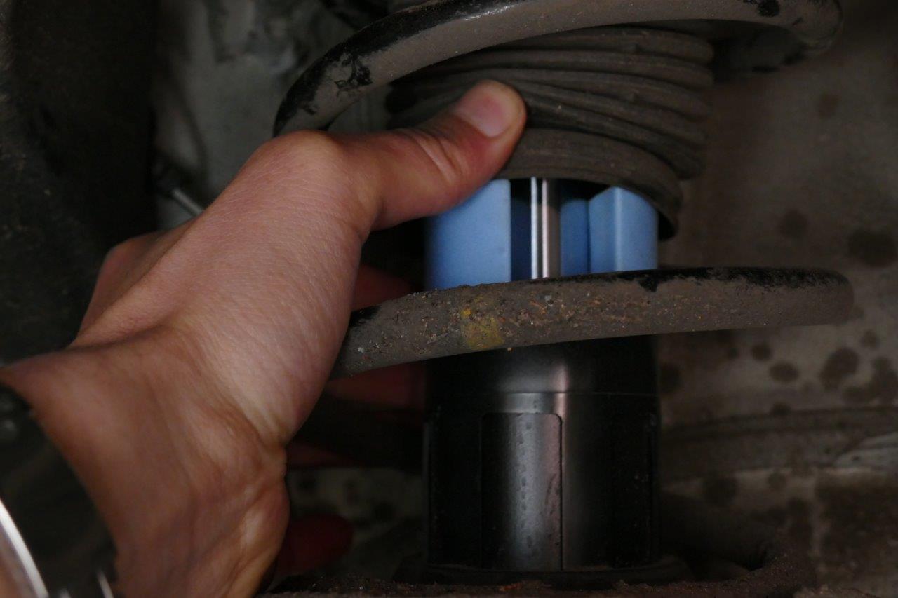

To see them you need to jack the front of the car up (please make sure you put something under it other than the jack to make sure it can't fall on you), or you may be able to get away with just turning the wheels to lock. Then you have to lift the rubber boot up - easier if it is jacked up and the suspension has dropped down. And see if there are and blue plastic bits inside - they can get stuck up inside the boot as well so have a good feel around.

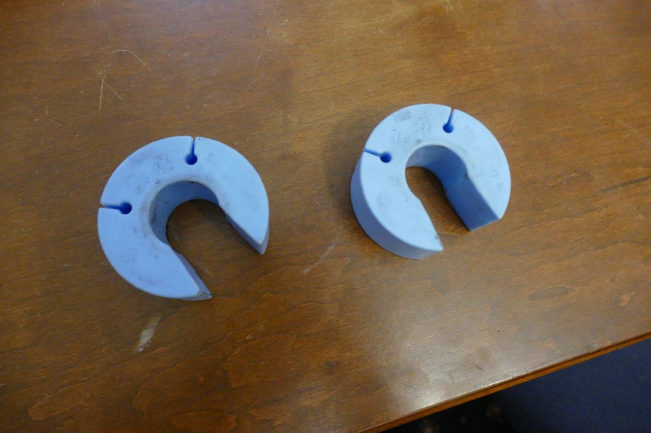

If you do have any they simply pop sideways off the suspension and are taken away.
The car now drives nicely with no bangs or harsh impacts over speed bumps. For a bit of googling it sounds like this is all too common with VW group cars.

So, can someone who's actually done this confirm - to check a car, is it just a case of jacking the car up at each wheel, in turn, reach into the coil and push the concertina bellows up from the bottom and check if there are any blocks in there? Obviously pulling the bellows down after checking.
Do you need to check rear as well as front? Both normal and DCC shocks?
Worried about mine now, as ride seems harsh over speed bumps or pot holes might take it to nearest tyre place just for check
Yes, for mine (non-DCC), you just jack up each front a bit and push the boot up as it the pic at the top of the thread. As far as I know there aren't any at the rear.
Front only, no rear transport blocks have ever been reported in many similar threads for all Skoda models.
