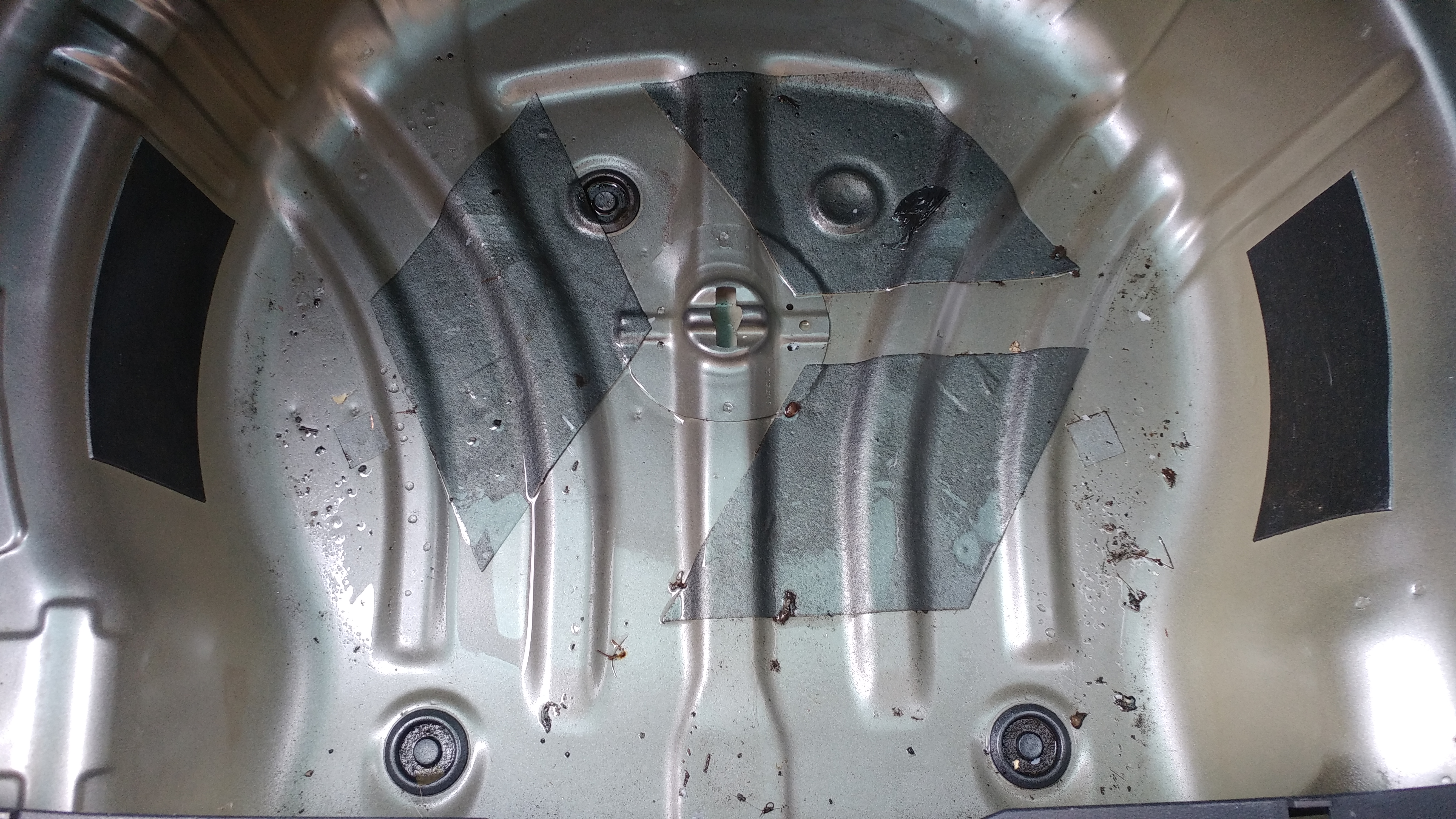

Decided to give the car a proper internal clean today which included a full clean of the boot.
When removing the spare wheel insert (I don't have a spare) I was shocked to find around 5mm of water in the wheel well.
I have not done a test to try and find root cause, but can confirm nothing has been spilt and that the polystyrene insert was bone dry on the inside so the water must be from rain water making its way in.
I checked the boot pillers and all is clean so unless its getting into the boot via the side catches I dunno where else it could be getting in.
Anyone else experienced this or at least checked theirs....

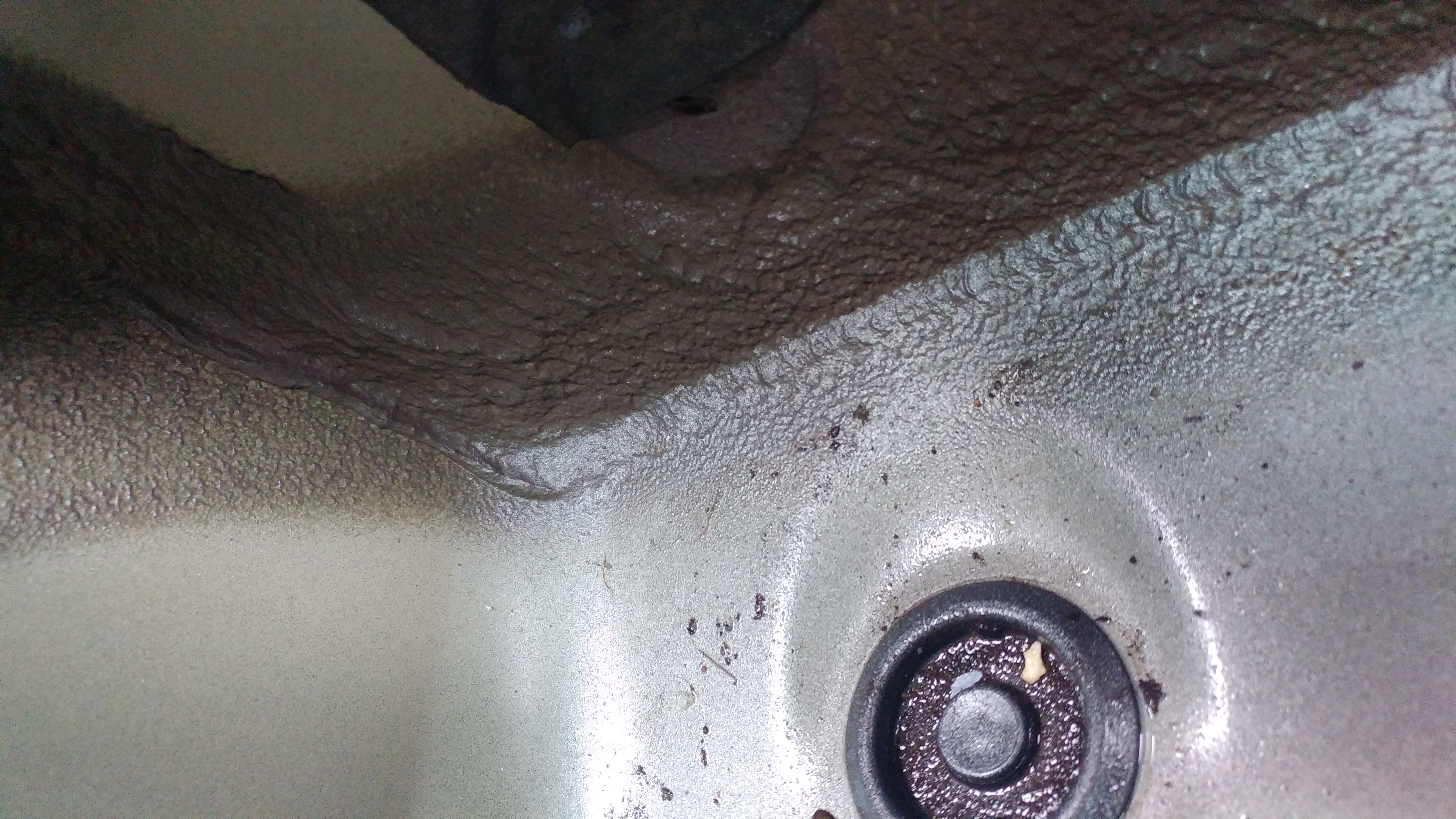

Anyone's welds also this colour ?

Looking at the picture of your boot floor, to the right of where the spare wheel latch would go... are those 2 holes?
Has your car ever been fitted with a tow bar? Often, sellers will remove them, (and of course it's never been used for towing Sir), and don't seal up the fitting holes..... maybe.

No holes anywhere... All sealed hence no release of water...
Its got a factory fit towbar fitted ... Will be mentioning it to the dealer when it goes in on Tuesday for another fault they can't fix !!!
