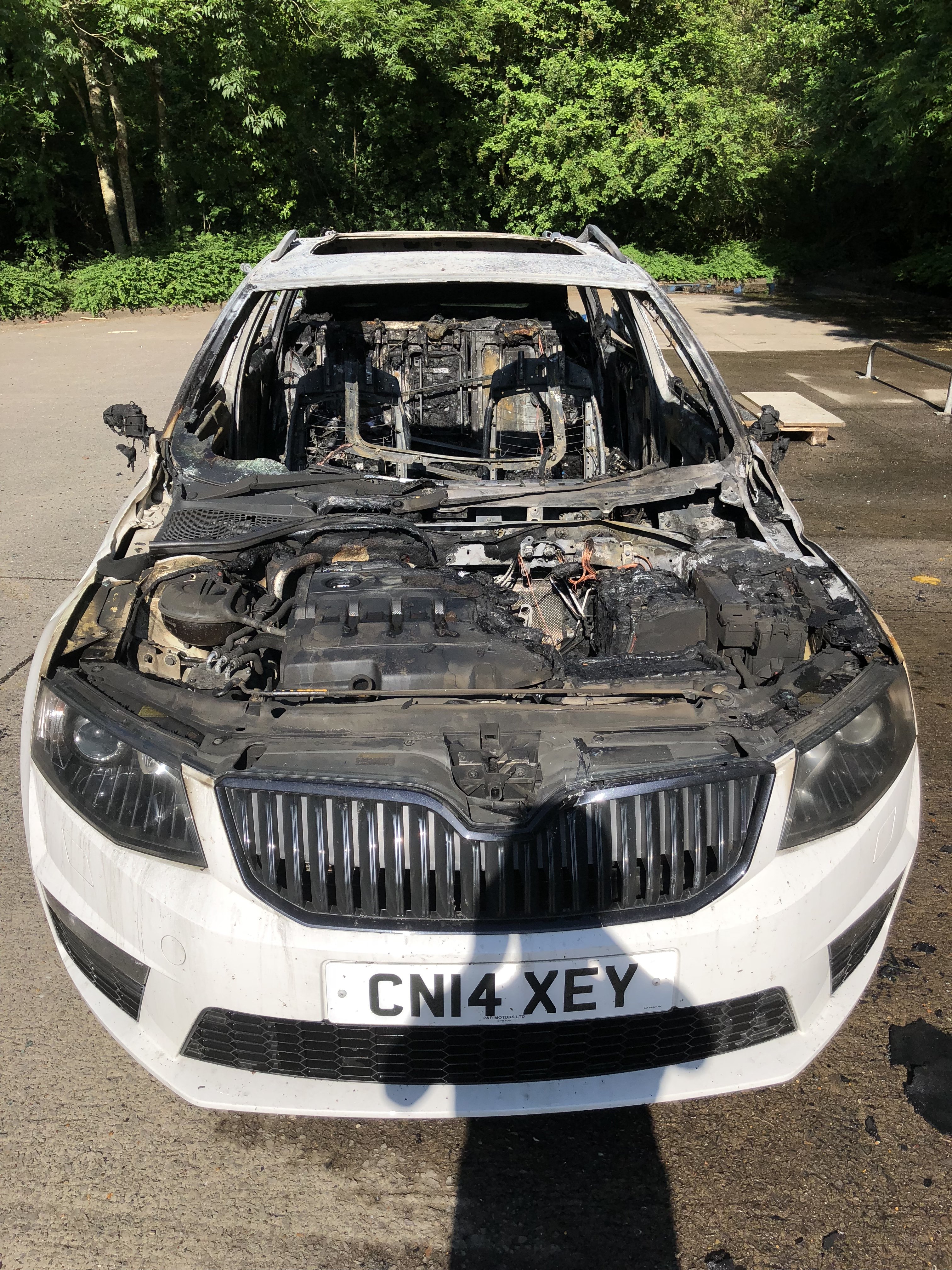

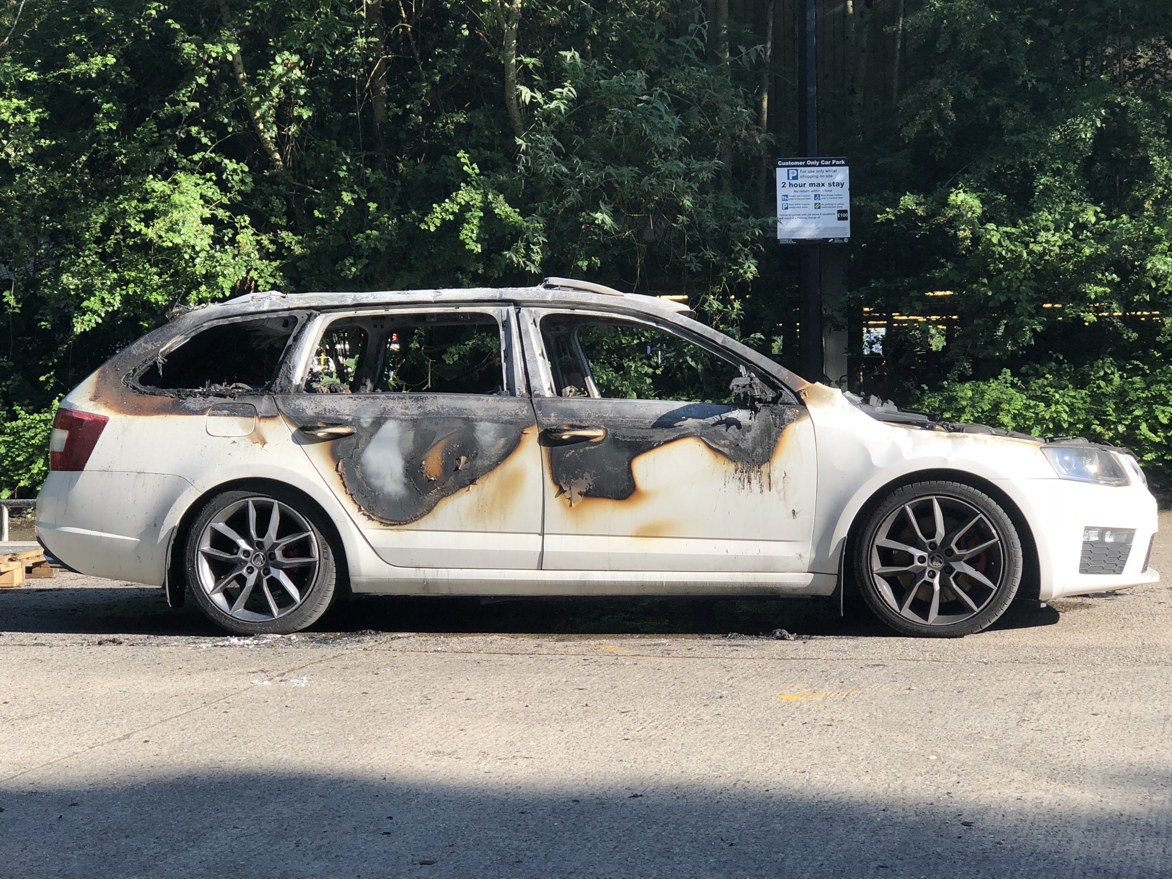

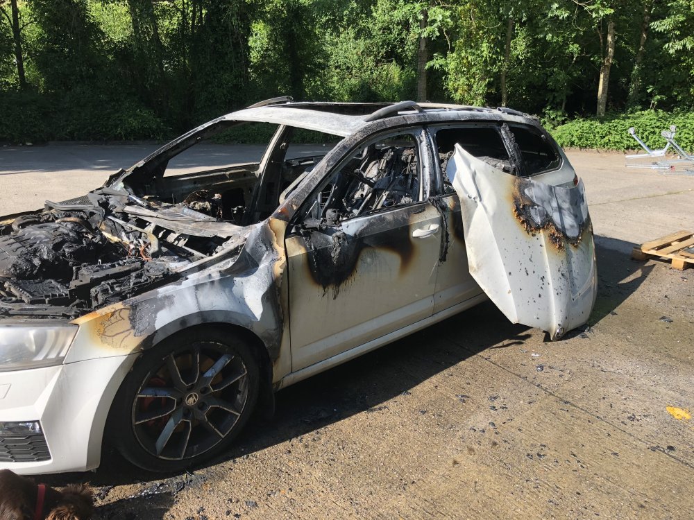

Never thought this be the last drive
Car was basically driven 4 miles and parked up. As I walked my puppy near by.  Sad times.  Now the long wait on what caused it.

Almost looks like the fire was started in the front passenger area but I guess it'll have to wait for forensic to have a look
Absolutely gutted for you :crying: Hope it's all sorted without much headache and grief to you!
First attention might be given to the glove compartment area or the battery area.
Just a uninformed guess by the burning of the bonnet.

Does seem like it’s possible started there.  It was from behind the dash as for some crazy reason I reached in to grab my house keys.

How did the bonnet get to where it is in the photos?
I'm guessing it was removed by firefighters - that passenger side wing looks as though they may have levered it open!

Yeah it's a standard process on a car fire to crowbar the bonnet open and hose down the engine bay, whether it appears on fire or not. Just prevents the possibility of it going up again.

From the various burn marks, that almost looks like a battery shorted and overloaded before catching fire. Mainly as the bonnet is burned near it and it looks a mess.

When a battery has an internal short, it loses power to 10.5v very quickly and won't catch fire. If the wiring or modules on the outside of the battery are shorted, the battery will just keep fuelling the spark at the short point until its discharged which can take around 5 mins to achieve.
Looks like a lot of heat damage over the gearbox between the battery and engine. Doubt the battery was the cause.

Cars not been touched in any aspect. It has however 6 weeks ago had a new front bumper.  And a crack in the roof repaired.  Where they had to remove the headline.

Just looking at bonnet and agree with others - looks like glovebox area. Or could it possibly be fusebox at rear of glovebox? You didn't have something like a dashcam hard wired in there by any chance? I've read about a few problems with piggy-back fuses.
