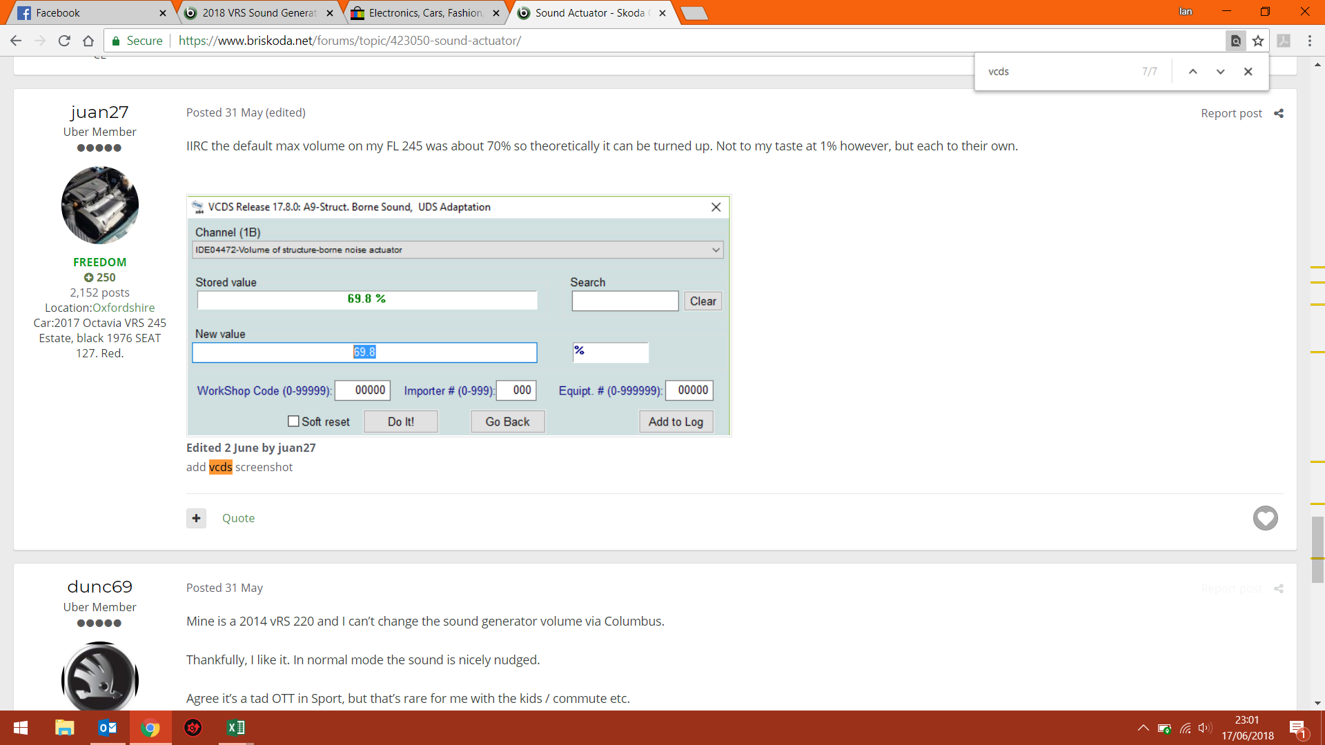

Do you know whereabouts in the VCDS the sound generator adjustment part is? I found the below picture on here, but I don't know how the user got there.
It's shown in the picture mate - controller A9 "Structure borne sound".
Nice one. Sorry, I couldn't see the wood for the trees.
I'll have a butcher's on my car tomorrow and see what setting mine is at.
I've had a look on vcds at this setting and mine is on 100%. I've done the output test for it as well and I clearly hear it is, plus I done with the engine on as well and it was just as loud.
