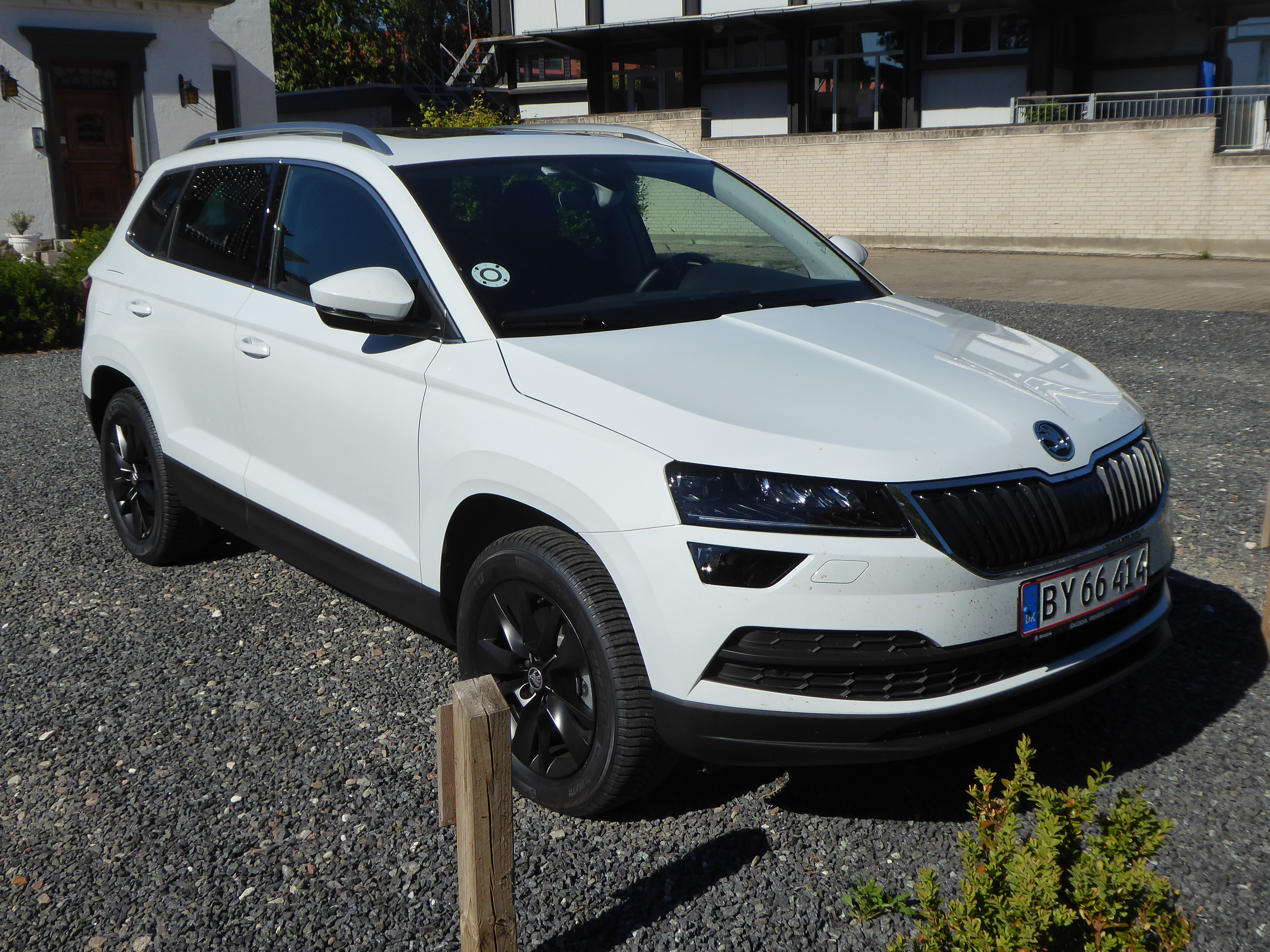

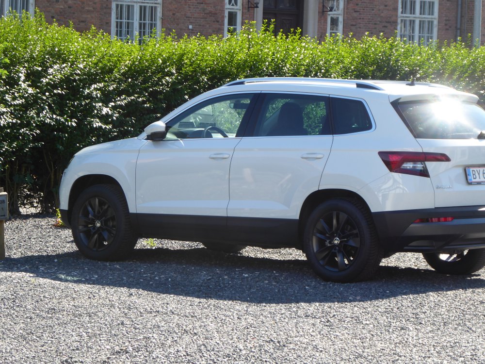

The new wheels and tyres workshop extremely well. It is fairly clear that the 225/55 - 17 size suits the Karoq suspension tuning much better than the original 18 inch wheels. With the original 50 series tyres, the car handled OK, but was not as “together” as my old Yeti’s. This has now changed. The car handles in a fashion that feels harmonious- meaning that it behaves as you expect it to for this type of vehicle. Just like the Yeties did.
On top of that, the Michelin CrossClimate tyres are significantly less noisy than the Bridgestone Turanzas. So high speed motorway trips are much more relaxing. I know from past experience that the CrossClimates perform well in both dry and wet conditions, so a little poorer snow performance in our climate is a very small disadvantage.
The Skoda Triton wheels in the dark grey colour with no shiny bits look good on the white car, and does not show the brake dust - which was the purpose of selecting them.
So, who’s a happy camper now?

How about a photo?
Hre you go
Black (platinum) triton wheels ??? Not seen those before :o

The Triton wheels are standard Original Skoda optional 7J-17" wheels. They are not really black, but a VERY dark grey. No small, narrow fiddly bits in the wheel design, so no places you cannot get to and clean, and the color does not show the brake dust much.  The standard wheel brushes in the car wash does clean them quite well.

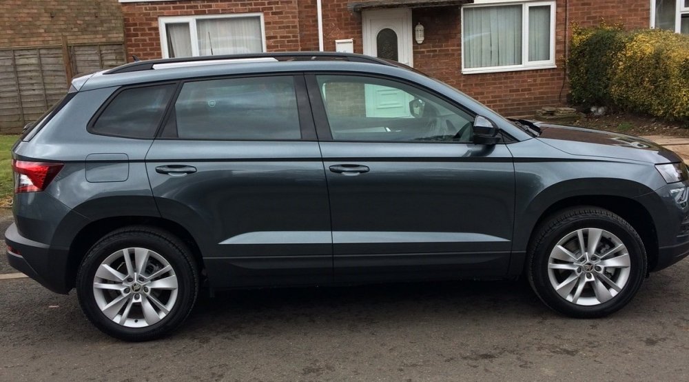

I've got Triton as standard on my SE Tech, but only ever seen the silver ones :)
No black 17" Tritons listed in the Slovenian configurator either - only silver.
Black triton part no. 57A071497A ZG6

Thanks very much. The wheels look smart and the tyres are an excellent choice. It's the set up I want if they ever bring out a 4x4 with the 1.5 TSI engine.
