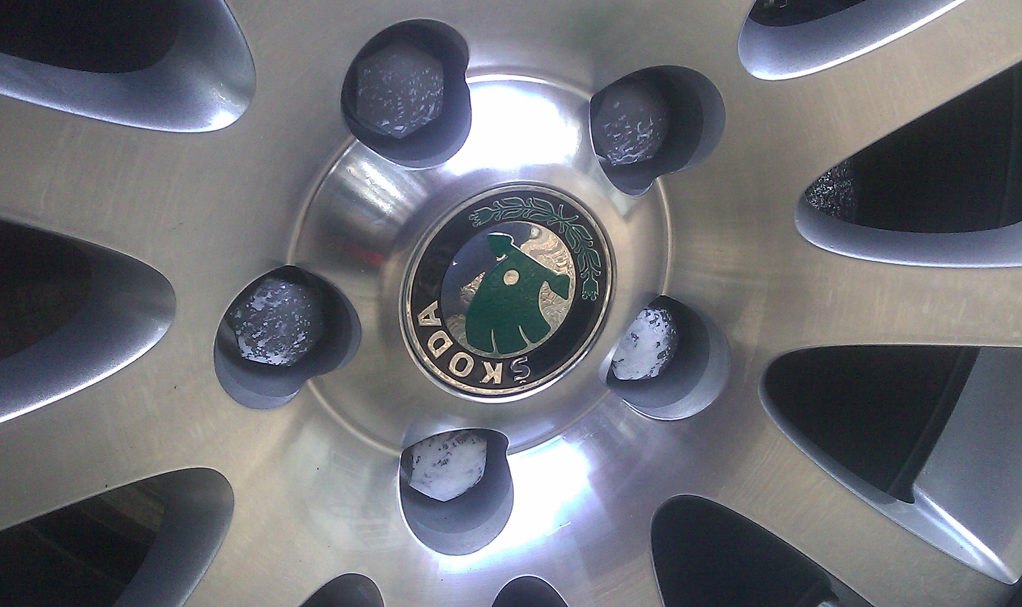

Check the plastic wheel bolt covers, as these are equally likely to stain if exposed to acidic TFR...

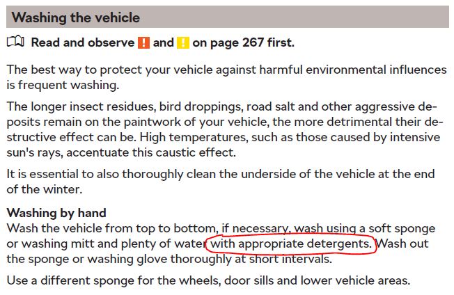

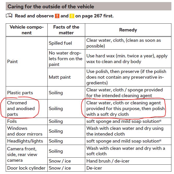

Whilst they don't make specific reference to not using harsh chemicals, they do make it clear that 'appropriate detergents' should be used...
They then go on to make specific reference to the chrome parts, this would suggest that you should only use 'clear water' (detergent free?) and / or a chrome polish...
Quite how you wash the car and avoid the chrome trim is beyond me, but either way if they wanted to dig-in and refute a claim I guess they've plenty to fall back on.
