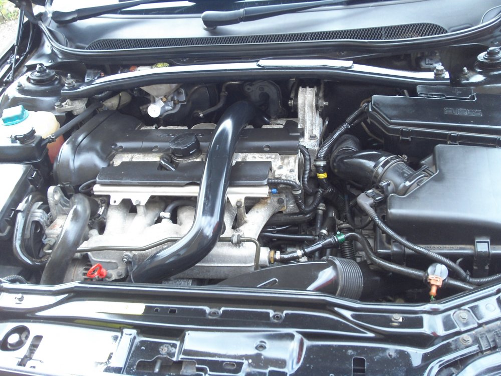

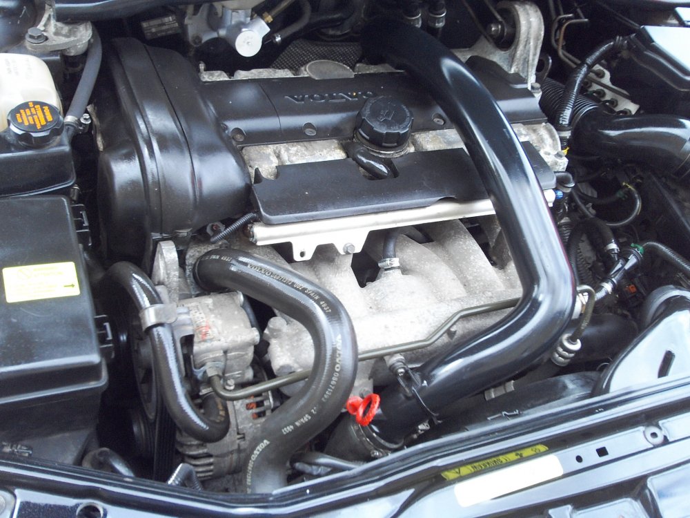

I like to oil lightly the engine alloys after cleaning, stop the horrible alloy whiteness  / corrosion that comes after cleaning engines and removing the protective coating.
I use Tesco Tyre / Rubber renovator on plastics.
eg   Corroding horrible alloy.

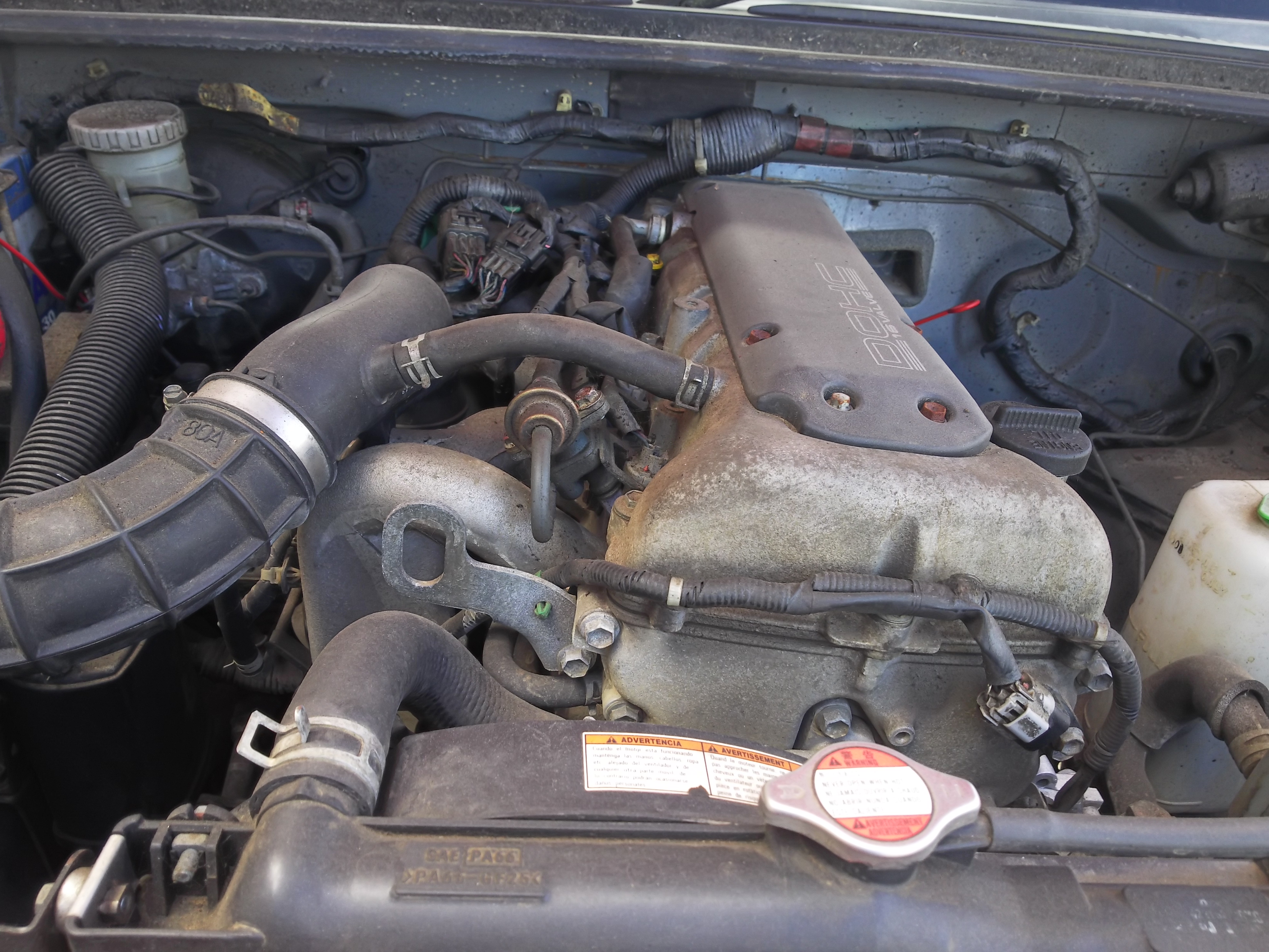

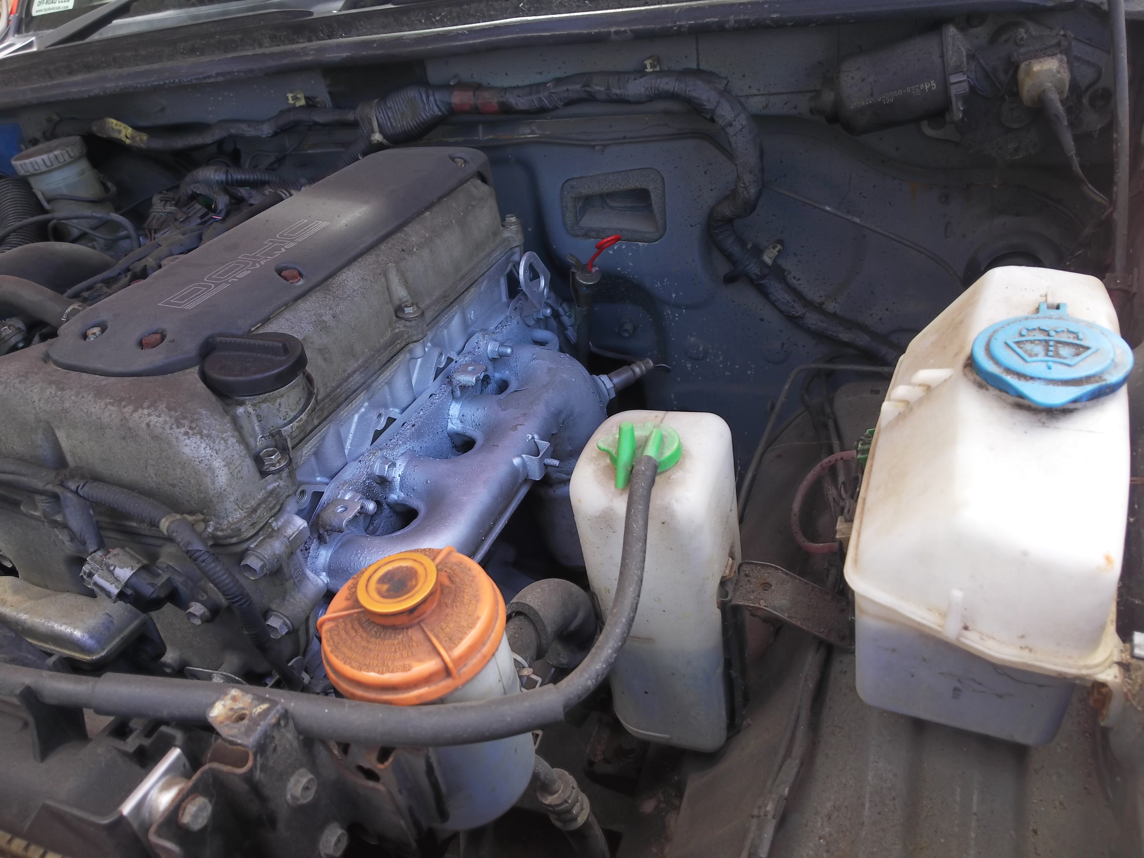

This is my 1999 Jimny.  Under 60,000 miles and now only does around 500 miles a year.
So 19 years old.  All the wiring was sprayed with Finnagan Waxoyl when new & white grease in various places and then dirt & cobwebs allowed to gather.
Not really had anything done to it for a few years, i must give it a tidy up.
There is some corrosion showing near the bottom brackets of the radiator as i looked while taking these pictures.
