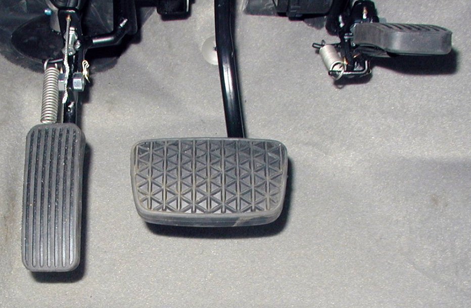

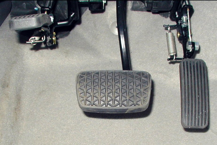

One easy solution is a flip pedal that moves the throttle to the left of the brake, or has a throttle both left and right of the brake pedal, but that does not lower the brake pedal which is the issue in this thread
Bottom pic is how i leave my own cars. Only thing i change is maybe the rubbers on pedals, or the shape.
The reason for standard so no confusion with pedals changing vehicles.  Pretty difficult in my experience moving left foot from left throttle to brake to the right of it.
My Artificial foot stays where it is and left foot operates both pedals.

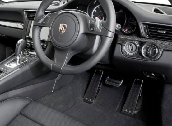

( thinking aloud to myself...   what on earth have those pictures above got to do with raised brake pedals? Why do people take every opportunity they can to self promote themselves? All their responses follow the same theme - "look at me". )
