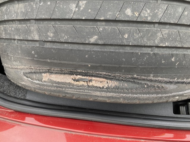

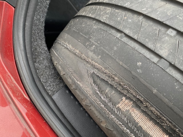

Dangerous tyre wear on inside shoulder
2 minutes ago, IanJD said:
New tyres are already on (done by ATS, but VW finance insist on alignment being done by a dealer). Didn't have any droning before the flat tyre, or any other symptom, in spite of regular checking from beside the car.
That's why I posted originally, this was a complete shock but at least it happened on my drive, it could happen to someone else while driving at speed and kill them -- so if you do have a Superb III, I strongly suggest you inspect the inner tyre edges (visually and by touch) just in case yours are doing the same.

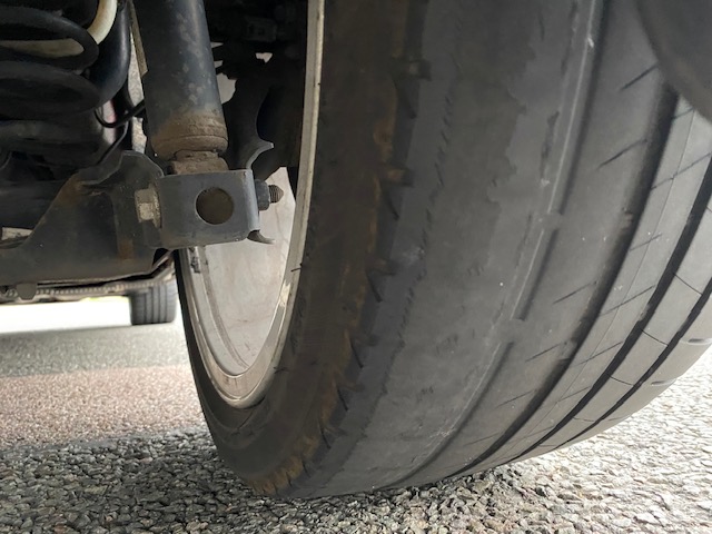

3 minutes ago, TonyTonic said:
Is this on all 4 tyres ?
By far the worst on the rears. Fronts were newer but also worn on inner edge, might have gone the same way at the same mileage but I'll never know now...
[also easier to spot on fronts because you can see the inside edges on full lock, for rears you need to get under the back of the car with a torch]
You need a full geometry check as the similar used to happen on mk2 Octavia with the independent rear suspension.
Got the full geometry check done by the dealer (actually they sent it out to someone for laser alignment), unfortunately didn't get detailed results back except a comment that the alignment was "way out" -- no way to tell if car was supplied like this or due to pothole damage or similar, but at least I ddn't have to pay for the tyres or the re-alignment :-)
I don't know why some dealers hold back information. Have they something to hide?
Way out....what does that mean if they don't have before/after figures.
The cynic in me is telling me it's probably still not right....
When they demanded you didn’t go elsewhere for the alignment I suspected you wouldn’t get anything in writing. If you’ve never had the alignment done it’s likely to have come out the factory like that… especially with the symmetrical wear. I’m guessing they will give as little info as possible (without actually lying) in case of litigation… a potential error at the factory could have been fatal.

This is not unknown on both Octavia and Superb ,i first saw it on a friends motor down to the canvas on inner edge after only a few months but high mileage  and after looking on here here found quite a few reports so when having my fronts replaced on the vrs Octavia had the 4 wheel alignment done to avoid the chances of a blow out,there are also a few posts about sawtoothing caused by mis aligned wheels.

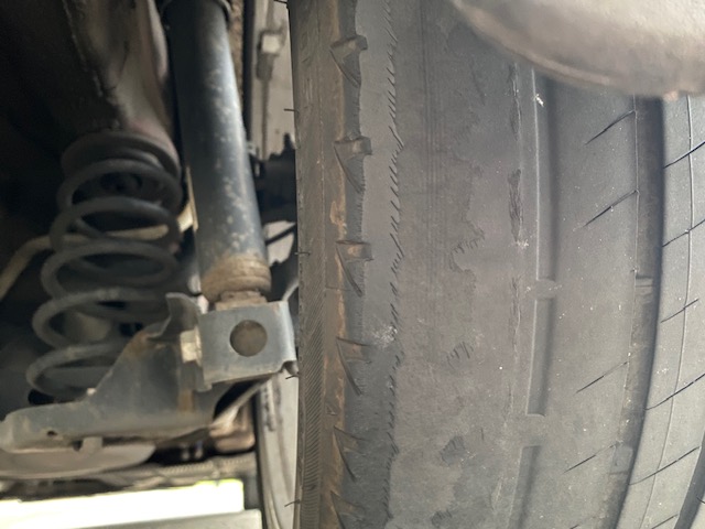

Brand new tyres fitted two months ago ruined after 6000 miles.  Replaced the tyres today and I tried have the camber adjusted but I was told to sell the car as nothing can be done. Is this right, Octavia mk3 2016 2.0l diesel doesn’t have the camber adjustable? Can anything be done to adjust it? Has anyone had this issue on their car? These were the photos taken before i had the tyres replaced. Thanks
Obviously something can be done by a proper Mechanical Engineer / Mechanic.  Do not deal with total muppets / fitters.
Thanks Toot, what shall i do? They said the rear axle is not adjustable. Nothing can be done. I don’t want to sell it. I will go to my local Skoda dealer tomorrow to see what they’re saying.
