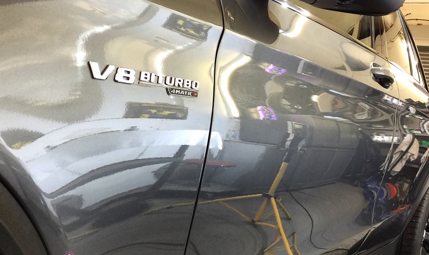

That paint on the metal part of the bodywork looks pretty much normal to me - slight peel but nothing that would concern me.  I've seen far worse on brand new cars in showrooms - whilst this isnt my picture I'm using as an example (picture taken from a Detailing World thread) - Look at the area to the left of the badge.
Agreed, that looks very poor.  However lets face it, M-B don't have the best track record for paint finishes and general coachwork, especially around the wheel arches.  The E class can out-rust a Lancia Fulvia.
@ScoutCJB
It may be so. But two wrongs don't make a right (or a new 'modern' acceptable standard). It is up to the buyer if they accept a s***ty paint on a new car. To me, the newer the cars the worse they look in these days compared to 15-20 years ago.
