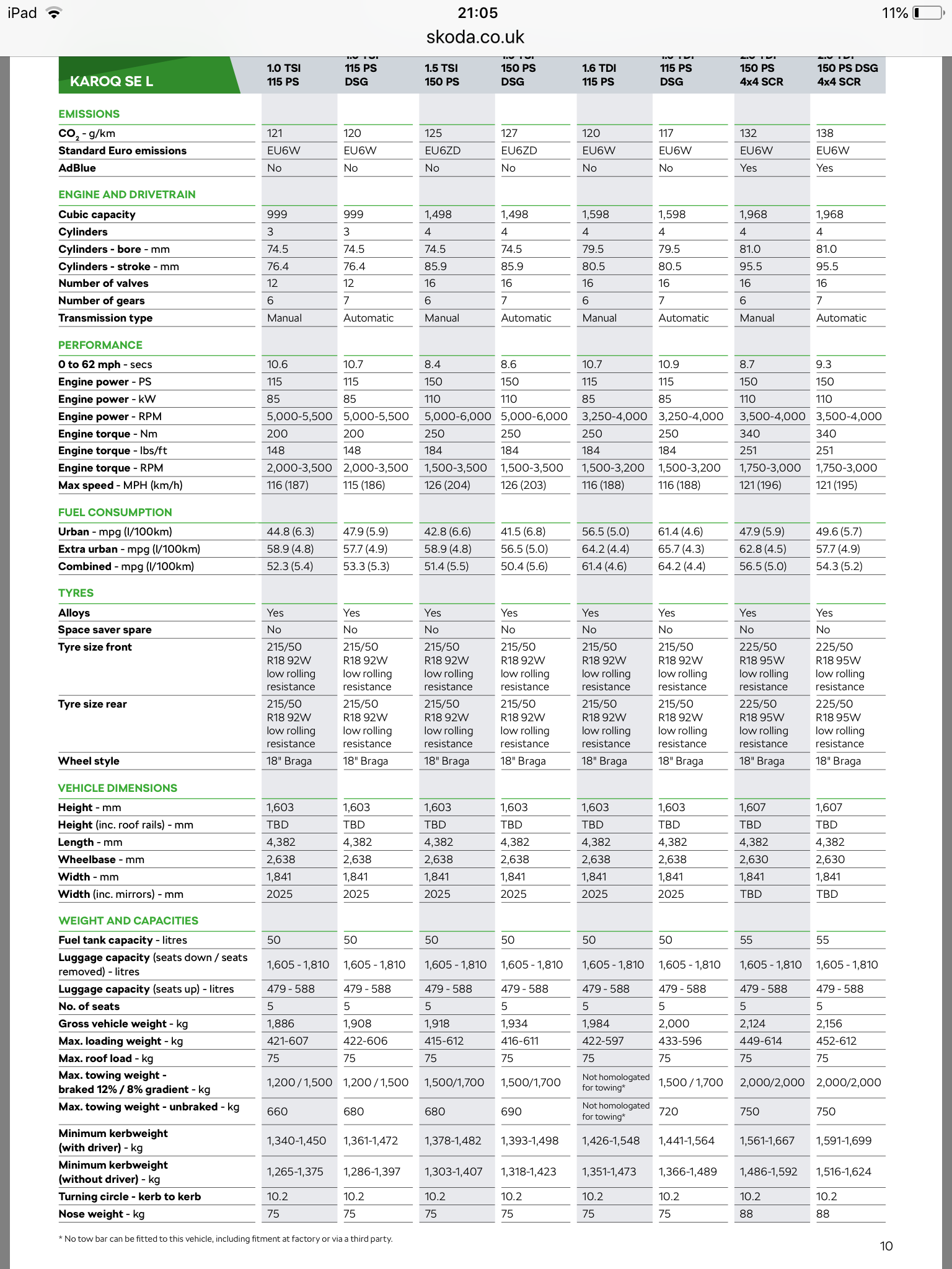

I am looking to purchase a Karoq SE L 1.6 TDI Manual gearbox, When I visit the Skoda website and configure my car it tells me that the spec I want you cannot fit a factory or 3rd party towbar?. This only applies to this engine and gearbox, If this is true I find it very strange indeed. There is no problem fitting a towbar to the 1.0 TSI Manual Gearbox which you would think has not got the same pulling power as a diesel. Any help would be gratefully received
The Karoq 1.6 TDI SEL  manual in not homologenated for towing, there for cannot have a towbar fitted at factory or later by @ 3rd party.

Thanks Kenny it just seems a little odd, nevermind I will have to go for my other option a VW Tiguan
You could always go for a 1.6 TDI with the DSG gearbox as it can have a tow bar fitted.
