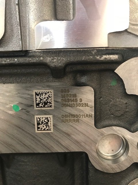

    I don't know but Furrows thought it was brand new.  This is the block marking.  I was told that the number one down from the top (140218) is the actual manufacturing date.  They'd had reconditioned en
  • Brand New from the Factory can be a Refinished engine straight from the Factory, so the Block that was returned from previous use is stripped and then used without having been melted and recast.

    And Furrows also pointed out that it had a lot more ready fitted than they'd expect on a normal "base" engine.  Even has the oil filter on it!

I don't know but Furrows thought it was brand new.  This is the block marking.  I was told that the number one down from the top (140218) is the actual manufacturing date.  They'd had reconditioned engines before to fit so I presume they know the differences.  Maybe VW had run out of dead engines to recondition so had to make a new batch?

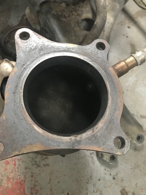

One other thing I insisted on - and EH supported me - was that the cat was tested.  I'd been driving the thing around for two months  - misfiring with oiled up plugs - so un-burnt petrol must have been going through it.  I understand oil doesn't hurt a cat but petrol does.  So they did an MOT emissions test when it was back together which it passed with flying colours.  They inspected it too, and took a pic!  No way of knowing if there's any long term damage of course but at least it's OK at present.
