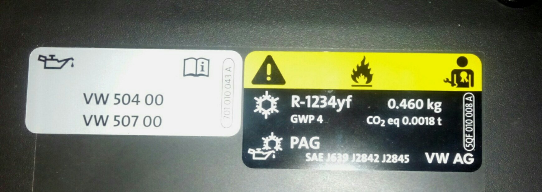

As earlier posts have said, my Bear (1.4TSI 125HP) does not have a sticker in the engine bay to say which oil to use.  I have just been looking for 508.00 as specified in the manual but no stock in Halfords.  There is so much confusion on this topic, amongst lots of people who seem to know what they are talking about, (and I am not one of those people), that I will hope that I don't need any top up oil before the first service in April 2019 and hope that my Skoda service Dept have sorted it all out by then.  I was also looking for G13 Coolant in Halfords, but no joy on that either!!

XMAN, thankyou, now it's making sense.
My dealer wasn't wrong in what he recommended I buy, as what he recommended is compatible and he obviously didn't have what I needed in 1litre bottles.
And thankyou for pointing out where it can be purchased, that's extremely helpful. Hopefully my car won't burn much and I won't need it.
