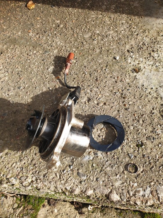

My water pump just failed 😞. The dashboard showed low coolant and the reservoir was empty. Managed to get the car home after topping it up with water. I suspected that it was the pump straightaway and so started stripping the front end until I could see the pump. I added some water to the reservoir and it immediately leaked out of the centre of the pump. In fact there was a small piece of gasket or seal hanging out from the behind the pump pulley.
Upon removing the pump there was something rattling behind the pulley, the collar was stuck covering the impeller and the plunger on the solenoid valve snapped off in the housing as the plastic seemed brittle. I think that it was not far away from catastrophic bearing failure.
Needless to say I'll be replacing it with a non-collared version since I don't want the overheating problem and I'll look to change it again in about 60k miles, which at the current rate will take me another 20 years.

I hope you got this fixed. My 15 model did this, too. Found out the movable sleeve to aid with warm up over the pump was almost seized. New aftermarket pump with sleeve delete and no problems since.
Takes much longer to get heat up now, but at least reliable

AFAIK, all the factory ones have a sleeve. The sleeve is physically visable as it sits outside the impeller.
If you can handle a longer time for the internal heater to warm up, then get a sleeveless one. My last factory sleeve one had the sleeve fail at 60k kms... At 180k kms, my car is now on it's 3rd pump, when it should only be halfway through 2nd...

First time I got warning lights was Christmas day, then about 3 weeks later and 2 days ago. In between the needle solidly at 90 and oil at 100 to 105
I asked mechanic if the bypass sleeve was stuck but at time of taking out, no it wasn't. But he didn't make thing this was odd, just normal behaviour. This is an old geezer who has been doing Skoda for 35yrs
I hope that helps. Please ask questions if I've missed anything useful
