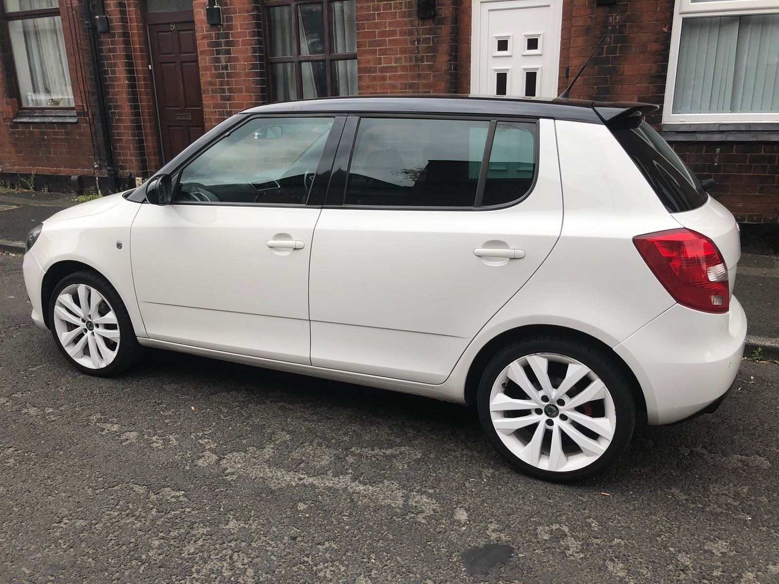

Does it necessarily have to be green? Would a white one not tempt her?
Comes with cruise control, climate control, rear sensors, arm rest ;)
Unfortunately yes she definitely wants a green one but thanks for the offer.
