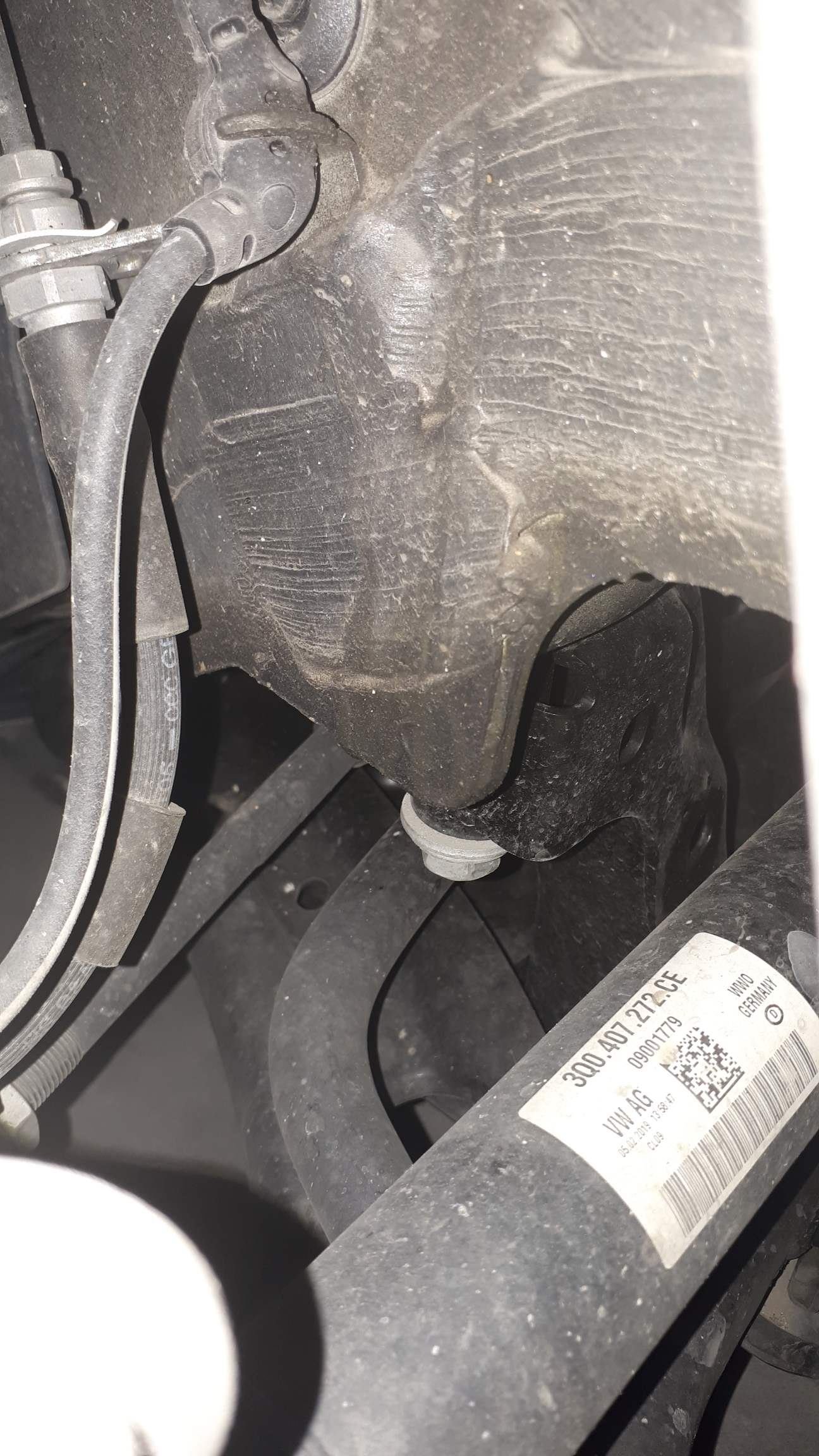

Front assembly, mounting point behind right wheel. it is shifted to outside 5-8mm.
72997013_3380503351967313_7485281055147032576_n.thumb.jpg.db9d1ace4f55c9c4320060b2af7e2e79.jpg
The washer must be in center of holed, but it is not..
At left wheel (driver side) it is moved to inside (same direction) but not more than 4mm.
My conclusion is that the front assembly is angled to chassis. If this can affect out problem, I don't know, but the Camber of front wheels is not same. One wheel is more angled than other.
Edited by ppejic
