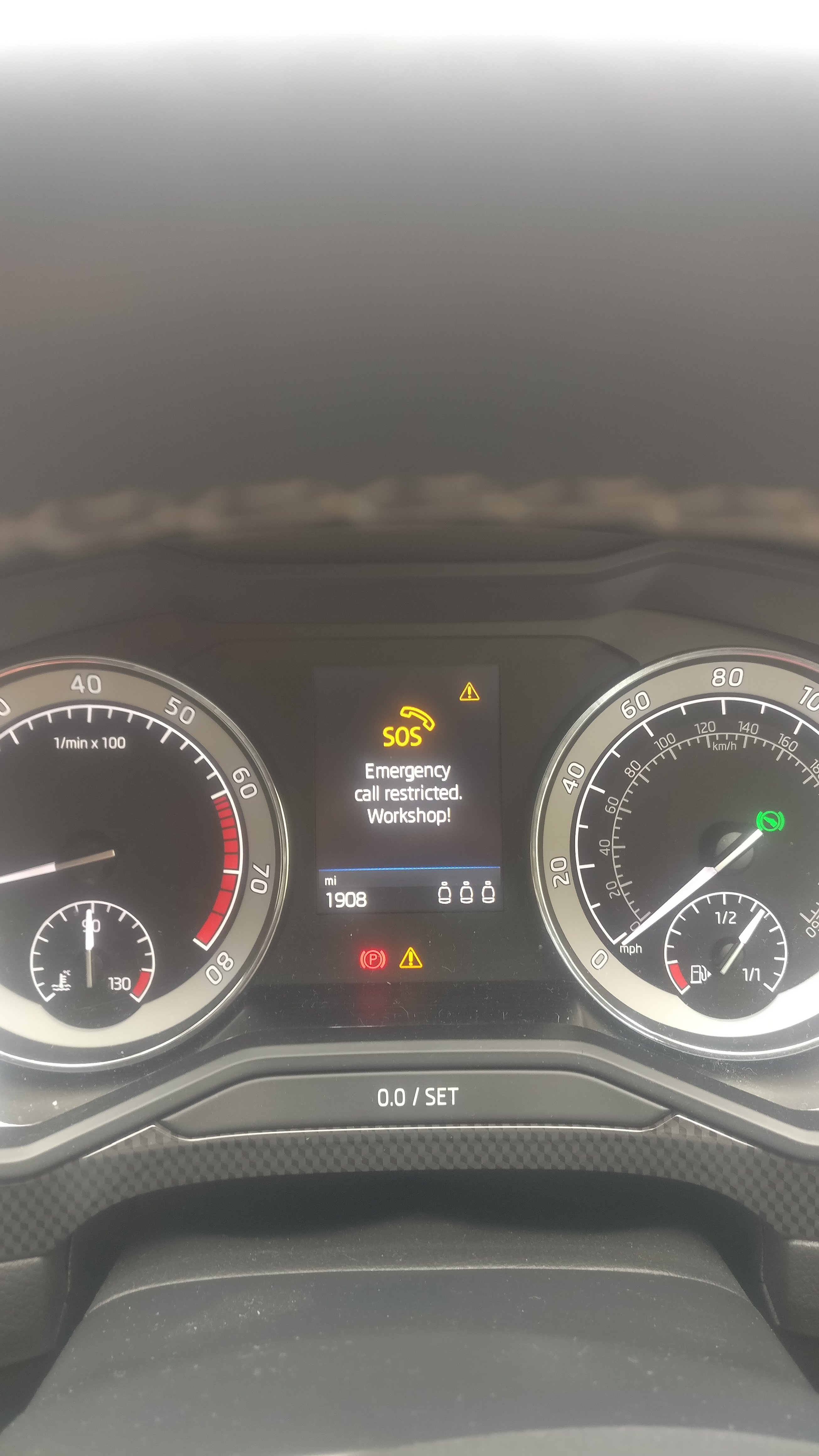

Hi i have just come out of the supermarket started car and now have a fault with sos emergency and columbus unit wont power on.  Has anyone experienced this/or know od a fix?   I did a 260 mile trip yesterday with no issues whatsoever.
I now have more faults,
Front assist unavailable
Error hill hold assist
Error sabilisation control
Error tyre pressure loss indicator
Error start stop system
Just disconnected battery to see if a reset will cure anything and park pilot and auto hold fault as well...... Sigh
Thanks, ive not had battery problems, as car is still very new as can see just under 2000 miles.  I think those faults appeared when i disconnected the battery as it was just the sos fault... Ive tried clearing faults but as soon as i drove off it all cleared from dash including the sos....  Did a 50mile round trip and all seems ok... Gonna have to keep an eye out and see if it returns. I suspect its just the sos fault.

Its sounds like your infotainment system crashed, it happens to me every now and then and thats when I get the SOS error, goes away quickly though when the infotainment system reboots.
It happens most often when using CarPlay (most often is still not frequent) and a very rare time on its own.
I find that a soft rest (hold power button for 10sec until Skoda logo shows) every now and then helps reduce the gremlins.
Thanks for info, i had literally started car up from being at the supermarket and the sos warning light came on straight away and columbus was dead....   I didnt know about the soft reset so will try that if it happens again... Rather than disconnecting the battey lol
