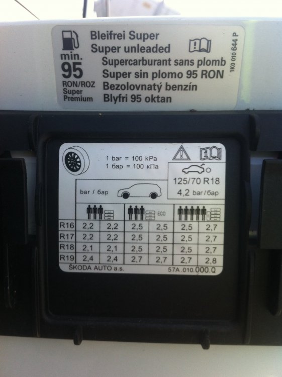

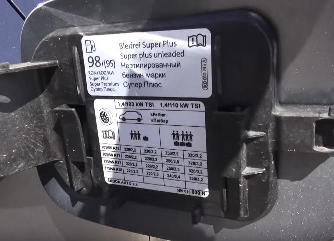

The 1.5TSIs sold in the UK have apparently been mapped to run on 95 RON minimum, and WILL benefit from 98 RON fuel.
Those mapped for some other territories with lower octane fuels will not benefit from higher octanes.
■ The use of petrol with an octane rating higher than 95 RON in does not result in either a noticeable increase in power nor lower fuel consumption in vehicles for which unleaded petrol 95/min 92 or 93 RON is specified.
■ On vehicles using prescribed petrol of min. 95 RON, the use of petrol with a higher octane number than 95 RON can increase the power and reduce fuel consumption.
At least, that is the way I read the manual and my fuel filler lid
The manual also suggests that E10 is as biodiverse as Karoq 1.5 owners can get

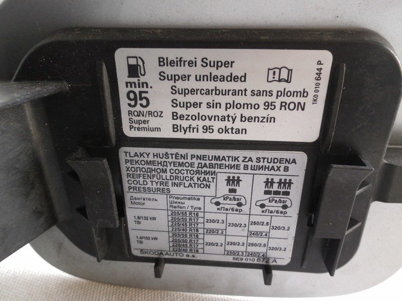

Having ran a Karoq SEL 1.5Tsi manual for 7 months and 7,101 miles (more than 10,000 km) on regular 95 unleaded at 49.3MPG. Picture of our petrol cap we have 18" alloys with 215/50 tyres fitted.
