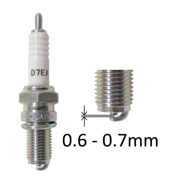

What I understood from you guys is that I must use NGK IZFR6P7 or Bosch FR6HI332 (0242240665) . Is that correct ? and I must change them every 60000 km ?
Also, what do you mean by pre gapped ? I dont know the term :(
Pregapped means they are supplied with the spark gap correctly set to manufacturer requirements. These plugs are only used on these engines so there is no requirement to change the gap
Having said that iirc the NGK are set at 0.7mm and the Bosch at 0.8mm. Don't ask, I don't know why (and don't care and wouldn't worry about it)
