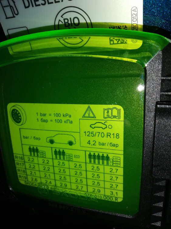

Open the fuel flap. All of the approved wheel and tyre sizes are on the sticker on the inside of the flap.

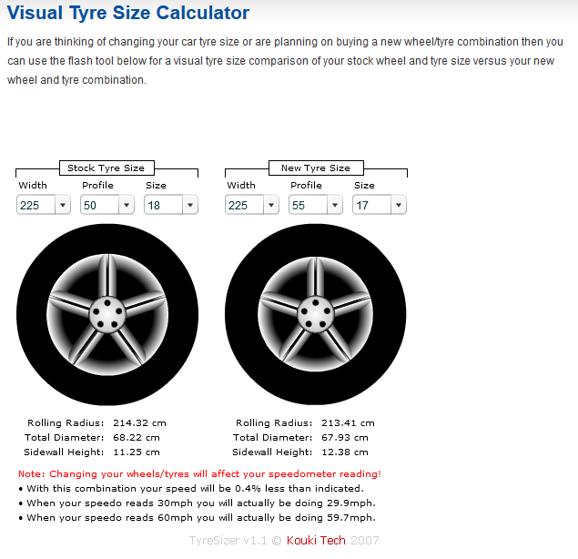

http://kouki.co.uk/utilities/visual-tyre-size-calculator
The 235/40/19 tyres have a rolling diameter of 671 mm.
Smaller wheels with 235 threads will not fit, as they get too close to the strut. (= bigger width at a smaller diameter)
225/55/17 tyres with 7J-17" wheels will fit and be 683 mm rolling diameter - about 1% larger diameter. Speedo readings will be closer to actual than before.

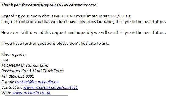

They did not exist as of three months ago - They may be available now.

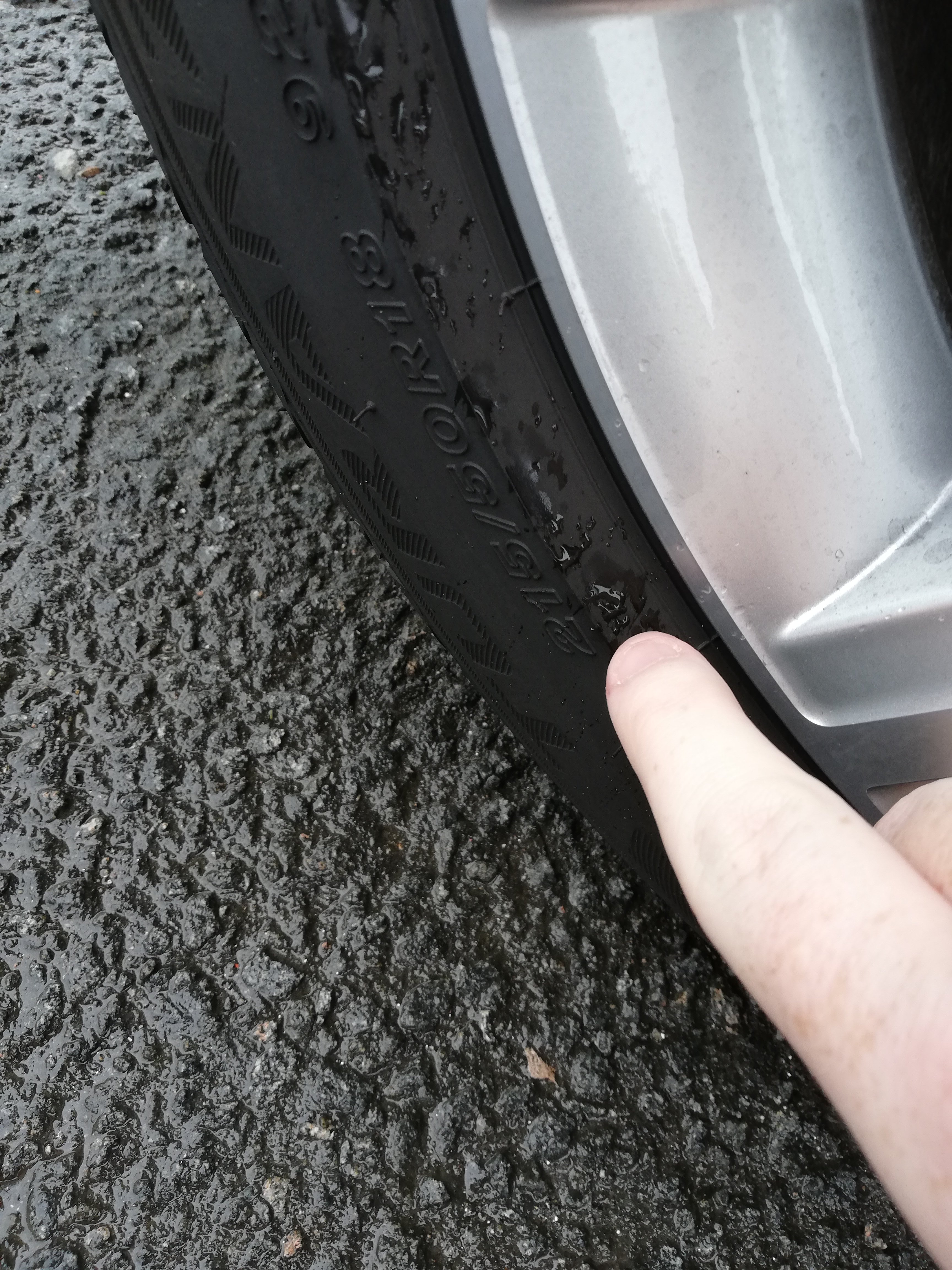

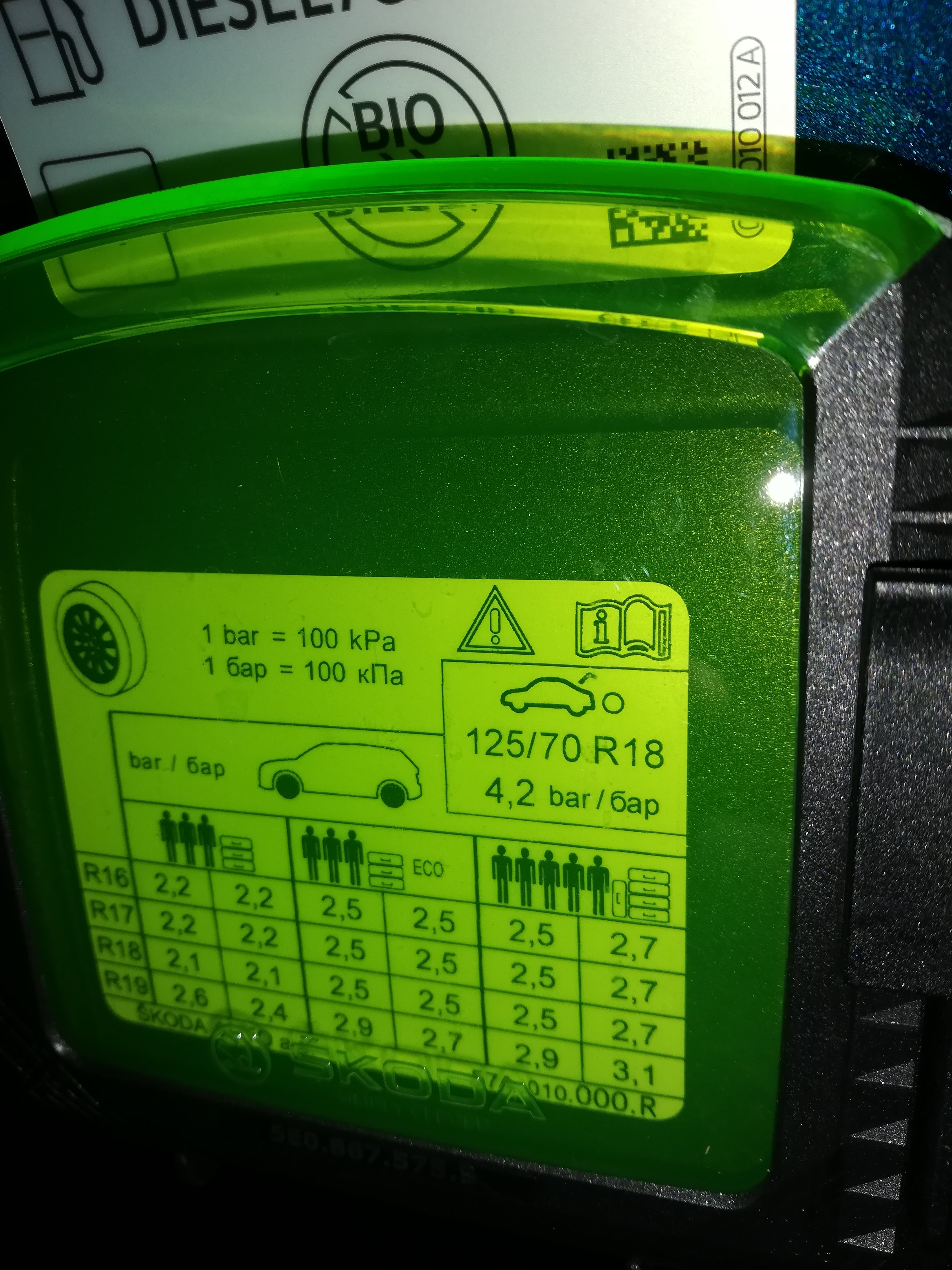

So I've just gone out to my car and this is all the info on the fuel flap and it's left me more puzzled, what should I do now? Is the standard tyre a 225/50/r18 or is it my 215/50/r18 my car was built and waiting in Germany when my dealer located it so does that affect anything?
21st century brochures are more interested in how sexy the dash can look - resembling a pc screen instead of a driving tool.
So they don’t fill the back pages with every number associated with the car spec.

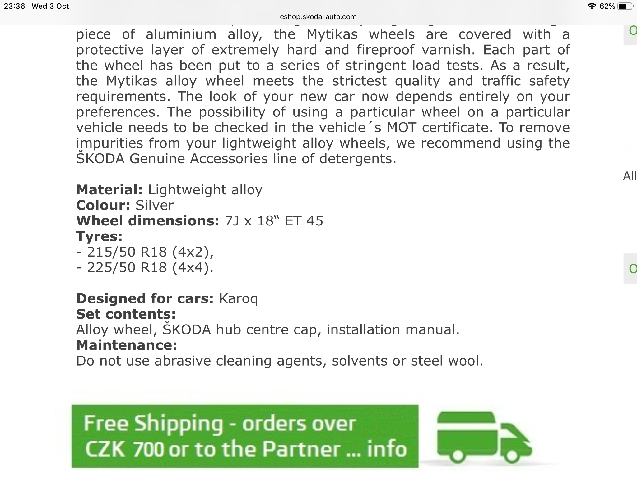

A quick dig into wheels suggests a possible simple answer.
215/50 x18 is for a 2 wheel drive while
225/50 x18 is for 4x4
Strange but possibly true.
Edited by BoxerBoy
This is correct.
As of three months ago, winter or all season tyres in those dimensions were not available. It may have changed now that winter is approaching.
