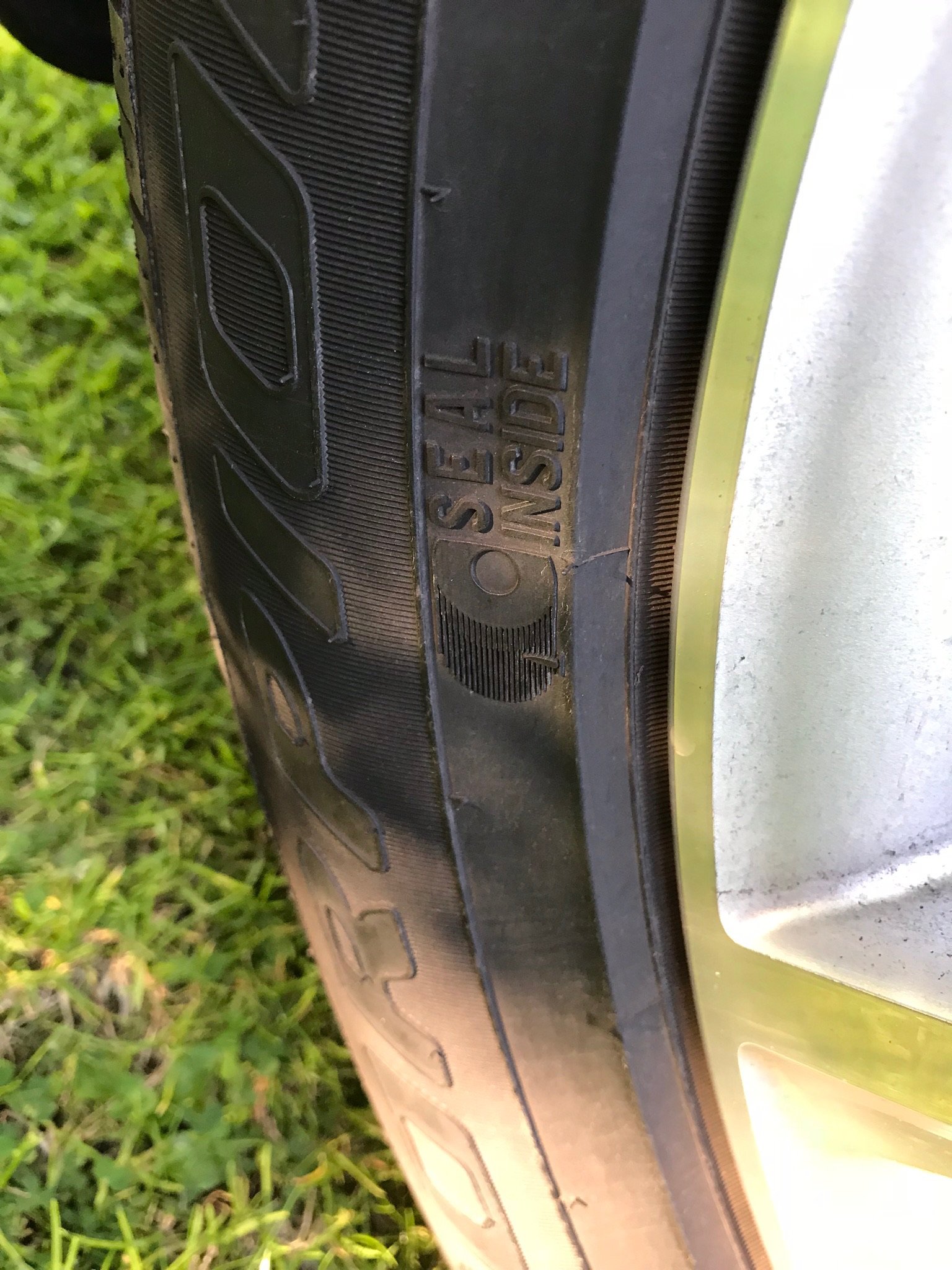

They aren't run flats, but they do utilise Pirelli's 'Seal Inside Technology'...
http://www.pirelli.cn/tyres/en-gb/car/find-your-tyres/all-about-tyres/technology-seal-inside
You should be able to see this logo on the sidewall...

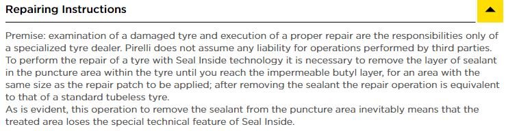

Some people say that the effort required to make a repair makes them more hassle than they're worth...

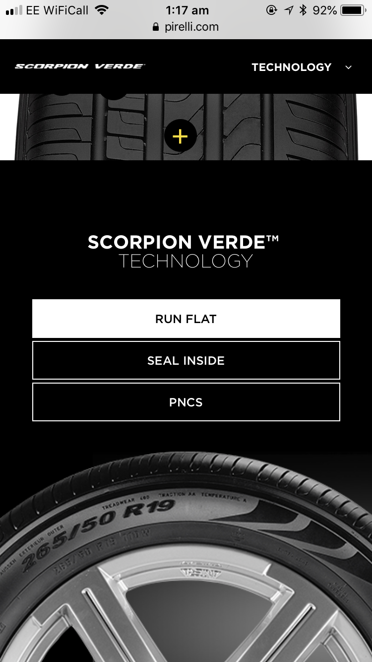

Thanks for the replies guys. I’m a Just a little confused as looked in to it further and they show as self seal/run flat for the Scorpion Verde on Pirelli’s website as they are the summer tyres and not the all season versions. It’d be a lot easier if they had a spec sheet or better defined detail on the website. Was just hoping someone would have a definite answer or a link to the tyres spec sheet etc but everyone’s comments conflict slightly. Thanks for everyone’s advice. I’ll email Pirelli and see if they’ve got a detailed spec sheet and I’ll share it here.

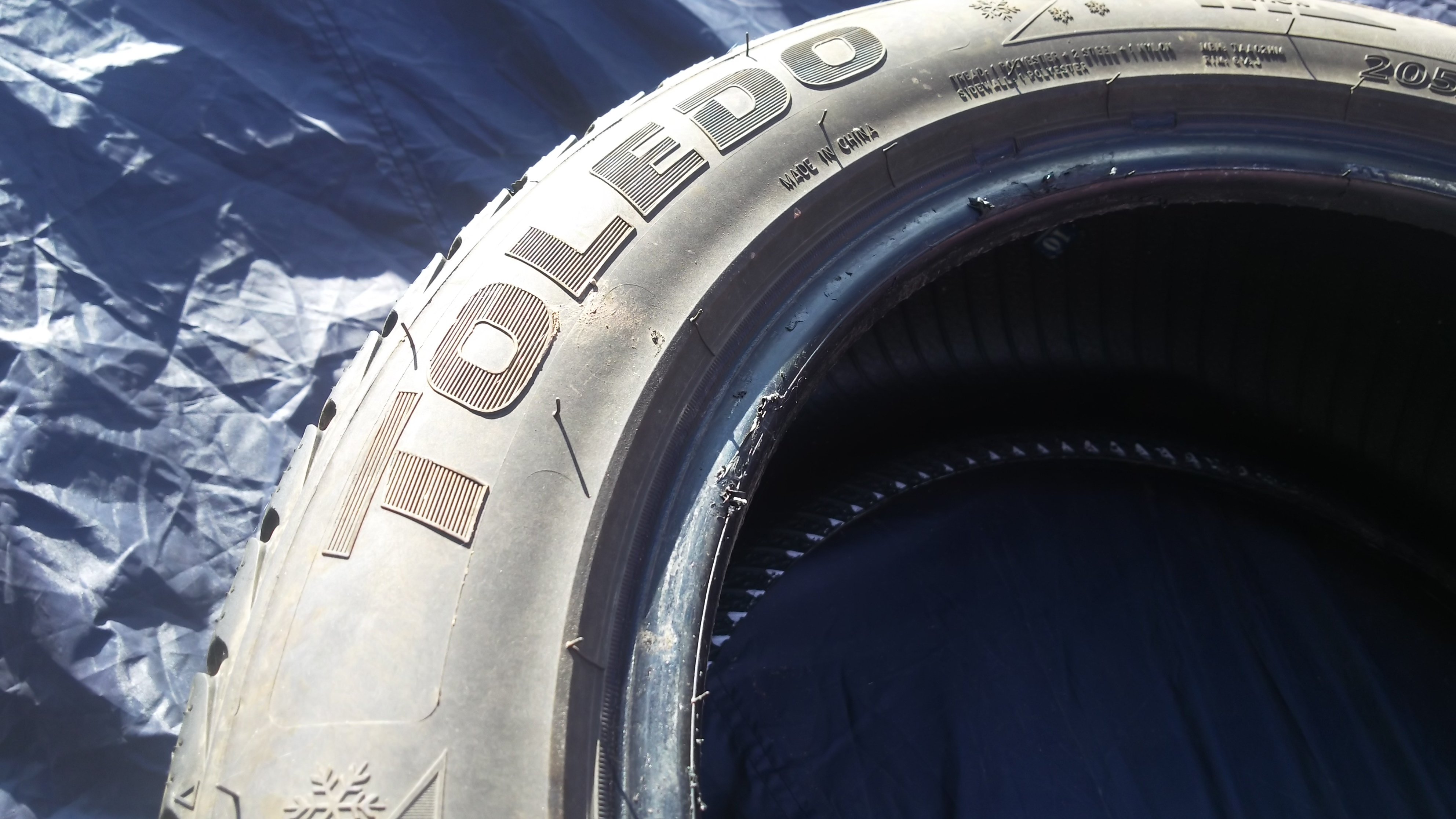

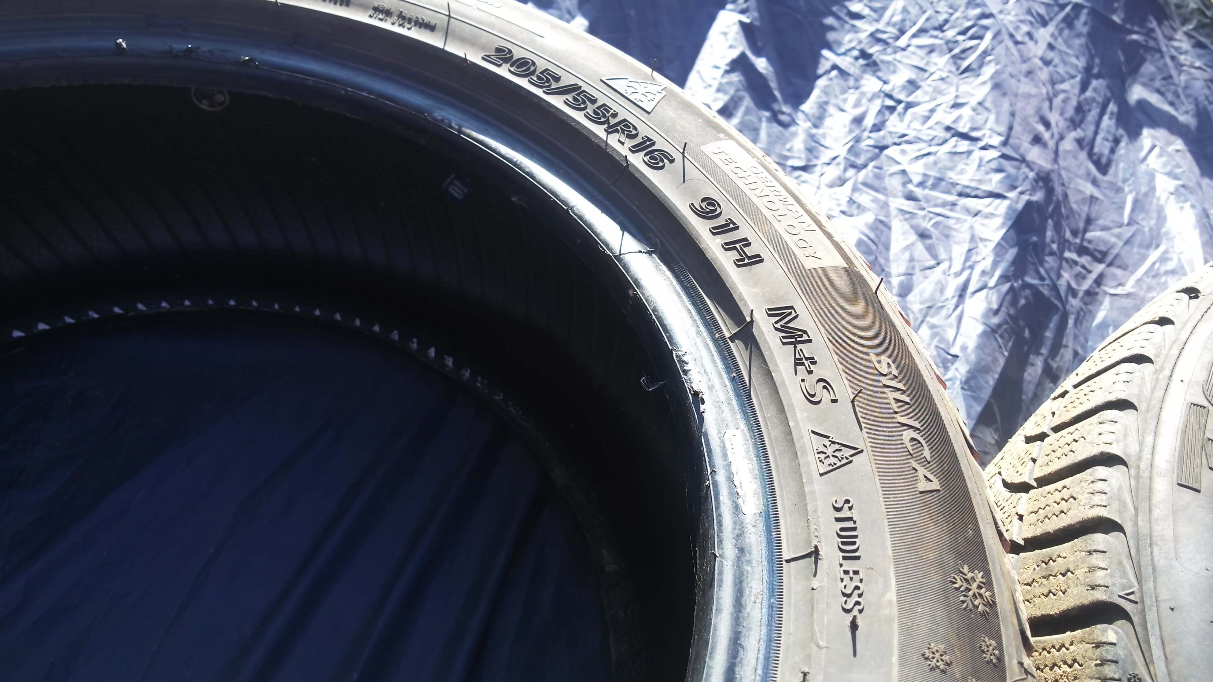

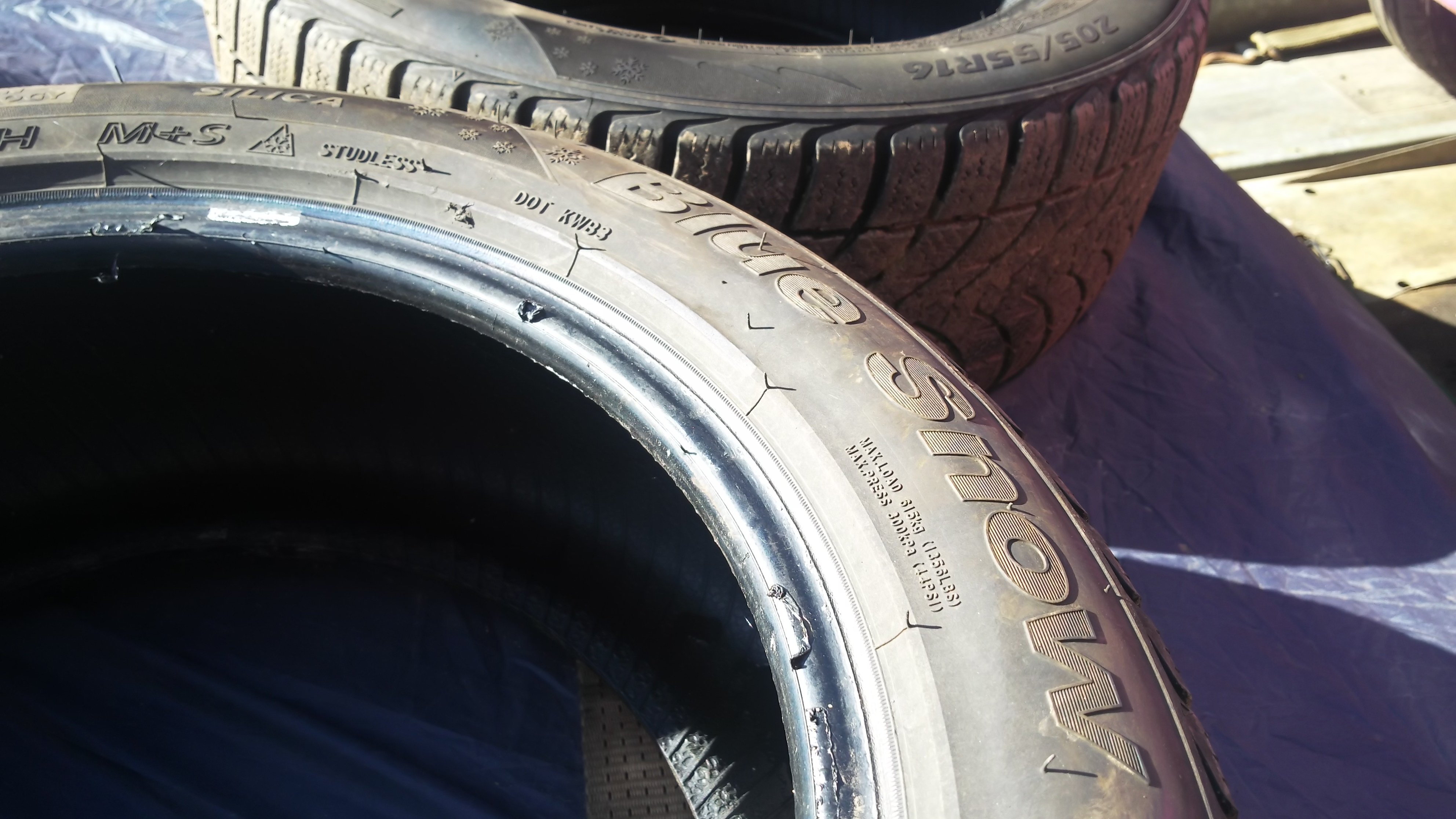

All the info should be on the sidewall of the tyre.
Take some pictures if you can.
There is a big thread on 'All Season tyres'    & Lost in Translation.   German to English or American English.
Some All Season tyres are Summer Tyres, after all VW Group import to the UK 4x4 / AWD and other cars to use all year on Summer Tyres. All Seasons.
'All Weather Tyres'  is a pretty good term.   Michelin CrossClimate are 'Summer Tyres' with Winter Certifications,  ie All Weather.
Their are 'Winter Tyres' & there are Snow Tyres.  there are Snow Flake Certified tyres and there are M&S Tyres that are not Snow Flake / 3 Peak Marked.
There are Brochures that says vehicles have All Season Tyres and they arrive on Summer Tyres that can be use All Season but might be crap in European Winters.

The scorpion verde fitted to my SEL are definitely seal inside and are summer tyres not the all season or run flat versions linked to above.

Oh, and to keep it vaguely on topic, our Kodiaq also came with the Verde summer tyres that on ours at least are definitely “seal inside” and definitely not marked as “run flat”.
