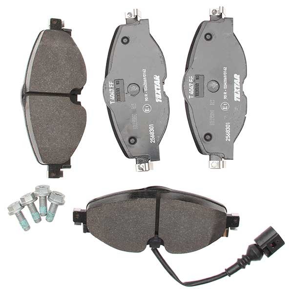

Pagid discs and pads are my go to choice. Good value and high quality exceeding the OEM fitment by a quite a margin.

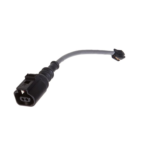

Watch out for the wear sensors as they  become brittle and crack when removing them. Best to disconnect the wire and remove the pad and sensor together, give the a good spray with WD40 then gently ease them out with a small screwdriver. Buy the sensor when you get the discs and pads. If you don’t damage the sensor removing it, you can always return the new one anyway but don’t need to run out to get one mid job if you do damage it.
??? The wear sensor is built into one pad in the set (a wire embedded in the pad material) and is usually mounted on the nearside inner position. Not all cars use them so check your car physically has one.
If you buy pads with sensor, and the car doesn't have the connector to plug it into then just simply snip the wire off.
Edited by xman
No need to be confused. The wear sensor is usually a clip in unit that can be reused if not damaged as per the pic below.
