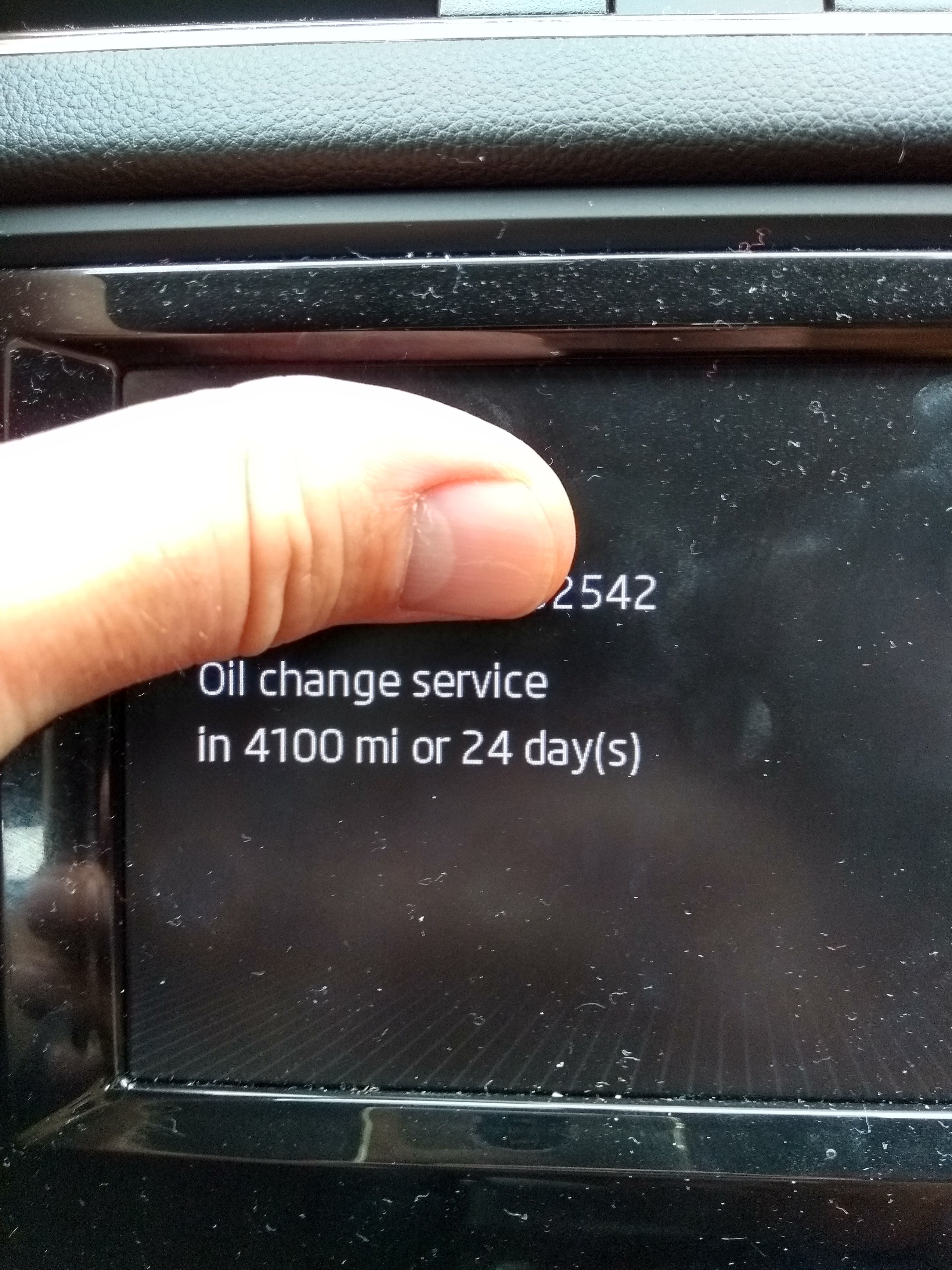

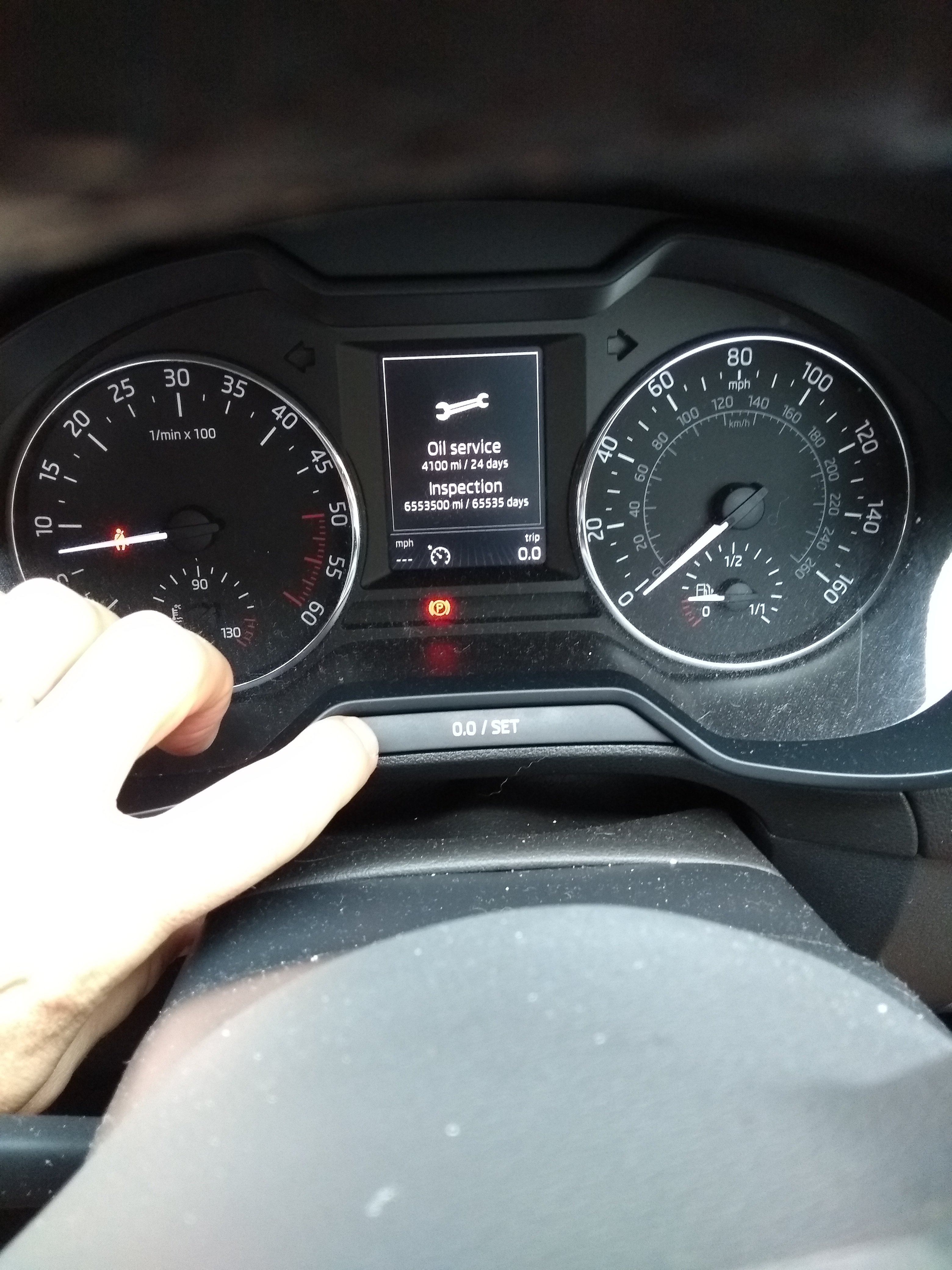

Now, at 21,760 miles display is telling me Oil Service required in 24 days. So, 5 months and 2,392 miles since last oil change.
Is my assumption that the Nissan dealer didn't/couldn't reset the oil service monitoring system the most likely reason I have the warning displayed now?
(BTW when I look on the display for next service required it is 65555 mi 65555 days).

Thanks for the replies. @nicknorman Yes, it maybe that the display is showing 65535 - I will re check!
No, I bought the car from Confused.com Car Sales who just sourced it from that dealer. Not sure I have any recourse after all this time.
Are you saying that the fact the display is showing the max value means that the variable servicing is not set up (neither is fixed), or is that what it shows when variable servicing IS set up (as I wouldn't expect it to show a "days until..." if the car just calls for it when it needs it)?

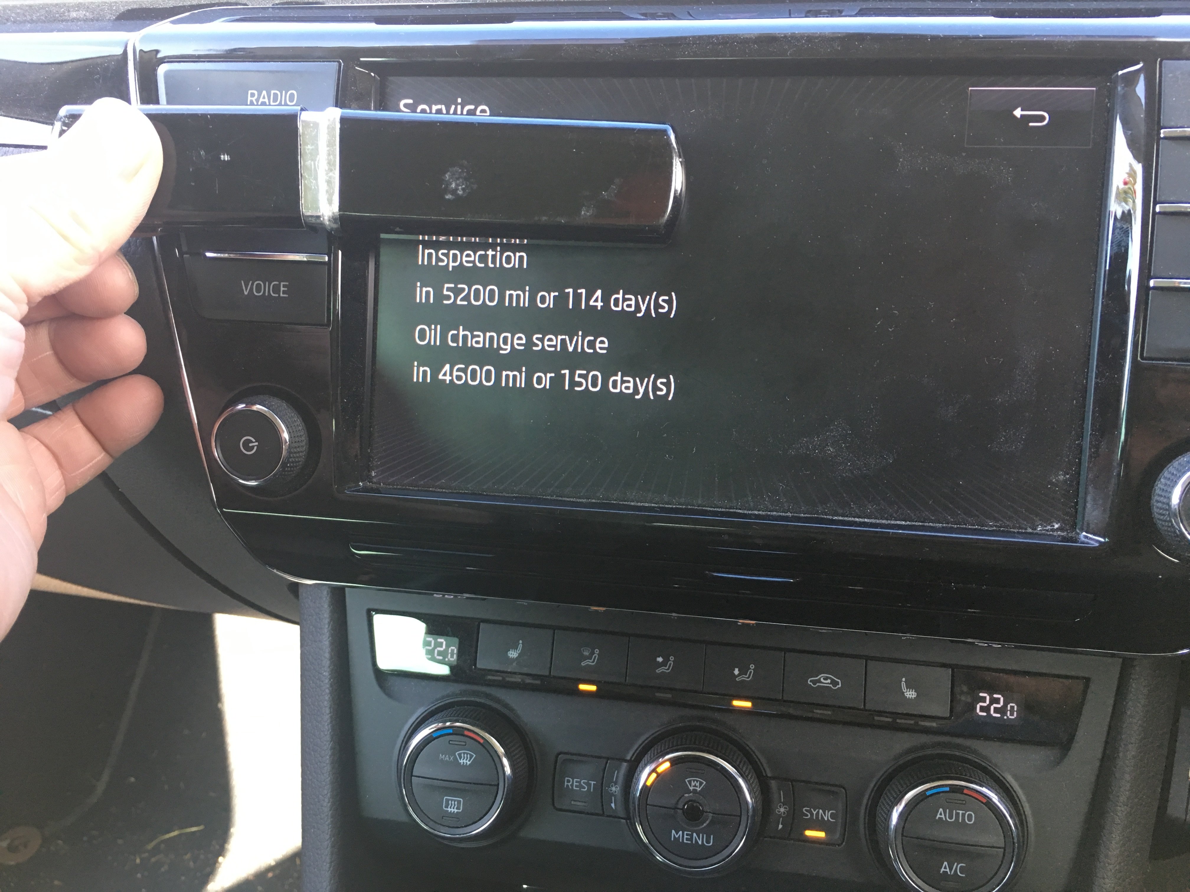

When variable is set there should be sensible readings for days and miles. The miles can change according to usage as well as miles driven, but I’m not sure whether the days do, I think they just count down normally. My 2016 Superb is set for variable and it looks like this:
Pretty sure the days should show 730 or thereabouts after an oil change ( 2 years) as that is the maximum service interval on variable regardless of mileage. Obviously you have to have the service done when you reach the first of days or miles limits.
Edited by nicknorman

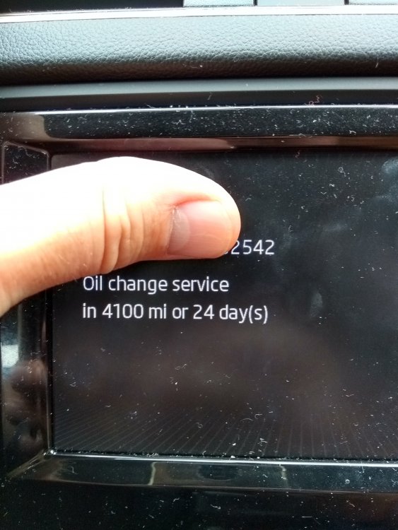

Cool, thanks for taking the trouble to do that. Interestingly my multifunction display doesn't show any info for the Inspection, it only shows oil change service.
Only the instrument cluster display shows both.
See pics.

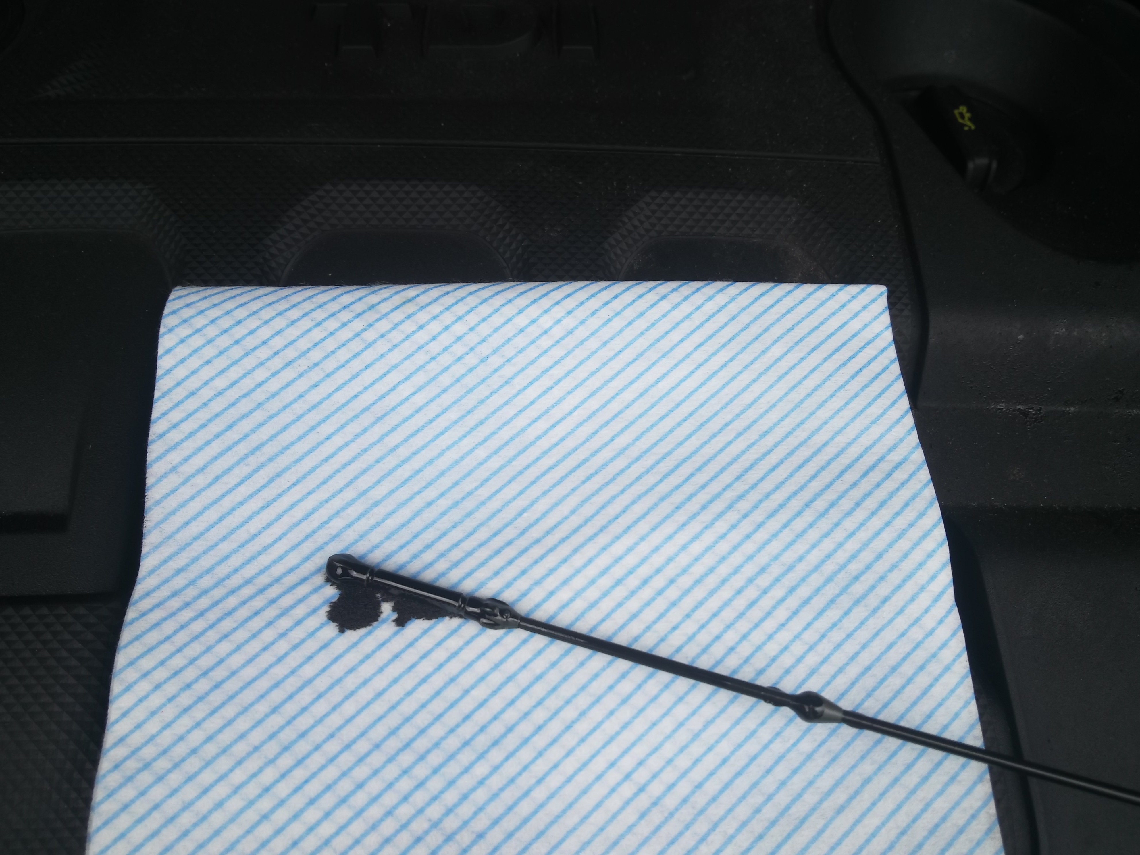

This VW 507 in a TDI leased car on a Service Plan  that had done 18,000 miles and 3 litres topped up in that miles & it was like clotted cream and showed Service / Oil service in 500 miles,
it was another 1,000 miles before the main dealer could take it in.  How bad has the oil to be to reduce the miles / km to a Service?
Doing better MPG since the Factory oil was changed....

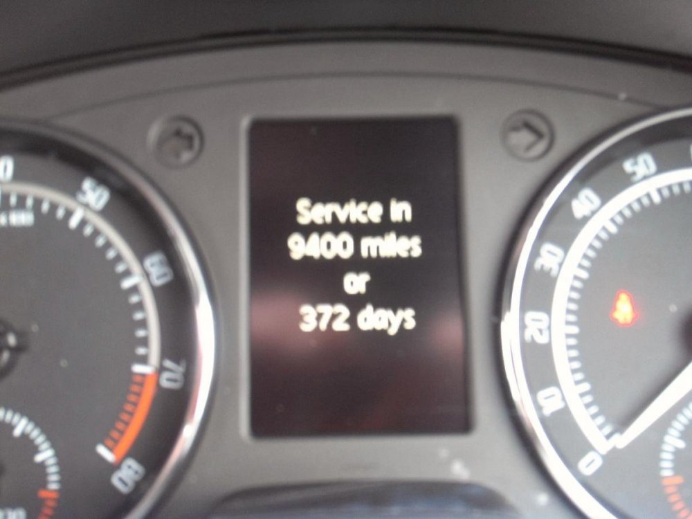

A VW Group Fixed Reset in the UK comes up as 9,400 miles / 372 days.   Not seen any show as anything else.  not 9,300 miles.
Maybe others have.
One year and a week, allows for the PDI to delivery and possibly a holiday, or so i was always told. Maybe a myth.
