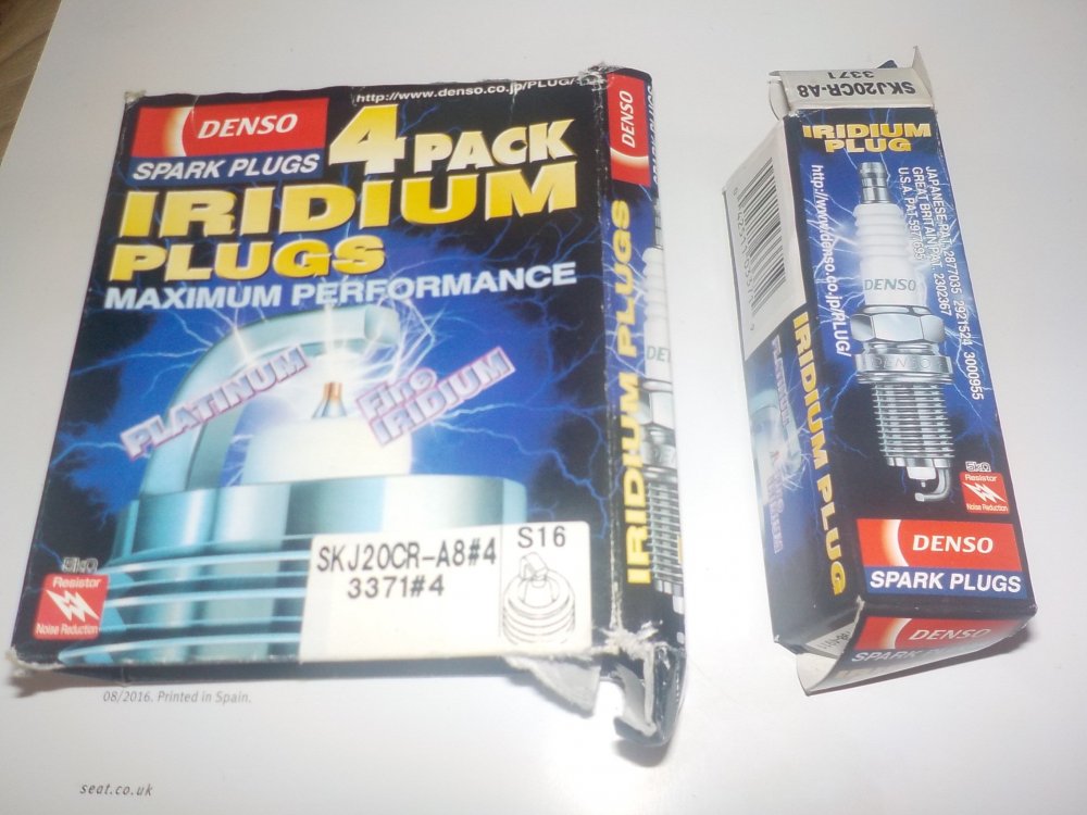

Have you used Denso Plugs?   I would try them,
but there are some that have managed to burn out a DENSO, be sure they are not Fakes you get.

Bottom the OEM NGK's at 25,000 miles. Top DENSO ifrom same engine @ 30,000 miles.
