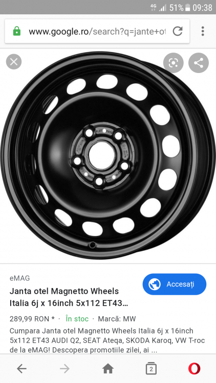

16" et 43 with 215 60 r6 fitt perfectly on karoq. Cars with 16" rims from factory have that specs. My spare wheel is steel on 16" with specs from above. For winter i bought these
