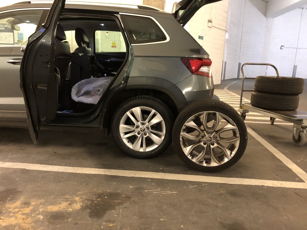

Living in the Cairngorms and having had our first sprinkling of snow last Saturday I decided to put my winter wheels on today.
I've got the 2.0 TDI SEL 4x4 and put on 215x55x17" replacing the original 18"
First impressions up the Lecht road were very good.
Will report again once we've had some decent snow to play in.

I have a 1.5tsi sel manual Karoq and I have fitted a set of falken 215/55/ r17 hs01 winter tyres on a set of spitzberg alloys which I had on my previous yeti, first impressions after 100 miles is they are quieter, better in dry weather, better in wet conditions and only slightly worse on fuel economy than the Bridgestone tyres that came fitted to the car. I will let you know how they perform in snow if we get any this winter.
