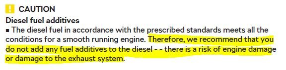

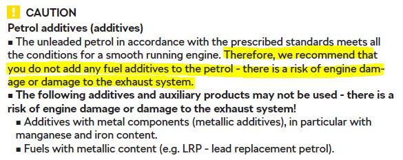

Use of Petrol Additives:
Use of Diesel Additives:

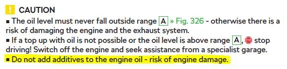

Use of Engine Oil Additives:

Also Skoda say don’t use additives, so I would be very interested to know what they used to flush it with. Especially if you have a dpf.

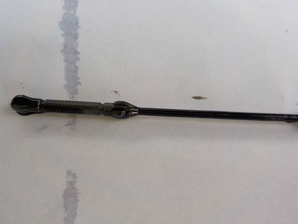

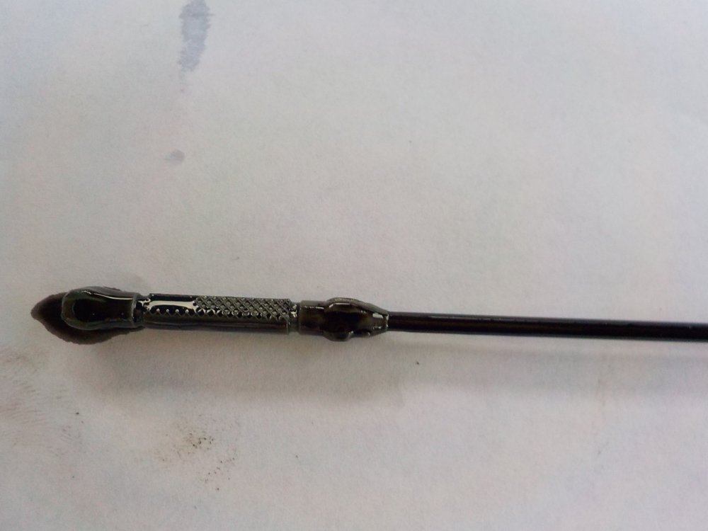

VW Group dipsticks are crap.   Simple really.
Not all cars even have the correct dipstick on occasions as one gets replaced.
There are engines with the same sumps and different oil capacities that have the same dipstick, and the VW / Skoda diagram on 'A', 'B' & 'C' areas are crap,
and i know where 3.6, 3.9 & 4.2 litre shows on 1.4 TSI / TFSI 132-136 kW Dual Charge Engines at different temps and times after stopping and with different oil filters.
I have seen many many overfilled at Services and at top ups.   Got the pictures and the amount of oil drained weights as well.
I have checked replacement engines that have just left Skoda Main Dealers after a Warranty paid near £5,000 an the oil was overfilled.
Others have left services with 3.6, 3.9 or 4.2 litres of oil in.
*I have check cars on forecourts or at auctions with the oil cold near or at the top orange marker.*
I put 4 litres in my own Twincharger engines & recommend others to use 3.9 litres rather than 3.6 litres & 5w 40 FS rather than 5w30 FS LL.
But then that is from experience.
Edited by Offski

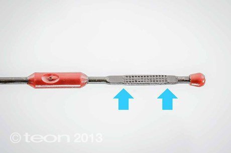

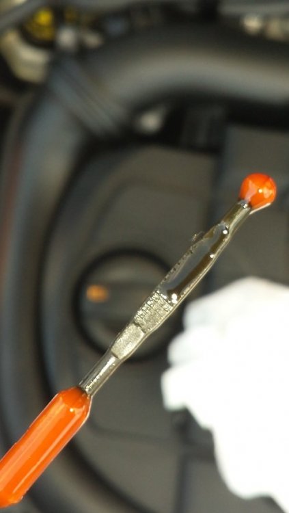

46 minutes ago, Offski said:
nidxa,
Better than on my ex Alfa.

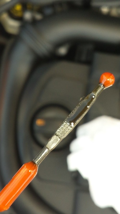

Stick is good enough to show different oil levels under various circumstances.
I suppose stick shouldn't show ever more then MAX? Is this right? --> If so, clearly determines that measure takes place at the point of time when the volume of the oil is maximal and settlement of the oil is finished. This is my magic 15 minutes after good long ride and warm up.
