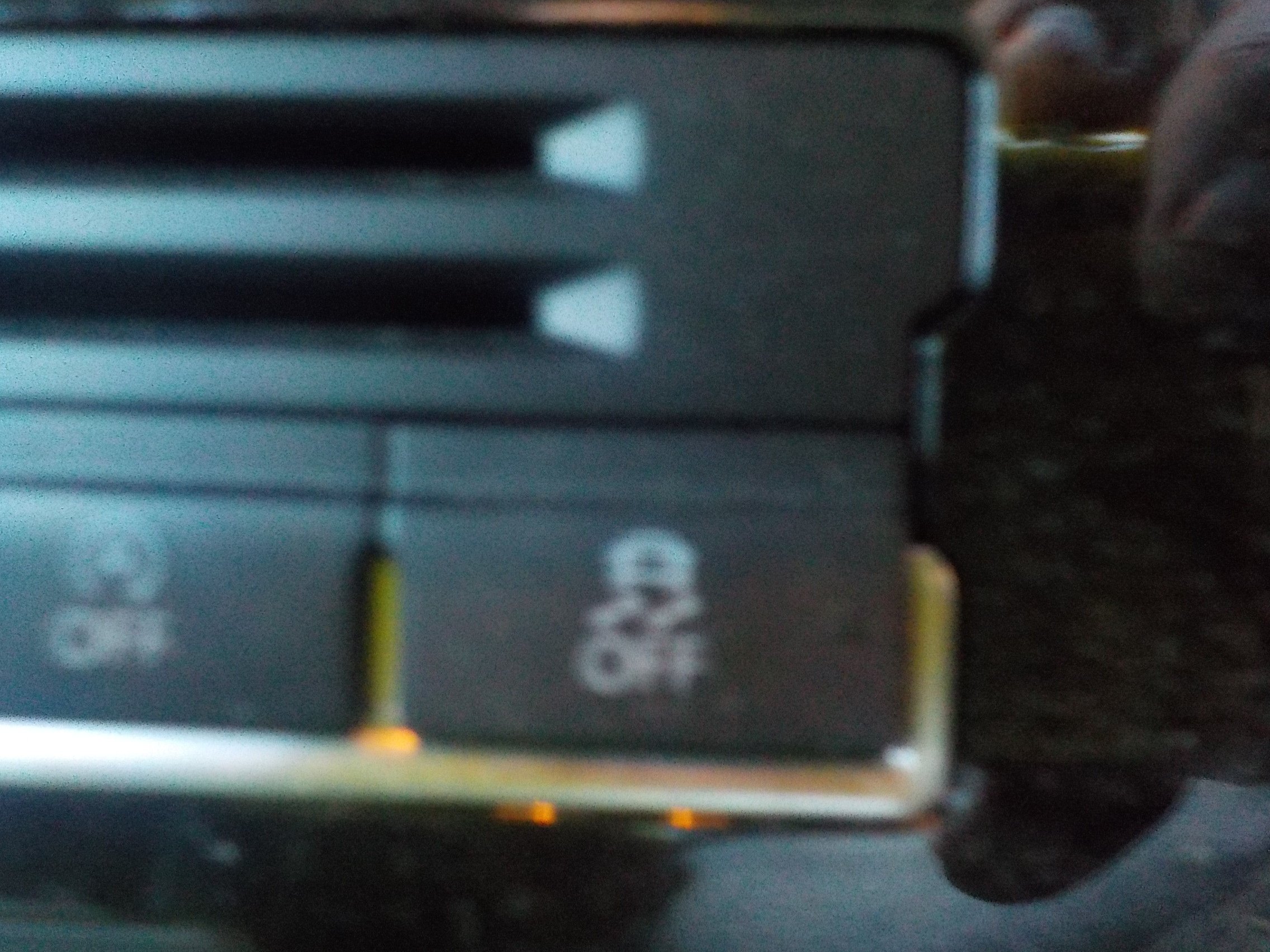

'09 irish Ambition spec MkII I have and the ESP button on the dash beside the heater controls.
Is that only putting off the front ASR and not the ESC / ESP at the rear?
Anti Slip Regulation / Traction Control off,  to get moving out of snow etc. If snow chains are fitted or for other reasons.
'ESC'  Electronic Stability Control / 'ESP' Electronic Stability Programme.

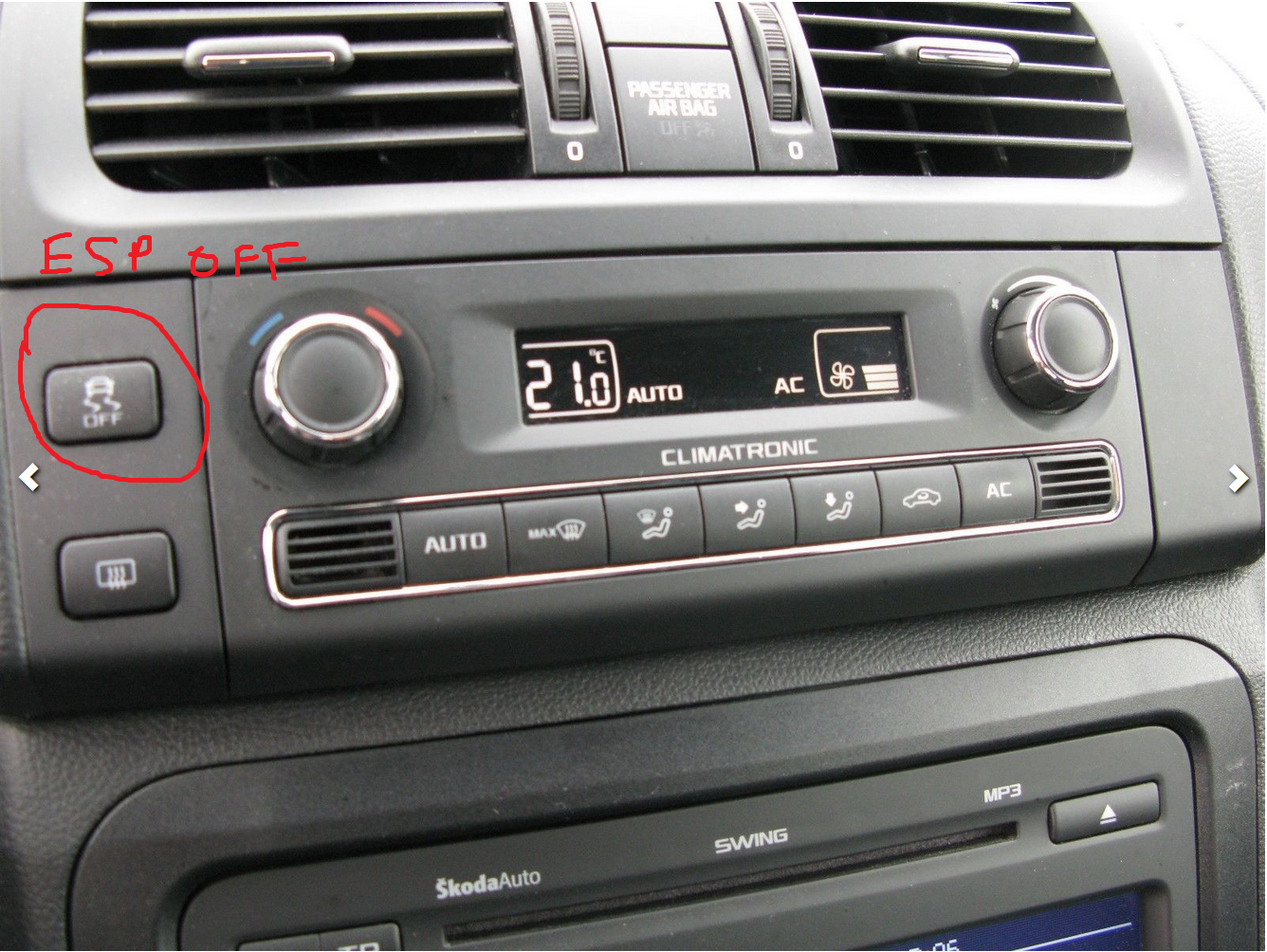

Offski is right, but I think we are splitting hais at this point. My own car in made in November of 2010 and it's a Facelift. I was talking about the rear defroster button. If your car does not have ESP, that button is missing. Like they say, a picture speaks like a 1000 words. This is from my car:

Yes, mate. I was talking about the button itself has the ESP lettering. The MkII pre-fl went very cheapo after the MkI, so they must have had a heap of those buttons left over. Same thing with the rounded heater knobs, I hated them so much that I got the fl's oblong shape ones, it was a straight fit.
All in all, you are right about what is button for!

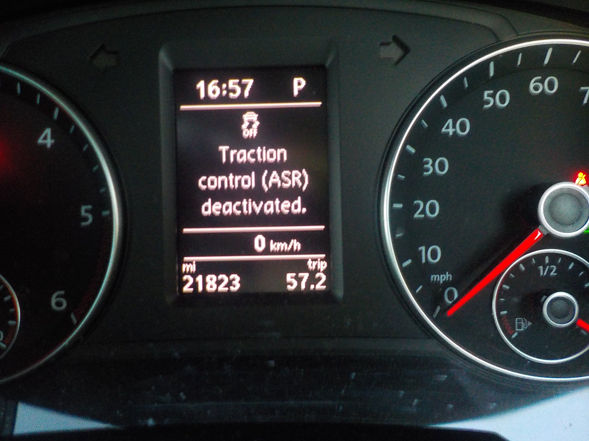

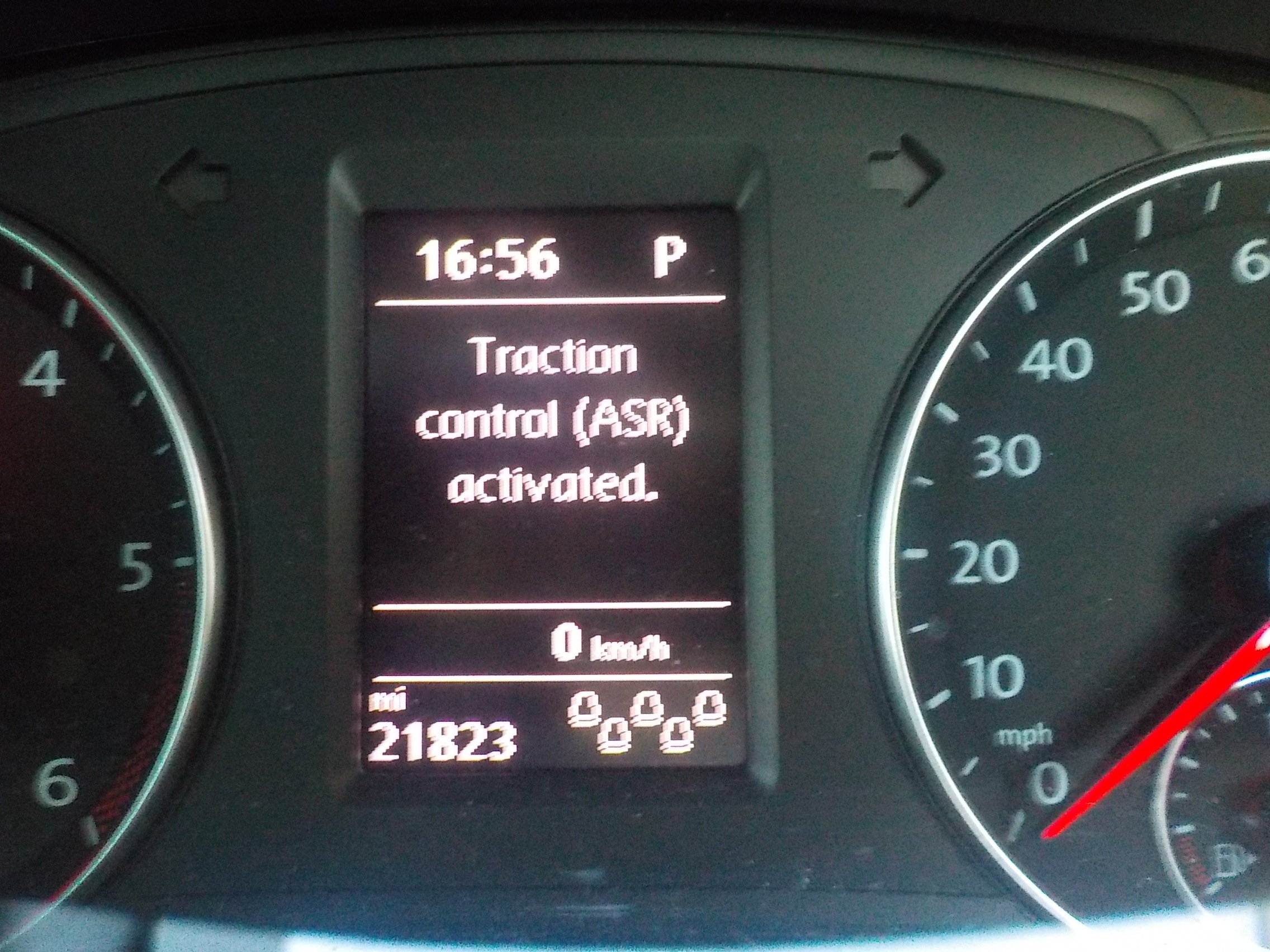

Point being it does not have ESP disabled only the front part, ie nipping brakes which was ASR / TC.
Things got and get lost in translation, with Owner Manuals, and Buttons and even symbols.
Someones car has ESP / ESC and a button they think puts it off, but the Traction Control / Anti Slip Regulation is being switched off of a FWD while the ESP / ESC can still be enabled at the back end.

My fabia has both ASR and esp. you can turn off asr via the button but not esp as that stays on. Only way to take it off is pull the fuse but the same fuse also does abs and I kinda like that.
