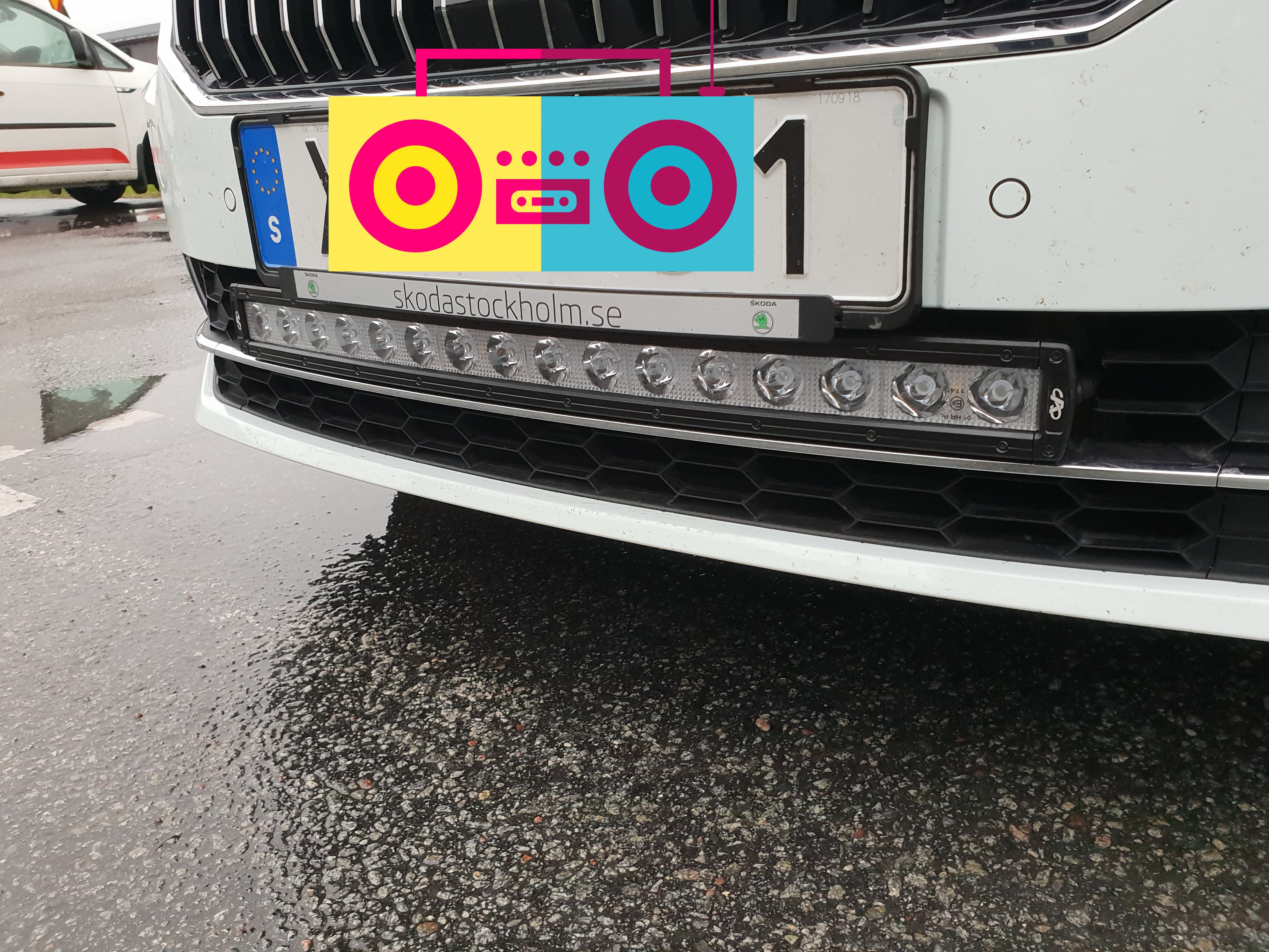

What is your wiring setup? You added an extra button in your cabin?
No extra button for this - firing of together with high beam. It would be easy to add a button though.
For the photo I removed the fuse and covered the headlights for bar photo.
What number/colour is the signal cable to the highbeam? Did you use the Canm8, XBB or some other unit?
I actually don't know. Had a shop to install the bar as it is a company car.

What brand / model is the light bar?
What have they fixed it to?
What type of brackets / fittings did they use?

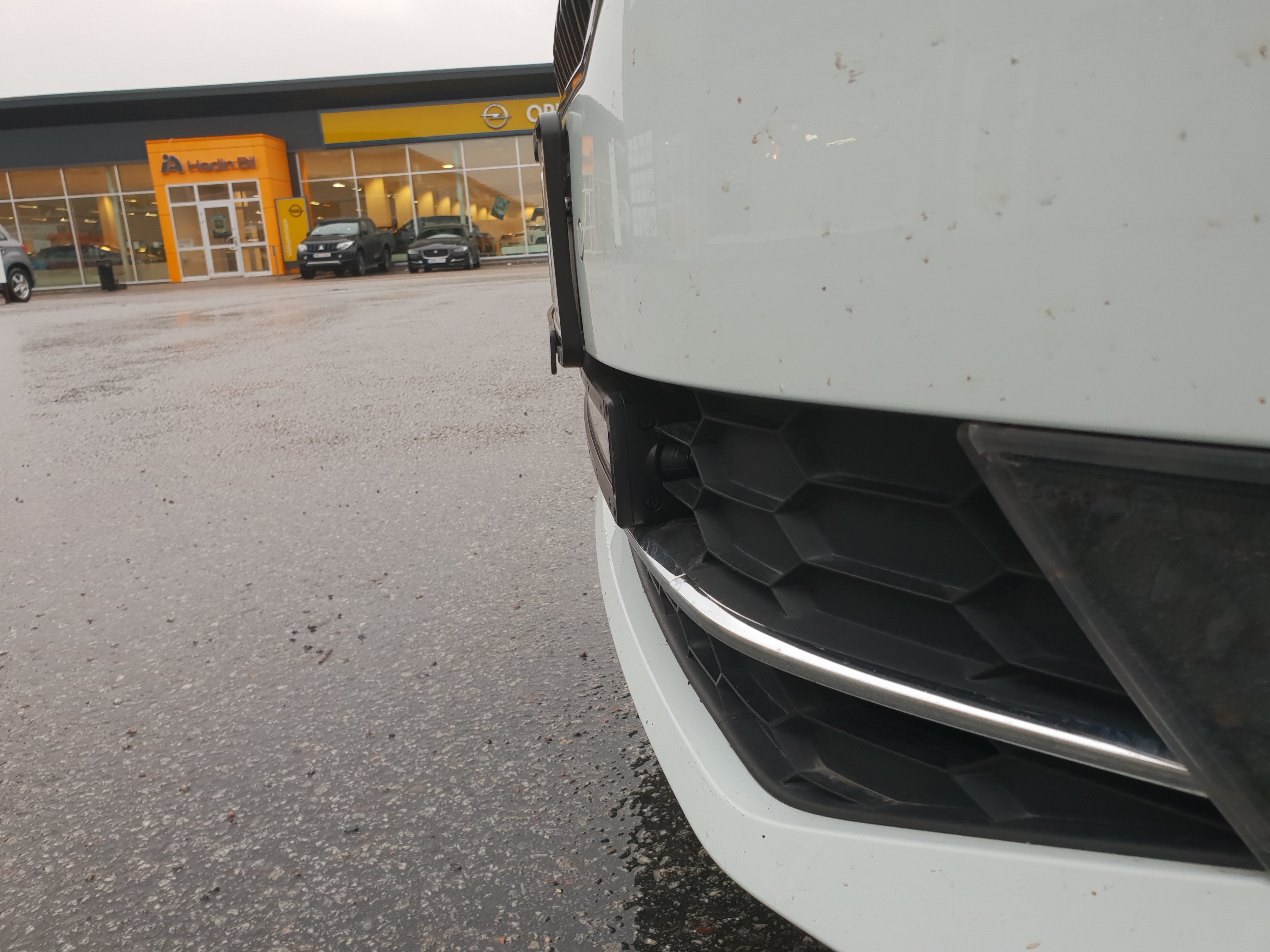

The light bar - It is mounted with a canbus canceller, with a piggyback on the signal for high beam.
Brand is "CAD" and from what I can see it's a high quality Chinese product.
Brackets are mounted to the collision beam in front of the radiator (as they told me anyway) and the brackets sits on the back of the bar instead of the more common sidemounted bracket.
This thing is rock solid and won't move a bit when pushing it.
But I want to be clear with one thing, this bar has quite a good spread of the beam but it still gives you a really bright spot right in the front of the car so when turning the bar off it gets really dark. It's mounted so low that it is practically impossible to avoid this no matter what bar you buy.
