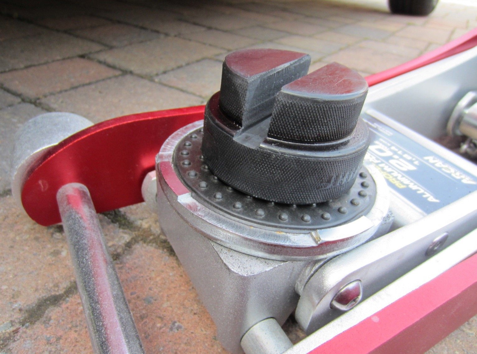

Get yourself a jack pad with 20mm deep slot if you plan to raise the car regularly. This engages properly with the sill for jacking with a trolley jack. The onboard jack (aka widow maker) isn't really to be trusted unless you're on level ground, car in gear, etc.
Back to the drums. They are an absolute pain. At 42k miles I suspect they're using original shoes. The shoes can develop a surface glaze over time. As the drums are also prone to condensation, the springs and handbrake arm on the shoe deteriorate or seize. It's worth removing the hub to see the overall condition. I also know the wheel cylinders can fail, check for tell-tale brake fluid crystallisation.
If rebuilding, then shoes are cheap enough. Use a new spring kit too. One thing to note, as car gets higher mileage then hubs will develop a lip inside. Easy enough to remove with a 3M abrasive wheel flap accessory on a drill. At 100k miles, you may need to replace hubs and new shoes can't make up for the material lost on the hub, hence its is a losing battle to get them to engage properly or reduce handbrake travel, regardless of how much adjustment is made at the cable.
Never heard of a Jack pad. Sounds like an excellent idea.
Where can I you get one from Spartacus buddy.
Mind you the boots not huge!
I have used Spartacus when booking a table or whatever.
When serving folk call out my name
"Mr Spartacus"
All folk reply,
I'm S............s
Also similarly, sometimes,
Mr Allc..k
Jack pads can be made up to suit the profile of the area you are jacking under, I just fabricate them from wood and buy a small sheet of suitable rubber to screw down on the top and thinner rubber for lining round the slot cut to clear the folded sill welded areas.
My wife's current 6C Polo is a nuisance as the area near the folded sill welded areas is stepped so I'll need to make up another set as my Audi S4 set with the standard narrow slot has ended up ripping/tearing the stone guard paint coating a bit on the outer sides at the front, very annoying, I must try harder.
You can buy "rubber" jacking pads which might just be ice hockey pucks with a slot milled in them.

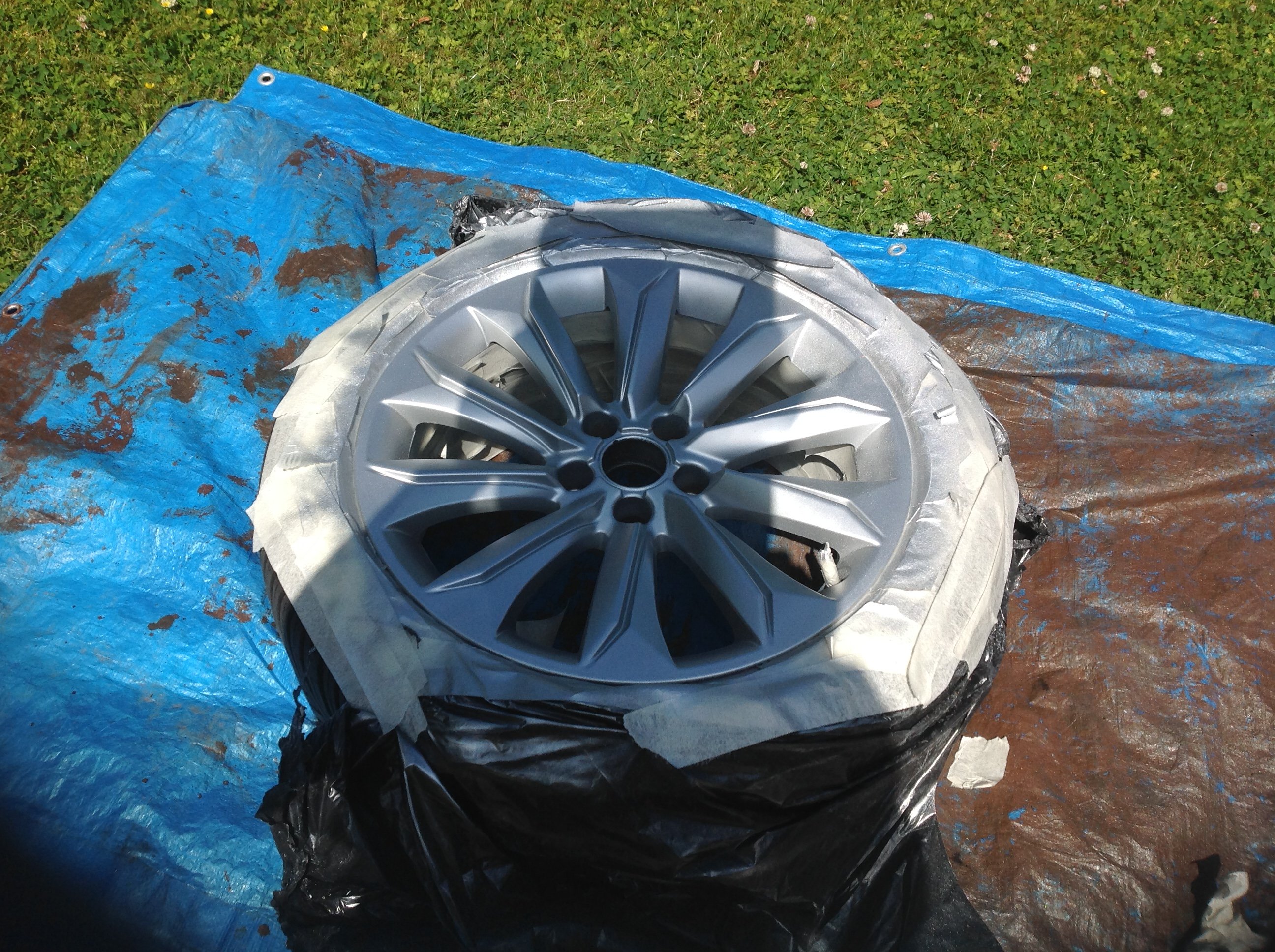

Another topic, alloy wheel finish repair.
Looks like some bright spark has dribbled brake fluid onto the wheel finish next to valve. The flat inside edge close to a stick on wheel weight.
About as round as an apple. Rubbed the bubbling with a sponge and bits of paint are peeling off. So if I slip the wheel off, rub it down with sand paper then spray paint to cover, this will do.
You can't really see the damaged paint too easily. So what is the right kit to buy for the repair please.
5 hours ago, john1brittain said:
Spartacus and best new buddies.
Not really worth repairing professionally unless you kerb it. I run an A4 Allroad and lightly glanced the kerb earlier this year  turning the car around in front of my house. No physical damage other than scuffing it. Pretty sure all VAG cars including Skoda use Wurth alloy paint for an exact match.
Remove the wheel. Sand the affected area back and flatten down using wet 3M paper with a little detergent, 800 to 1000 grit. Make sure the wheel is spotless, including the inner rim. It's not ideal spraying at this time of year given temperatures and air moisture, but needs must. If you can spray in a garage, make sure the door is open for air circulation. Mask of the tyre. Before spraying, ensure the spray-paint has been thoroughly shaken and is at room temperature. You can float can in hot water, or leave on a warm, not hot radiator. Before spraying, wipe the alloy down with Halfords paint wipes.
If you're not used to painting, then use light strokes in the direction of the spokes. This may take 5-6 coats to go opaque. Allow 15-20 minutes between coats. After the last coat of the silver paint, allow it to dry, say 5-10 minutes, then use the clear lacquer which effectively fuses it to the base coat. Lacquer is a dark art with the risk of drips, so same rules apply. 3-4 coats until you see a gloss appear.
Paint here:  https://www.ebay.co.uk/itm/WURTH-German-Alloy-Silver-Wheel-Paint-LacquerS-WURTH-CLEAR-TOP-COAT-LAQUER/190693032823?hash=item2c6630c377:g:SeEAAOSwVWFao-xF
Edited by spartacus68
Outstanding!
Thank you, exactly what I needed to know.
The shiny side is alright it's just the inner flat edge that's corroded.
