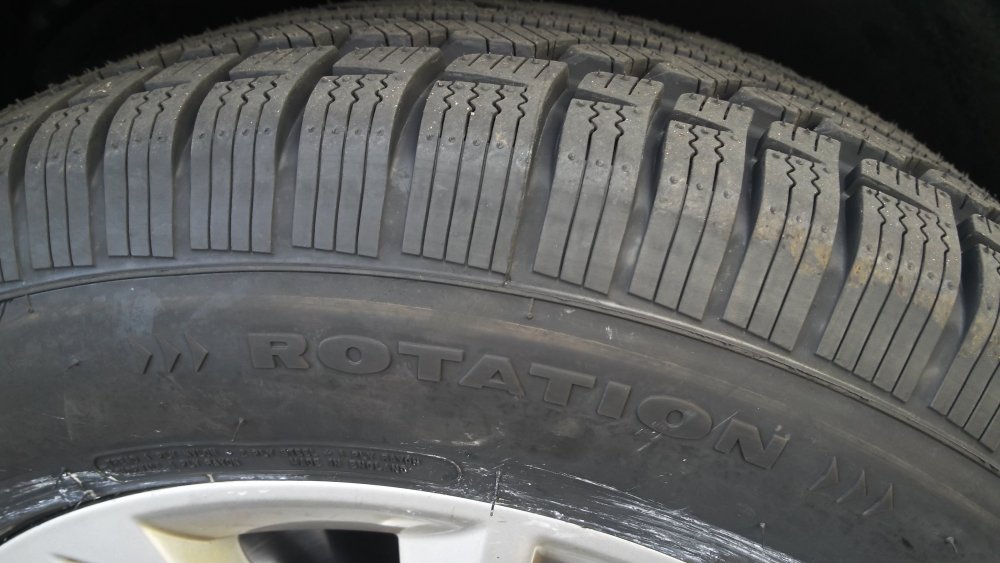

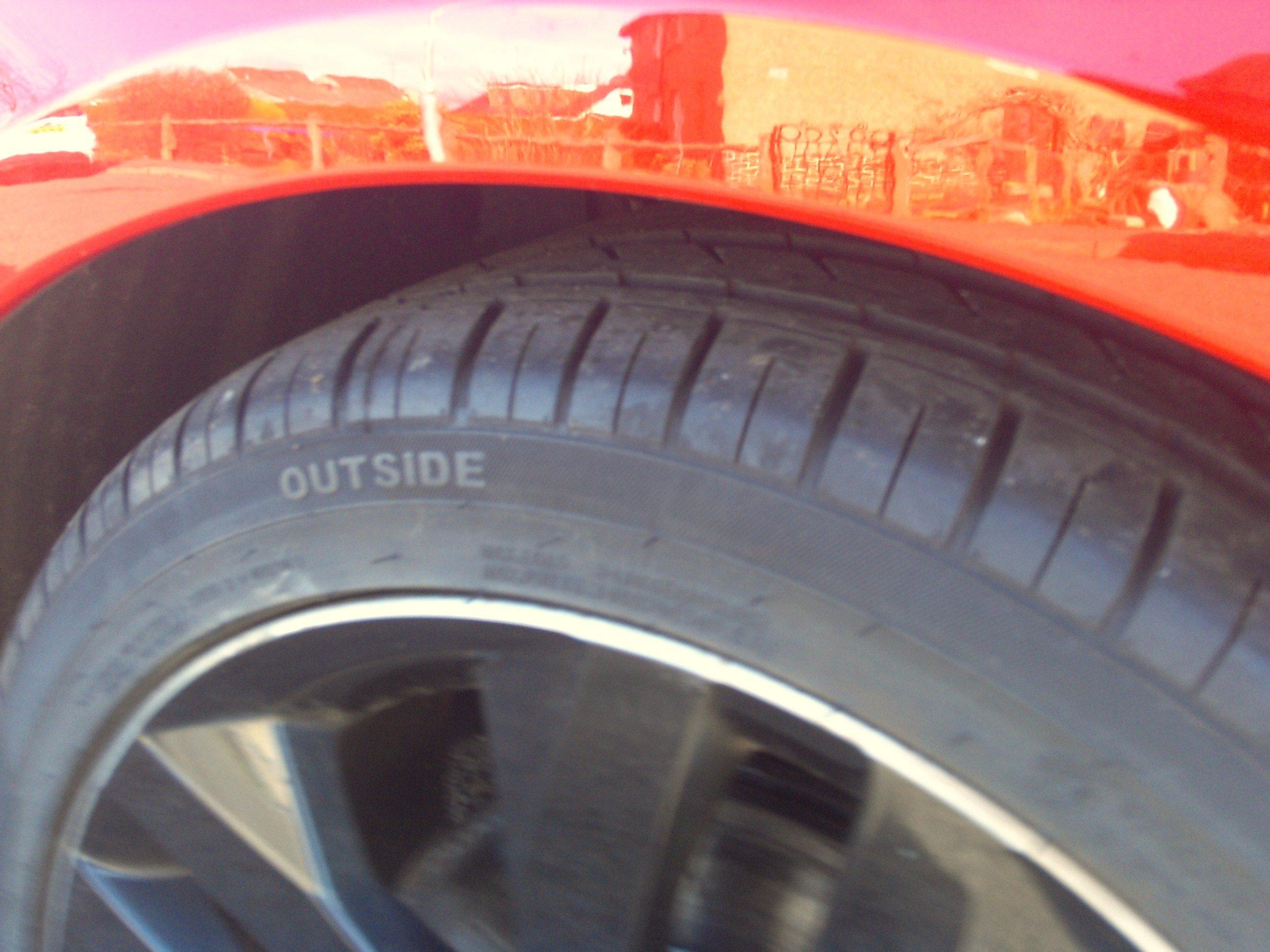

Check all 4 tyres are on the rims correctly, the direction arrows going forward or 'outside' on the sidewall showing.
There are run out stripes on the new tyres but there should be no issue incorrectly matched since these are Winter Tyres.
DSCN0331.JPG.5487eb8ac8c1f58c4646869245f2588a.JPG.2dbbca9254cd222861cc1fcdbf03fb5d.JPG.efe0e4bac14bae4286756e98f9214eb5.JPG
