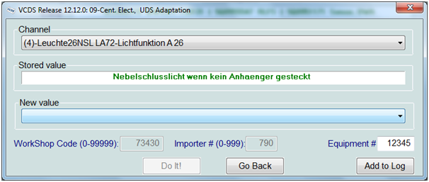

This worked on my 2015 build Octavia Estate which had non-LED rear lights:
Controller 09 - Central Electronics
16 - Security Access - enter 31347
10 - Adaptations
Change the 2 channels listed below - scroll to just over halfway down the long list of adaptation channels to find them. Do them one after the other, and do not come out of the adaptations until you have finished. If you do, you will have to close the controller and go back in and enter the security access code again.
You have a couple of options here - the original values are:
(4)-Leuchte26NSL LA72-Lichtfunktion A 26 - Nebelschlusslicht wenn keinAnhaenger gesteckt und Rechtsverkehr
(4)-Leuchte27NSL RC6-Lichtfunktion A 27 - Nebelschlusslicht wenn kein Anhaenger gesteckt und Linksverkehr
which translates roughly as rear fog lights when trailer not connected and right hand traffic and rear fog lights when trailer not connected and left hand traffic.  So, for use on the continent you could just swap the values over and the left fog light would light up.
A third option is available - Nebelschlusslicht wenn kein Anhaenger gesteckt - rear fog light when trailer not connected. I set both of mine to this value and they both come on, but if you set them both to Nebelschlusslicht wenn kein Anhaenger gesteckt und Linksverkehr they both come on as well.
This has been tested on LED Hatch & Combi rear clusters, and standard Combi.
Change (4)-Leuchte26NSL LA72-Lichtfunktion A 26 to Nebelschlusslicht wenn kein Anhaenger gesteckt

It's in the garage now. I guess I will find out shortly. Thanks everyone for your help.

 Thanks so much @PetrolDave. Not sure if the garage needed your notes or not, but they managed to recode my fog lamps so both work and I'm just back from a successful return visit to the vehicle testing centre with a new MOT/autokeuring certificate. We are now good to go again here in Belgium. Bedankt!
