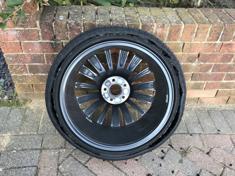

9 hours ago, xman said:
You surely must have ridden several miles with it flat for that to happen?
The TPMS Light came on a few miles before I stopped (on the M25 about 2am returning from our holiday... full boot and 4 adults)
I didn’t pay too much attention to the TPMS light as the o/s/r tyre had been giving warnings for a while (I did physically check the tyre before we drove off though)
So ultimately it was my fault the tyre was wrecked, the cut in the tyre had scrapped it anyway.
The weird thing is though the car didn’t handle and differently with the flat tyre, very low profile tyres probably had a lot to do with that.
Edited by Gizmo
