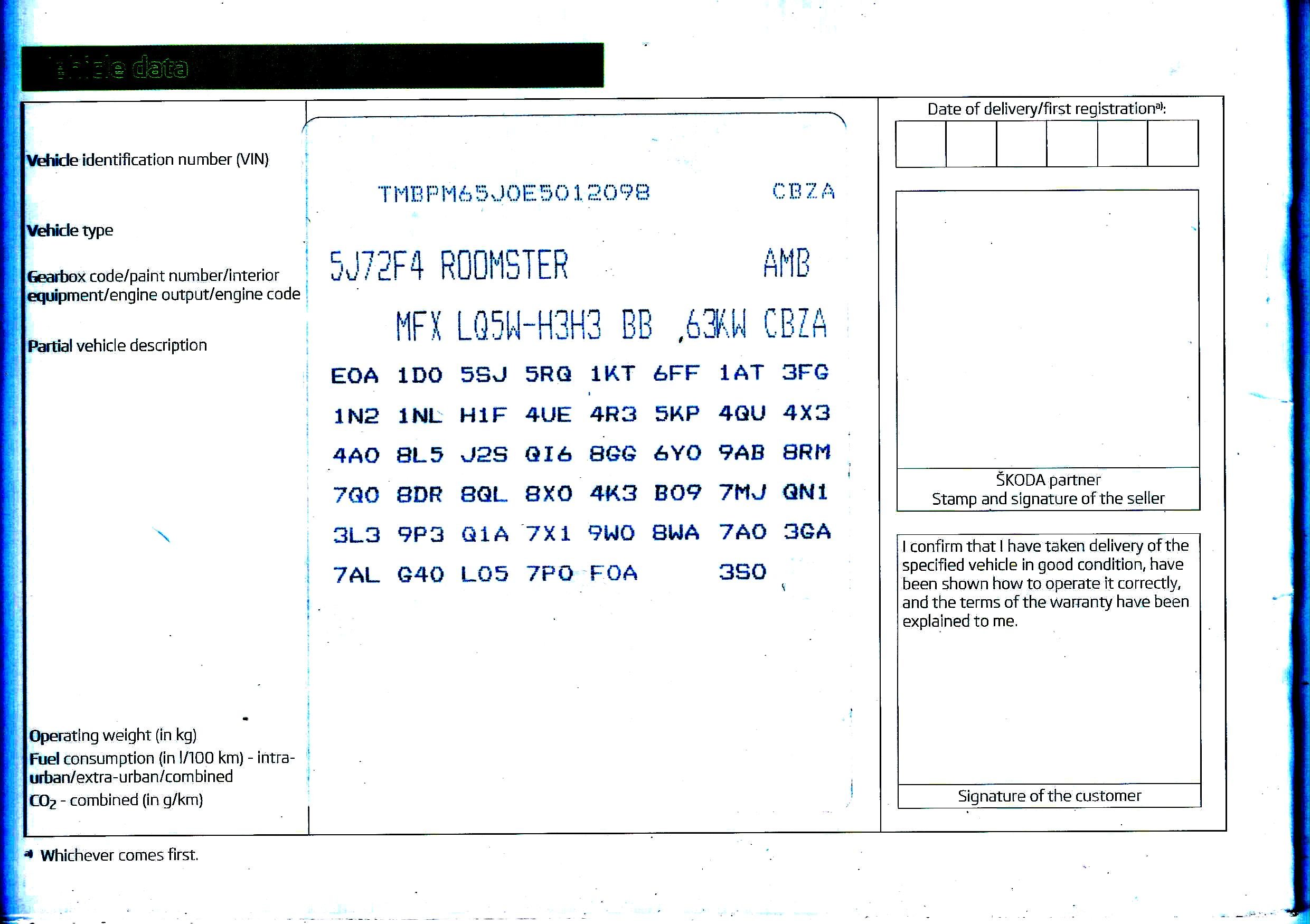

Knowing your car's engine code (and maybe putting it in your profile or signature) is a fantastic way of helping others to help you understand what you have. It's listed on the data sticker on the boot floor (and there may be a duplicate in the service book). If you can't work out which letters are the relevant ones, just pop up a photo of the sticker (obscuring the VIN if you're shy).  As @xman says, yours may well be a four-letter code starting CZB- but there's nothing like seeing it black and white to be certain.
Here is a scan of the service book entry:
CBZA engine (I got the BZ wrong way round in earlier posts) camchain, no change required unless rattling loudly. I recomend delete that scan in that post because it shows your VIN number....
Edited by xman
  • Sponsor
@aswell Brilliant, in the top line on the right, and also on the right just after 63kW (your engine's power in metric units).
Armed with that code you can go to sites like 7Zap.com and look up all sorts (everything!)* about your engine and car. e.g. this page showing your timing chain and associated parts:
https://skoda.7zap.com/en/cz/roomster/ro/2013-699/1/109-109053/
We have a mk1 Fabia on 160k miles and as far as I know it's still on the original chain and tensioner, if that reassures you at all, albeit on a very different engine.
*Edit: the 'everything!' was a bit of an exaggeration w.r.t. what it tells you about the rest of the car.
Edited by Wino
