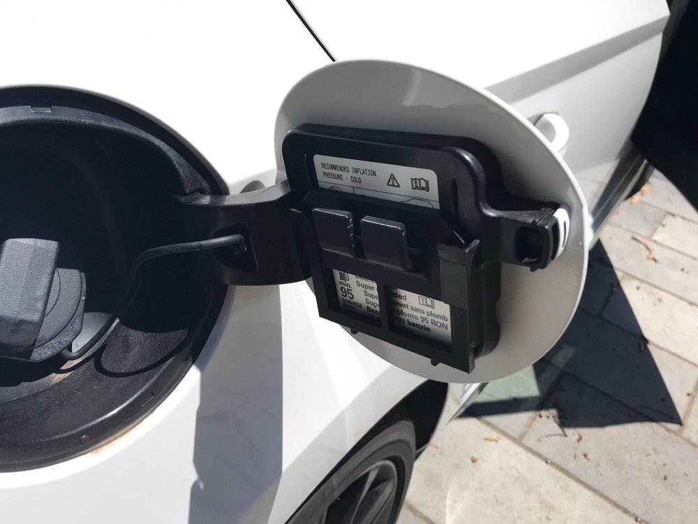

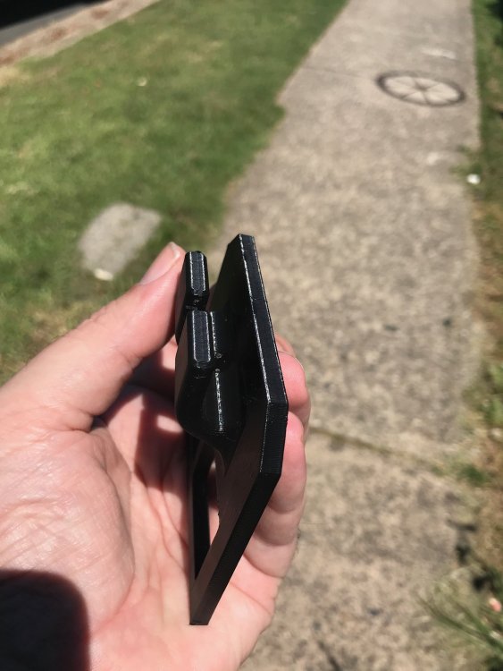

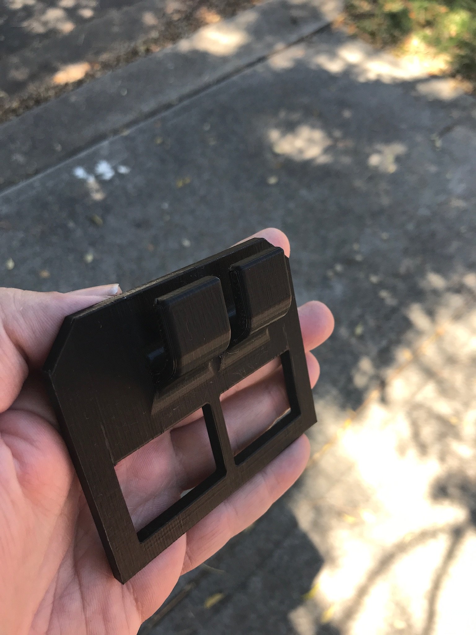

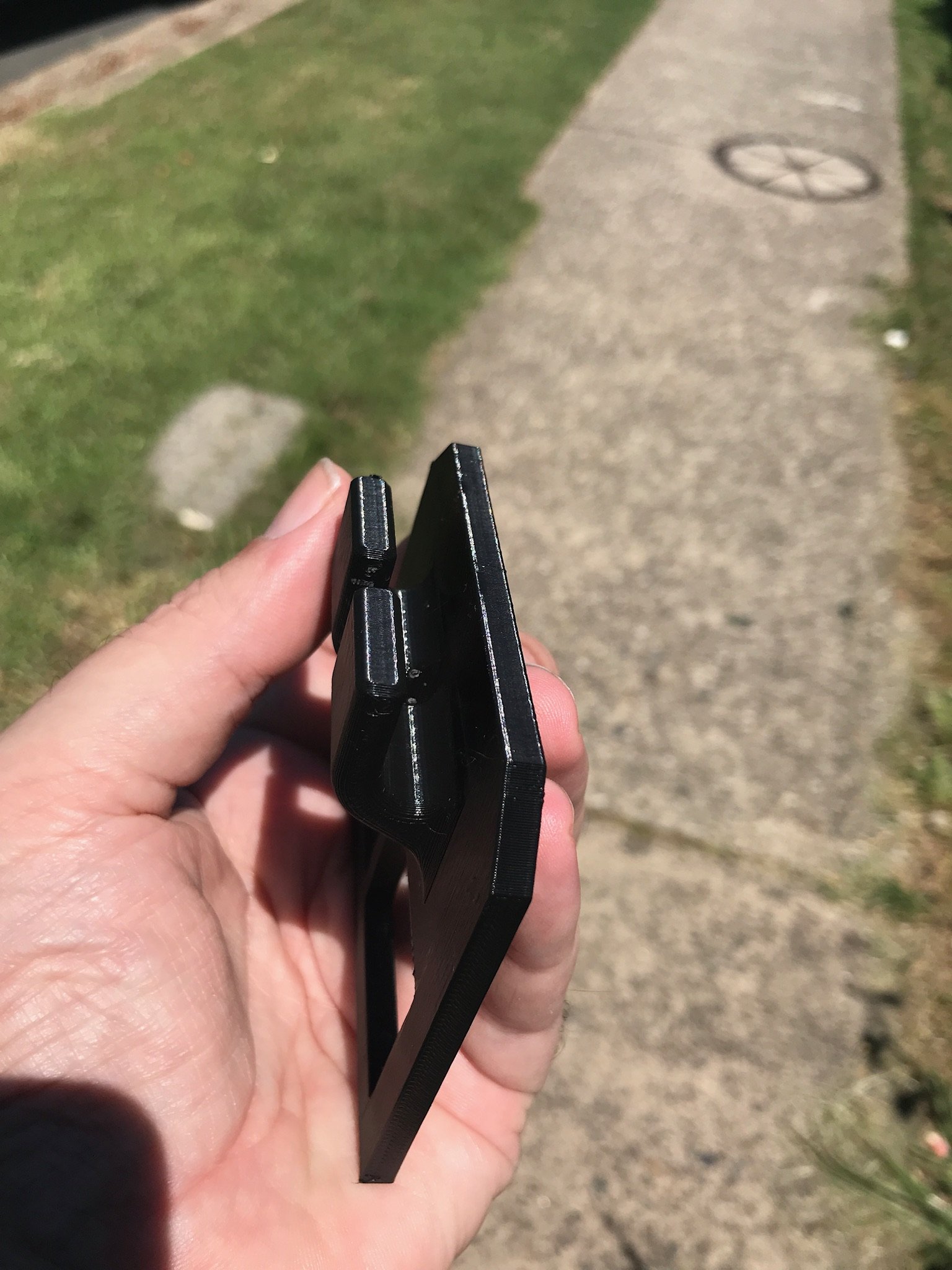

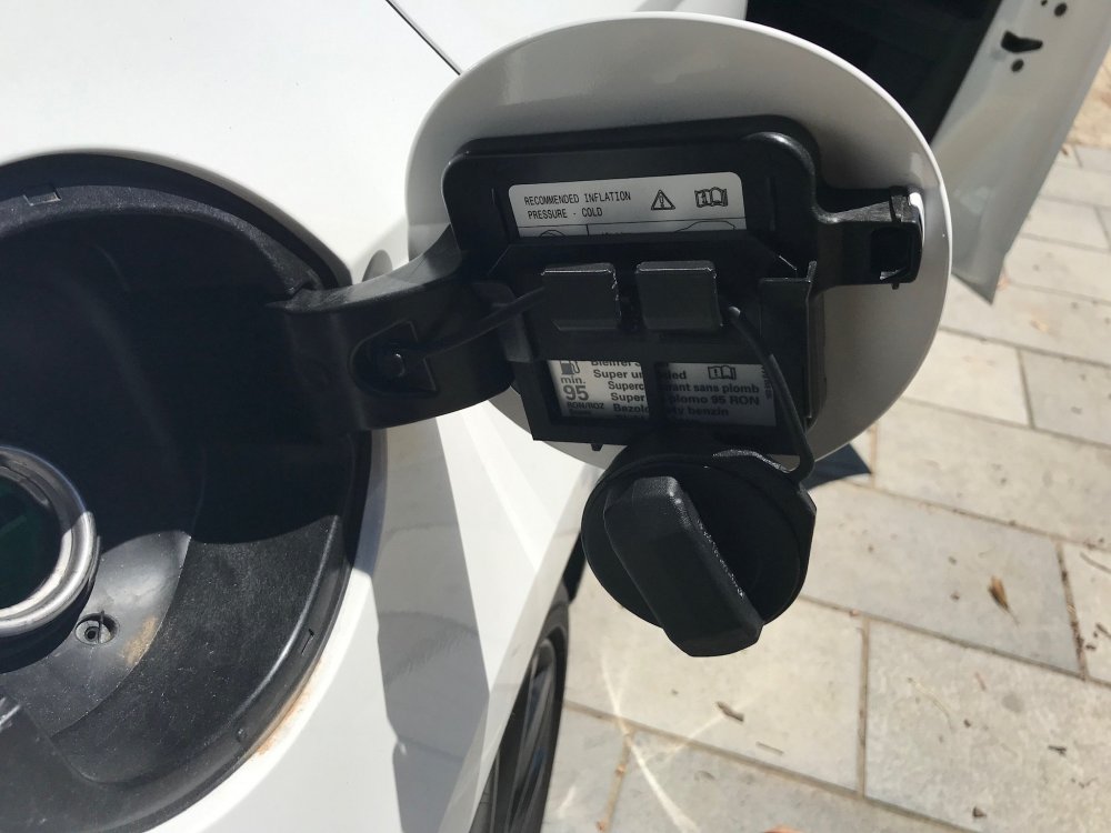

Wanted to show the fuel cap holder that I 3D printed this weekend.
It fits In the slot in the fuel door where the ice scraper goes.
Australian spec cars do not come with the scraper, as most of our climate wouldn’t need it.
I would be happy to print them for any Australian members who might want one and don’t have access to a 3D printer.
Just cover costs and postage. Around $2 in material. Postage would vary by location obviously.
Heres a link to to the file for anyone with a 3D printer that might want one.
www.thingiverse.com/thing:3208302   (This is my own remix of the original file)
the original one wasn’t quite to my liking. So I took the file and modified it.
printed the first one in PLA at 60% infill and .2 layer height.
Might have to print in PETG depending on how it goes in the Australian summer.
The holder fits the Rapid also. Don’t know what other cars it might fit.
Have only tested on the 2018 Fabia and Rapid.

Same here,  but it really doesn’t work very well. The cap will fall of if you even look at it wrong.
With this printed part, that’s no longer an issue.
