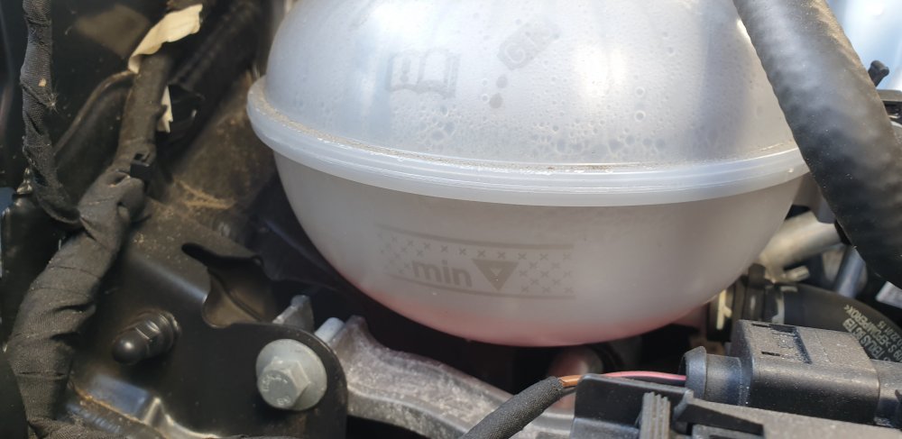

I found this low level recently but no warning, its below min, is that right?
Yes, below min level. Top it up
Yes but no sensor warning, that's not right
Before topping up, I'd suction out some more coolant in order to check if the sensor works at all.
In fact, on my old Octavia, MIN level doesn't trigger the sensor yet.

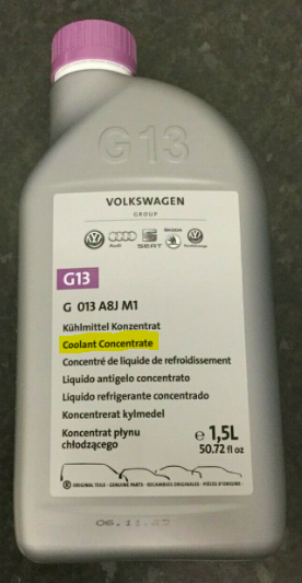

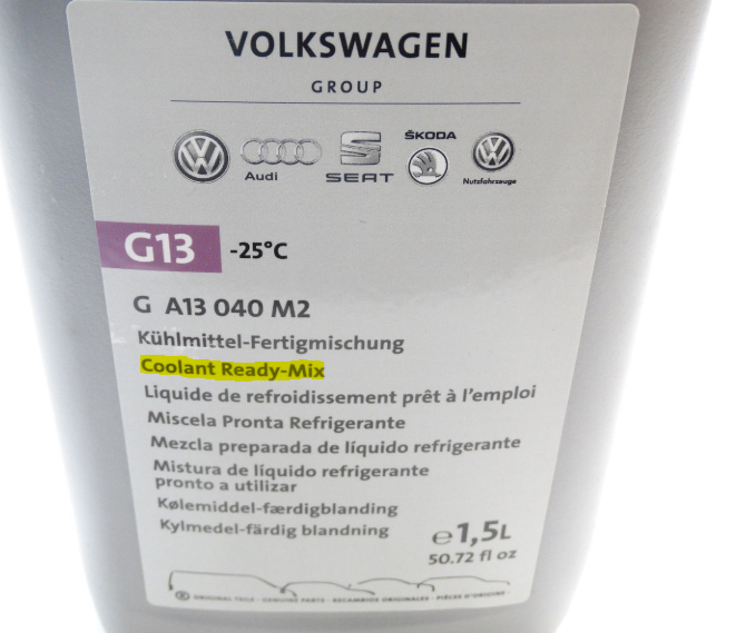

Having read these comments, I have bought some G13 off EBay for just under £10 delivered. I notice on the instructions that I should use distilled water. Went ever I have topped up the rad on previous cars (non VAG group) I have always used tap water. How important is it use distilled water?
Did you buy genuine G13? If so then there are two types, one where you need to add water (concentrate)...
The other which is pre-mixed (ready mixed) which you can pour straight into the header tank from the bottle...
If you're just topping up the header bottle from anywhere between minimum and maximum, then using undiluted concentrate will be fine.
could do that yes but i would expect an error on the dashboard or my OBD11 app would have picked it up
got one today mixed version, cheapest so far: https://www.ebay.co.uk/itm/Genuine-VW-Audi-Seat-Skoda-ready-mixed-G13-Coolant-1-5-Litres/152234335270?ssPageName=STRK%3AMEBIDX%3AIT&var=451424724313&_trksid=p2057872.m2749.l264

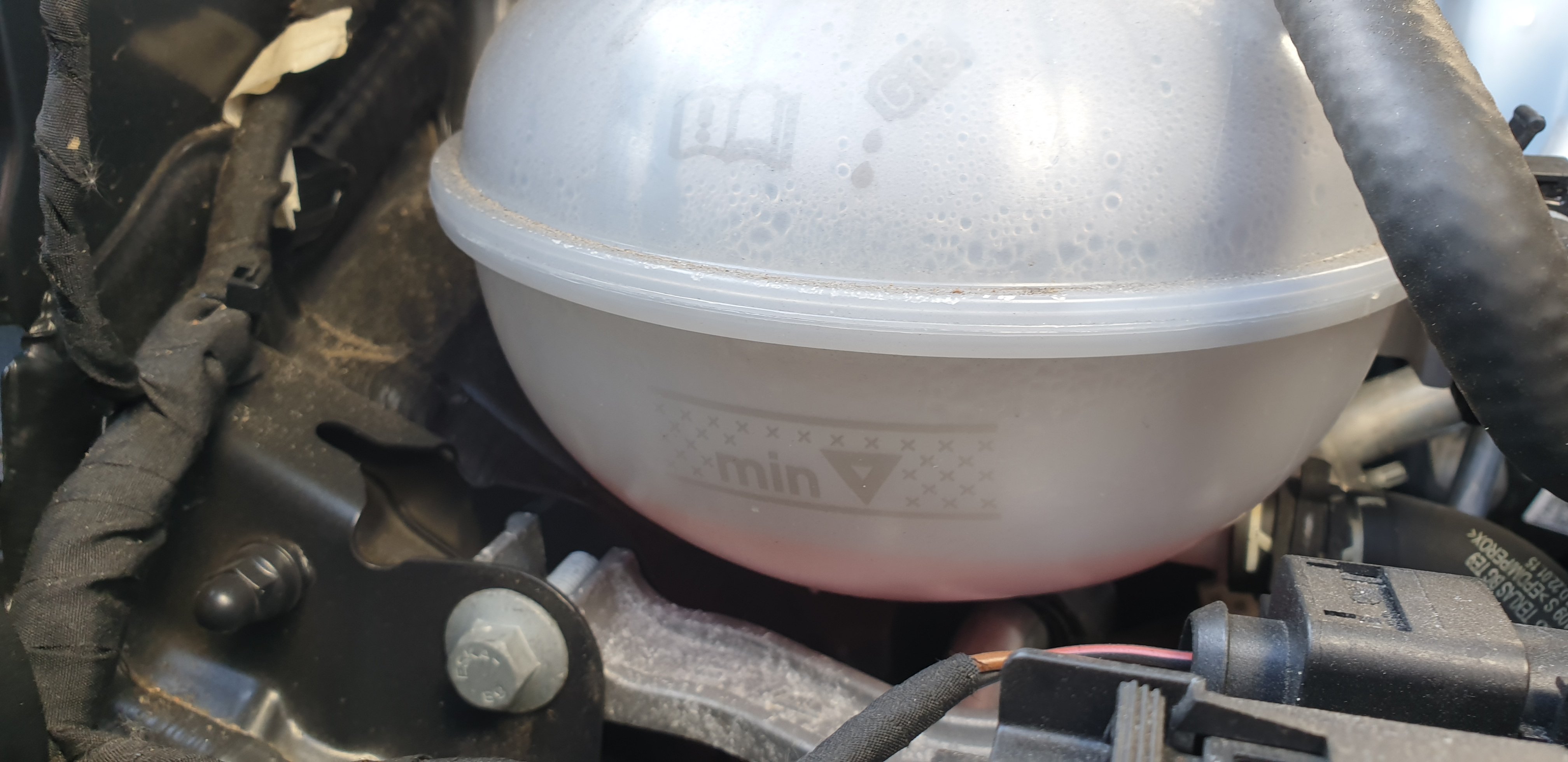

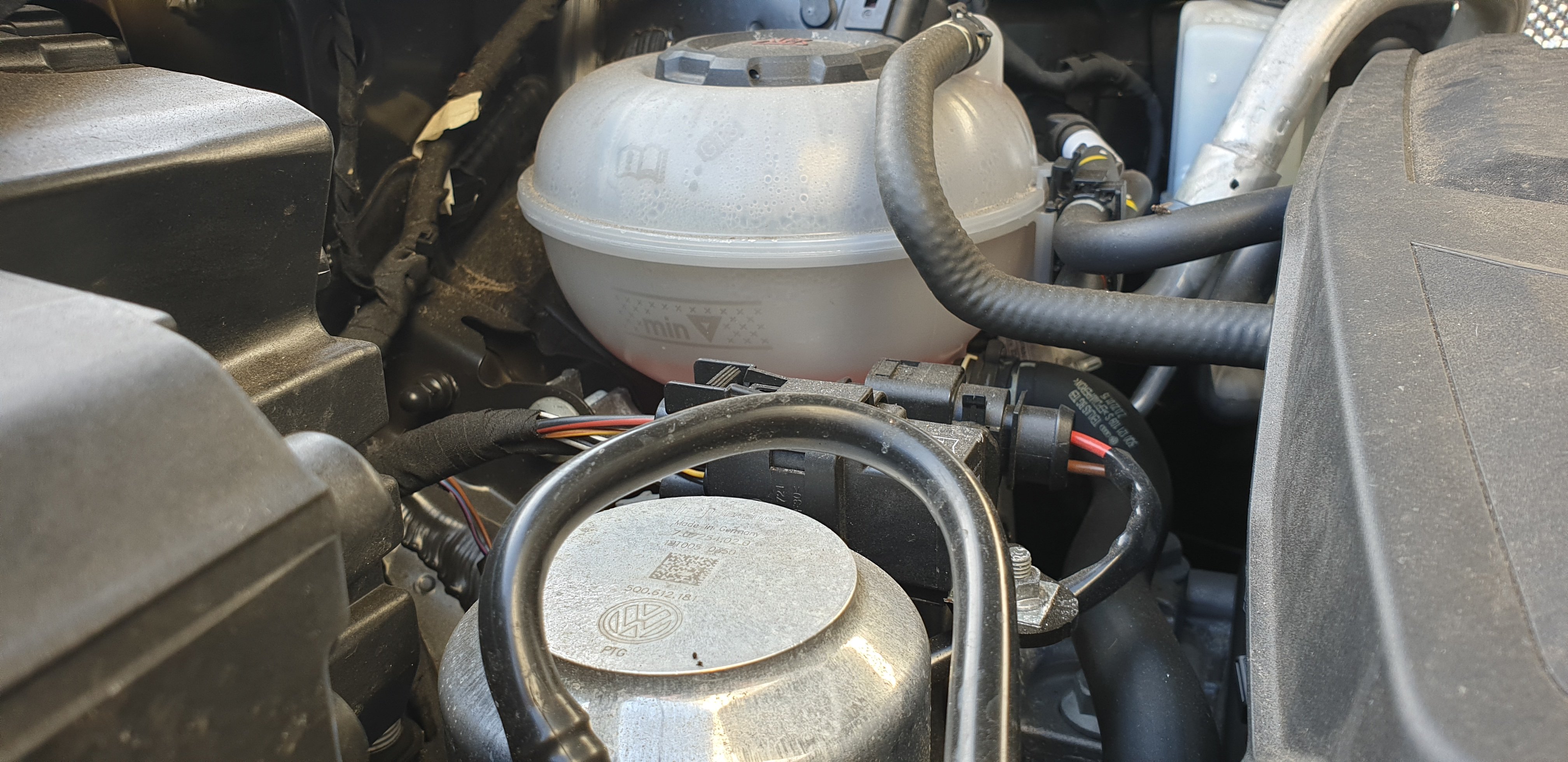

I was inspecting for some resonance noise under the bonnet and noticed that coolant reservoir have a little play when you try to move it up-down. Althought im not sure that is the reason for that noise just wondering is that normal? 2.0 tdi engine.
