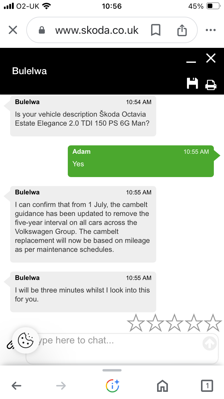

Just spoke to a Skoda chat person who stated the time part of the intervals has been lifted across VAG group as of July and my 2.0l diesel mk3 is due at 140000 miles.
That message you received is really useful info. thanks!!
It's only been info passed on by users up to now.

Was the long time ago that you posted what Skoda Confirmed before June last year when this came out from Skoda / VW concerning the likes of your engine in the UK.

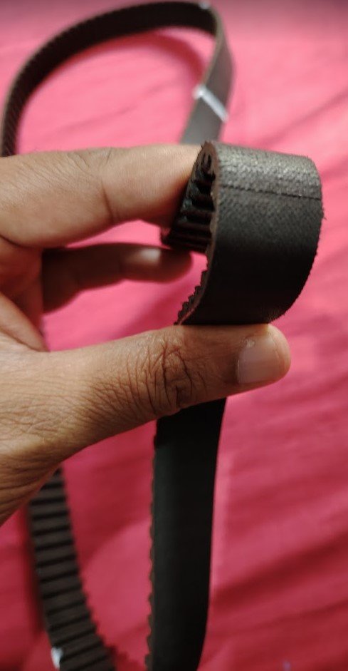

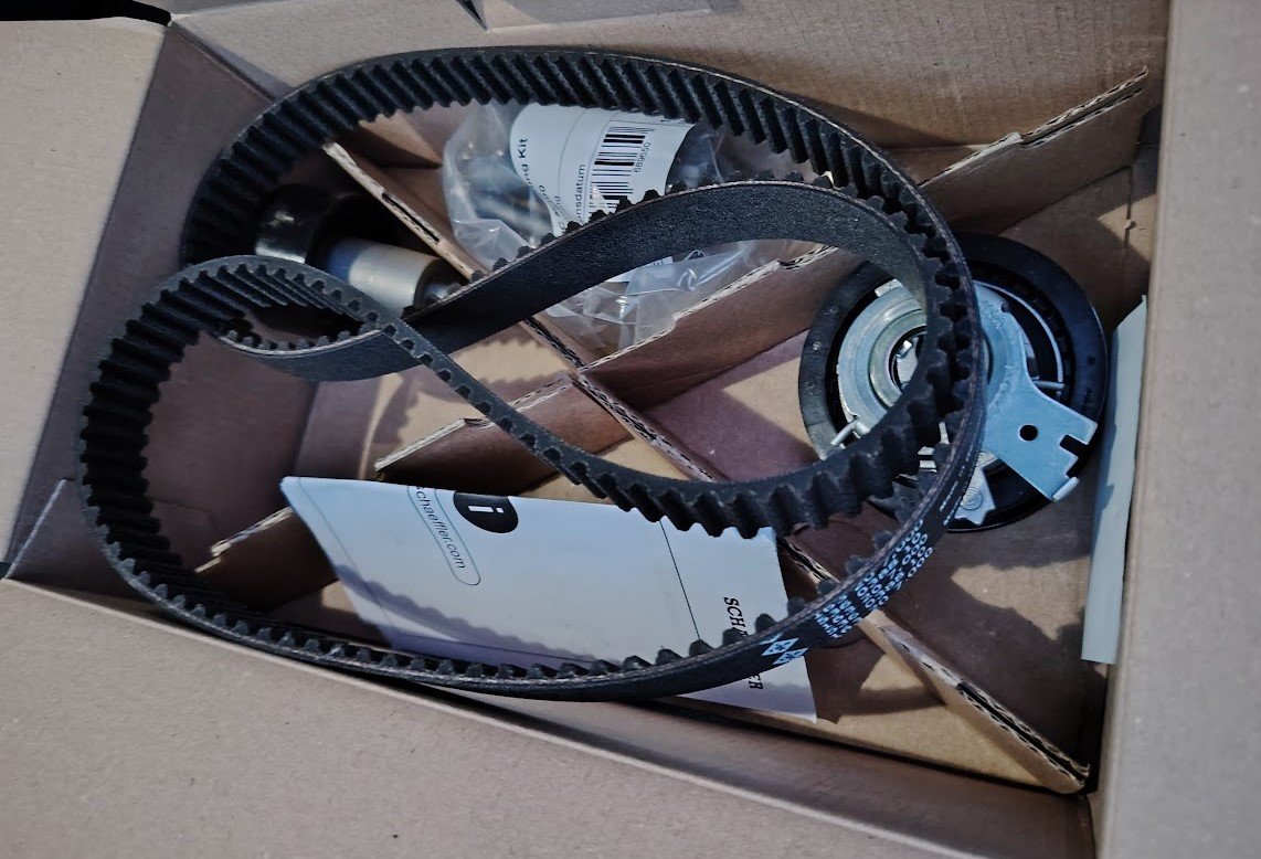

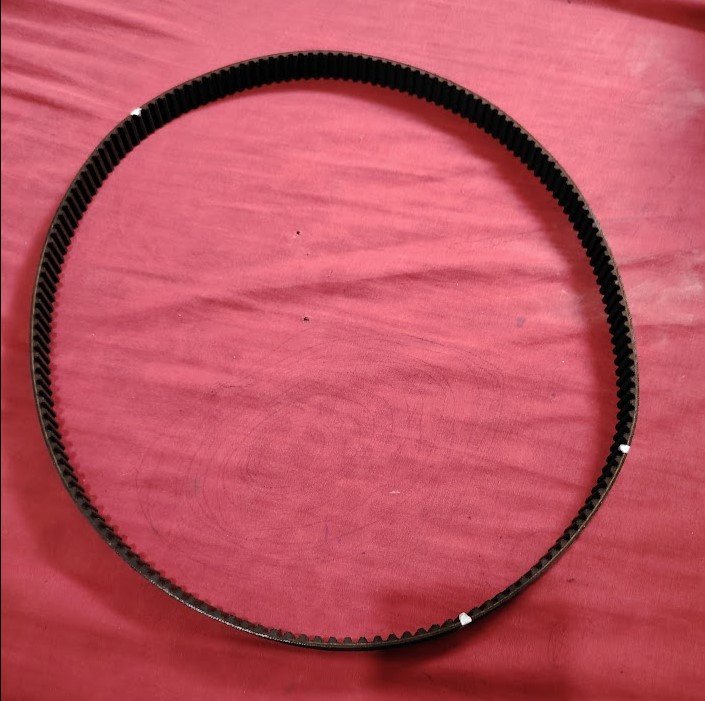

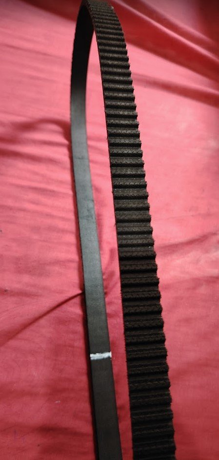

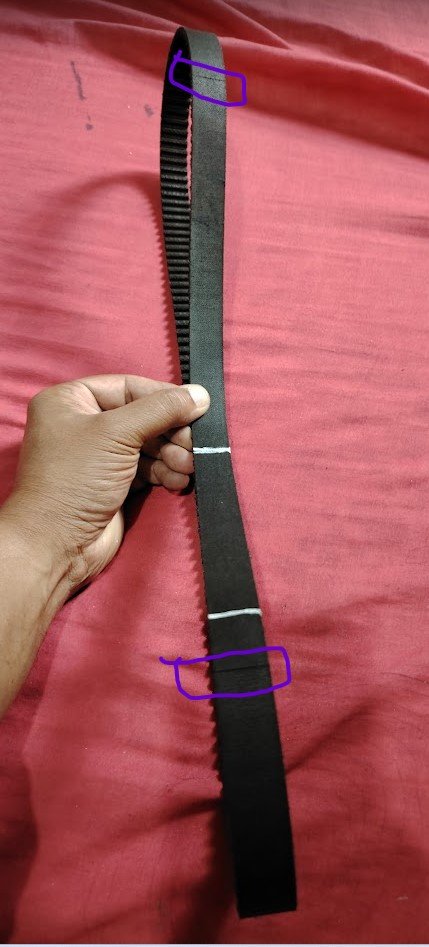

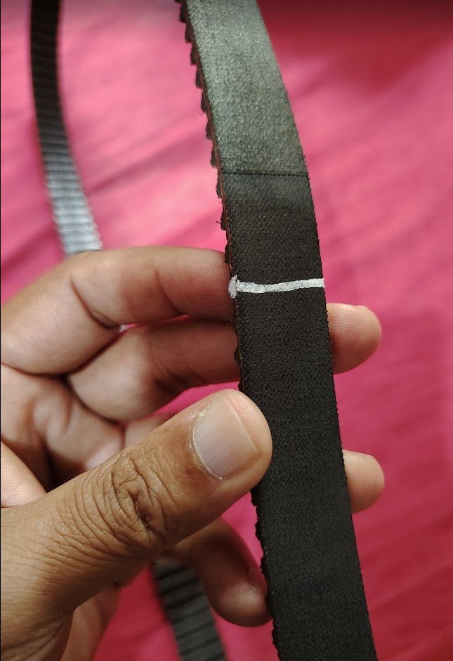

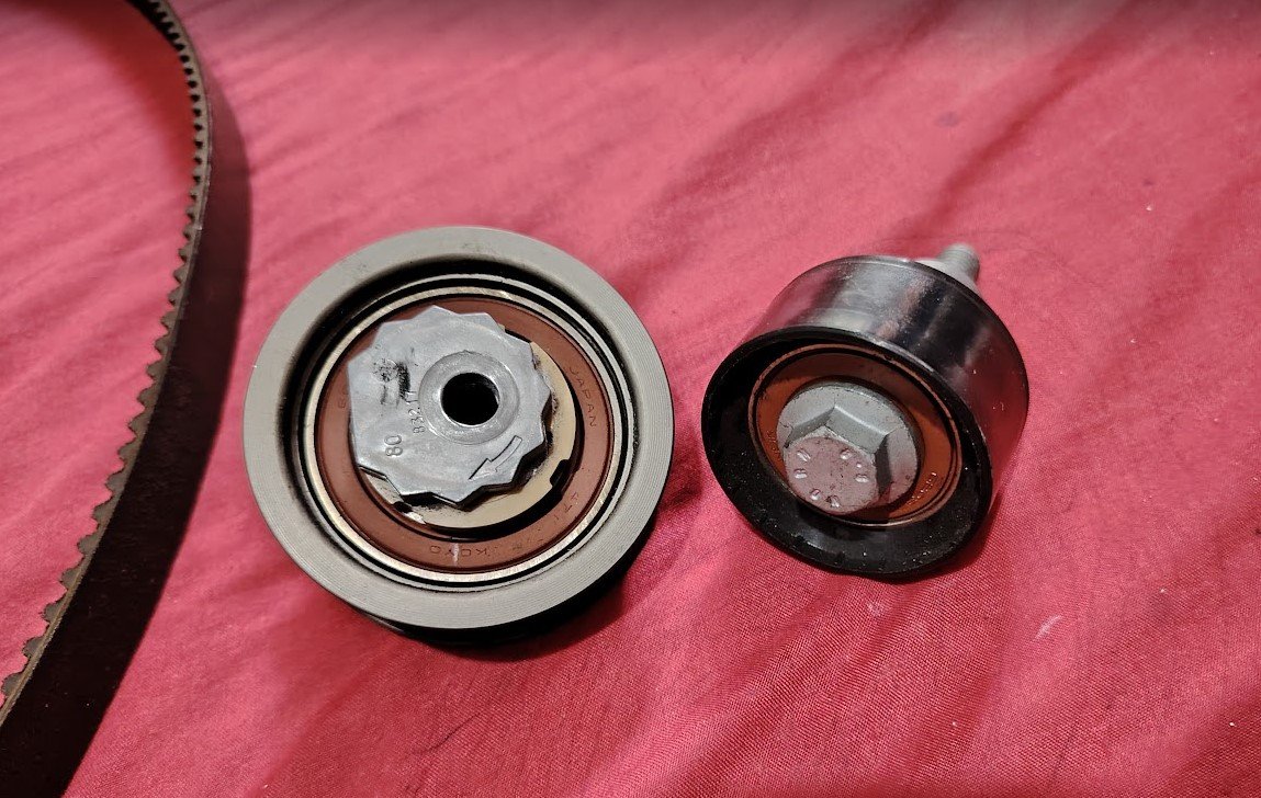

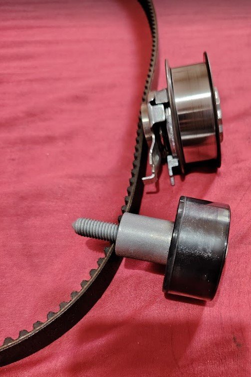

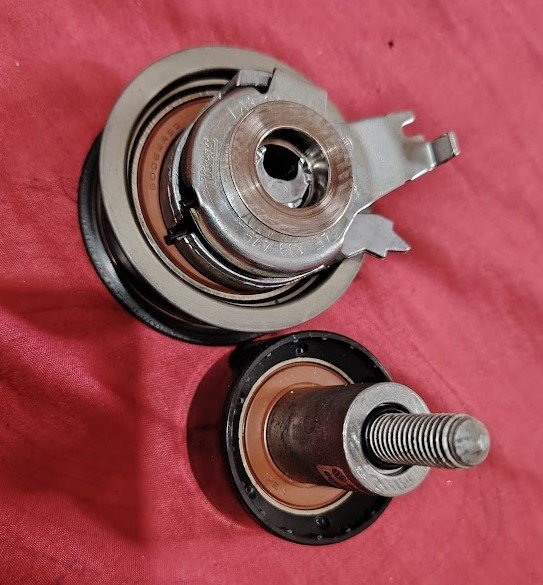

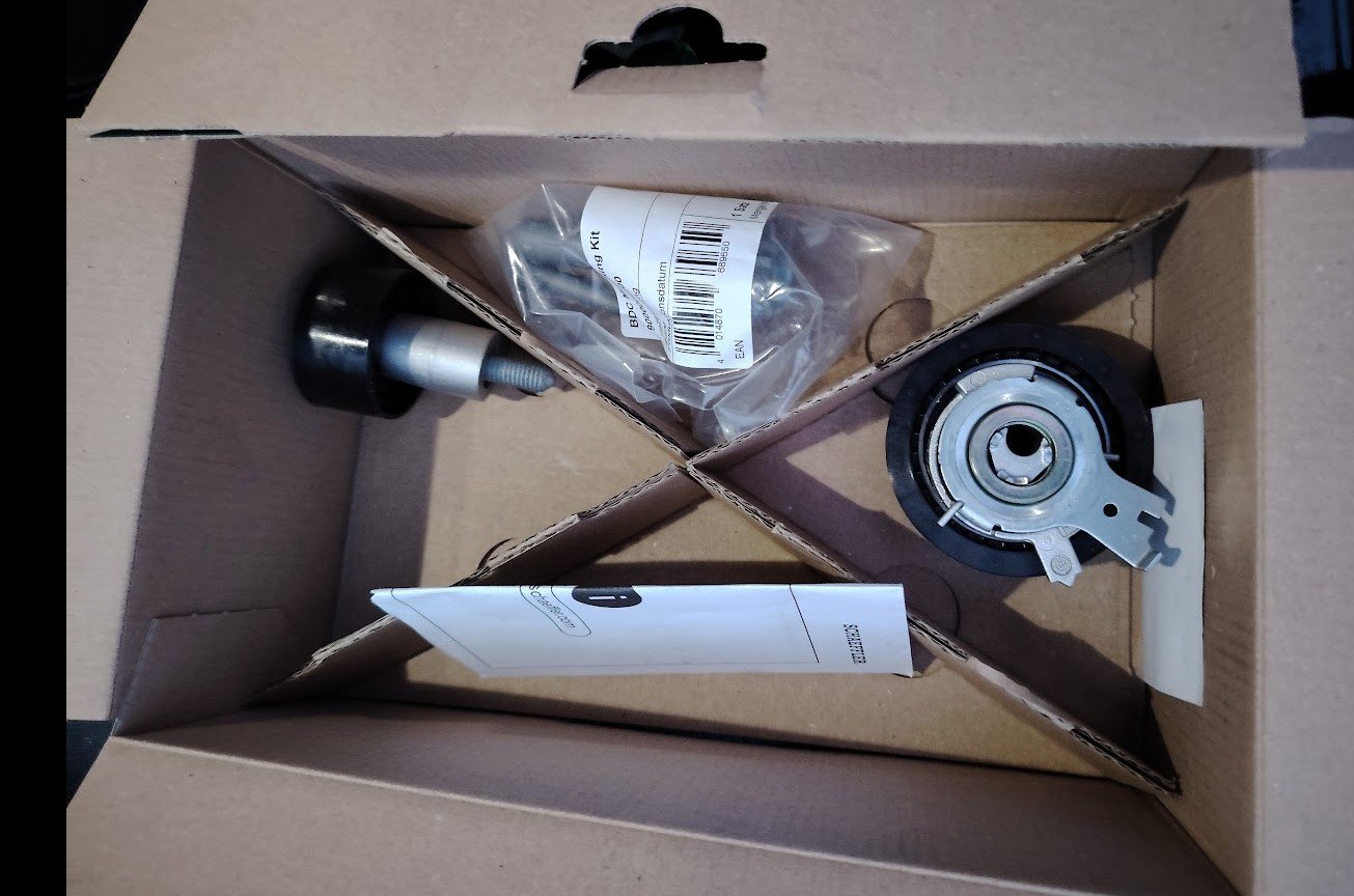

Update:
I had my Timing Belt Kit replaced with INA SCHAEFFLER (£69.29) last night. Mechanic says that it was a good decision to replace as the old belt wasn't in t great shape. I have uploaded some pictures of new kit and old kit in case someone is curious to see.
N.B: Mechanic will replace my drive belt/serpentine belt for free. I have already ordered drive belt in my local Skoda delaer..price is around £31.
Car details of chanhing driving belt
First Registration: 24 October 2017
Mileage: 131863 miles

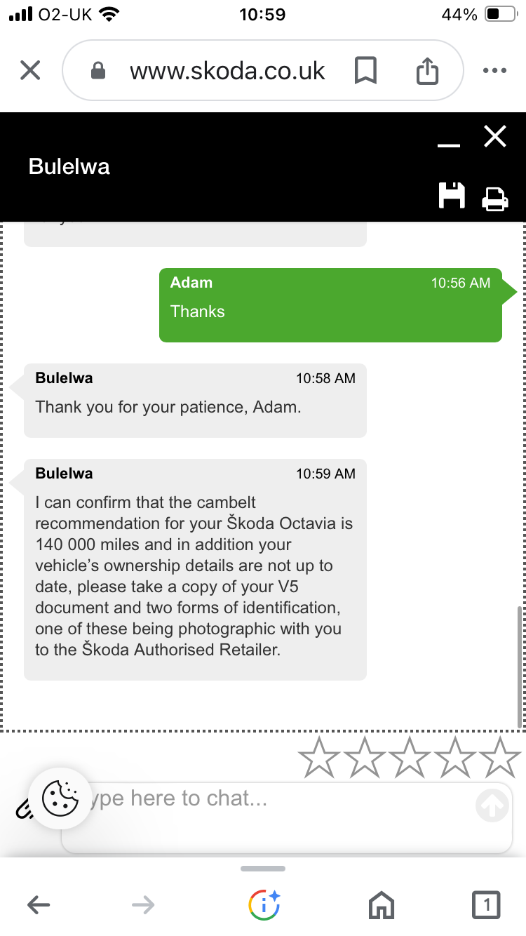

I enquired about my 16 plate vrs tdi cam belt change with Skoda in Stockport who informed me that it was a 15 year or 140000 mile interval . The cost was £1200 and they wanted two days to complete the work . This was as of the beginning of June 2025.
I understand this is an old thread but in case anyone was searching.
Adam F
