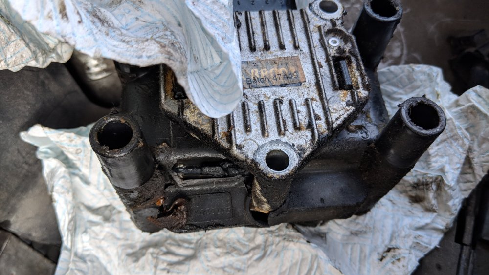

Good call re coil pack - these do fail after a few years but it's cheap and easy to change. When starting to fail and cold/damp they keep dropping to two cylinders as the units have two coils each feed two cylinders - hence the term wasted spark (hence misfire/pulling power). I had one fail on my old Octavia a few weeks ago (same coil pack)

My coil pack (which I think is the same as the EA111 8v) failed with a big hole in the side (see holes bottom left of the photo:-

Btw coils usually fail internally, and look fine externally, they don't all look like BigJohn's

Indeed the previous one looked fine when it failed. I'm on my third now on the Octavia.
